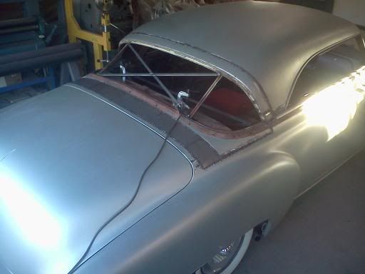

    Are you talking about triming the gl*** ? Im sure that gl*** is tempered if so it cant be done. better to make the adjustment now before paint
    and those are tuff windows to install too especially if your going to run the stainless and the re-pop back windows fit like **** , FYI

    thanks buddy.. yeah the rear gl*** is tempered, so gotta get the ****py re-pops!.. my front isnt though.. and the rear needs very little to get it to fit in.. the rear section didnt change shape too much.. just moved forward a bit.. but i hear ya.. might not be the easiest to do.. but we will make it happen!
    hahaha that made me laugh! you know you like em big!:D
    exactly... just laying the corner piece in now.. it aaaalmost wants to go back in as is! so with just a little bit of lovin', we should be able to make it work!

    Paul has had my car up there for a bit now. H e was cutting the new 1 piece windshield down and it crack. F@CKING!!!! C all him 1st and have him order the gl*** your gonna use. He said that the newer gl*** has been a pain a few time. The out portion of the gl*** is harder now, so gave him a hard time. The other reason its been up there longer is cause he travels a lot for work. Going to different shops all over the country to work with gl***.

    thanks! yes the original gl*** is.. but im getting re-pop gl*** which is laminated..

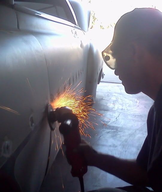

    Update: Today Bob and I worked on redoing the ****py previous owners hole filling technique! don't ask! hahaha! So we drilled out, used metal plugs, welded up, and grinded down... Fun stuff!
