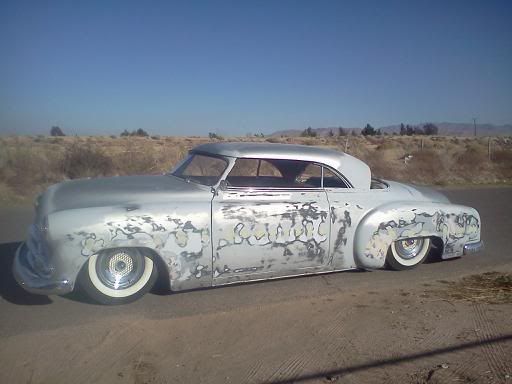

    I know a lot of you have been waiting for paint pics....so I decided to start a new thread for the body and paint stage of my car. Here's the link to my Chop thread for those of you that missed it. http://www.jalopyjournal.com/forum/showthread.php?t=627163
    So Ive been trying to decide whether i was going to send my car out for body and paint.. or do it myself. Ive done several paint jobs.. but nothing on this level. I thought about it long and hard and figured there's really only one way to learn..and that's to do it myself.
    Another reason is Ive done all of the work myself so far with the exception of the chop, i just helped a little on that.. basically was there to watch and learn.. my buddy "demonacm50" helped me out alot also.. and of co**** tons of questions answered here on the HAMB by "Rusk" and "chopt49" on my 4-link.. but the motor swap and install, electrical, drive shaft tunnel, rear end, brakes, rear 4-link suspension, air ride, gas tank, trunk floor, C-notch, body work etc was pretty much all done in my driveway.. so id really like the satisfaction of saying..It was built by me and not dropped off at a shop.
    I know its not going to be a 100% flawless paint job and i actually don't want it to be.. I drive the **** out of my car.. and where i live in the desert.. i go down lots of dirt roads visiting family and friends.. i even drive it to work quite a bit which is a 60 mile round trip on the freeway... so i just want it to be a nice driver.. and if i get a ding or rock chip on it.. i wont curl up and die over it!
    So when you see it at a show.. cut me some slack ok! This is my first "nice" paint job.. and keep in mind it was done in the driveway and my garage, fighting wind, rain, snow, dust, bugs, dogs, tumbleweeds, nosey neighbors, you name it! Now i know there's going to be a "oh, there's a little spot here that he missed" or a " oh, what happened here?" or "he should've done this or that" but you know what.. im ok with it!

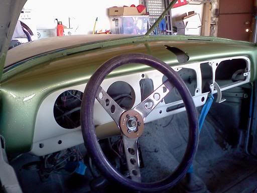

    Here's a few of the body work and blocking stage.. sorry for the ****py cell phone pics..
    First thing I did was I finally retired my trusty old Binks gun for a couple of Devilbiss gravity feed guns.. Now i ALMOST look like a professional!

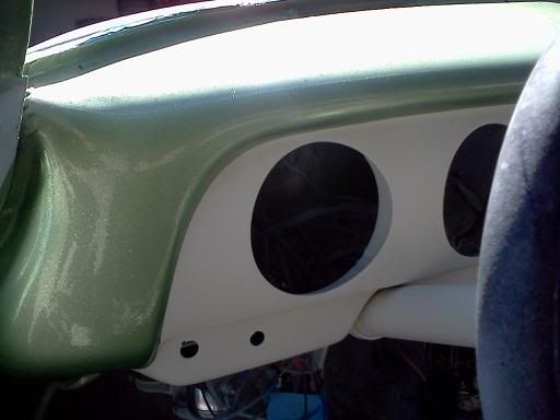

    I wanted to start with my dash first.. then move to the roof and finish that. If im happy with the results, I'll feel comfortable to go ahead and spray the body.
    Im doing a metallic base coat clear coat.. The roof and dash are getting flaked, and im two toning my dash a cream white color with the Metallic Kiwi green.
    Welded in the hole in the dash where the original shifter went..
    Here we go... spraying the basecoat..
    Sprayed the flake...
    Few coats of clear...
    I sprayed the lower half a Vintage White a few weeks ago..

    The flake doesnt show well in pics.. but it looks great!
    Still need a few more coats of clear over the whole dash to bury the flake .. The white has not been cleared yet either...

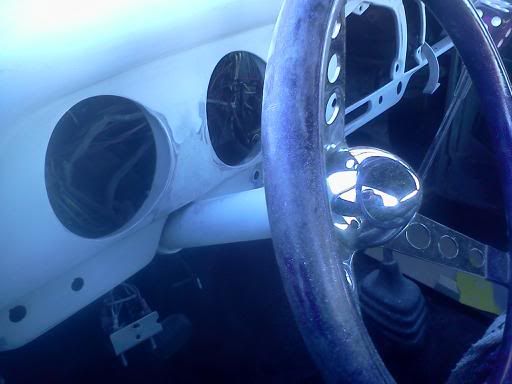

    cleared the Vintage White today...
    my ****py camera doesn't show the color and flake very well.. but its bright and flakey!

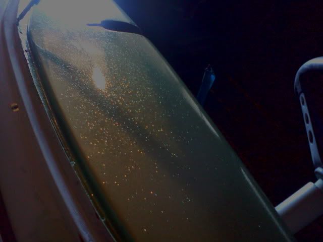

    alright... i dumped more flake on the dash tonight.. I guess it wasn't enough for me!
