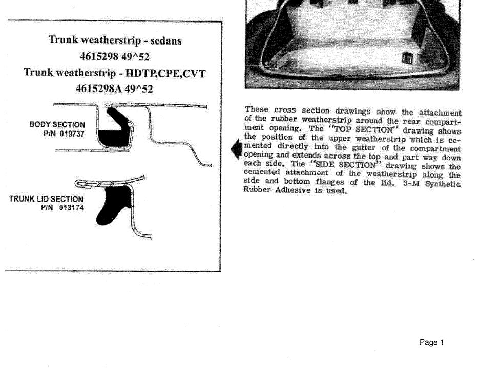

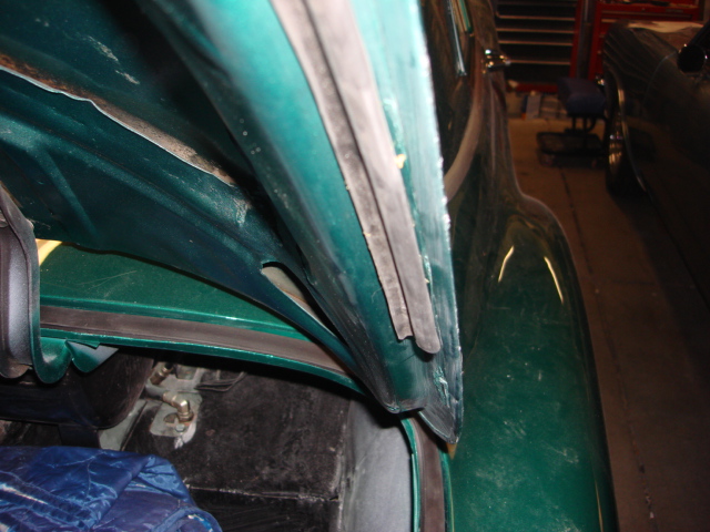

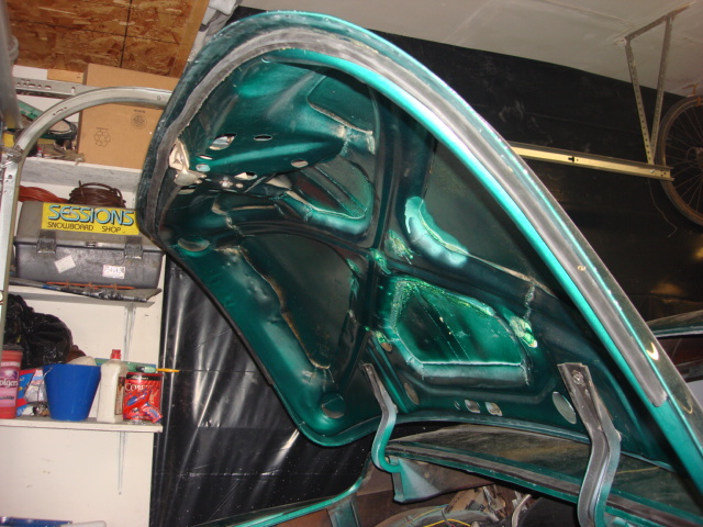

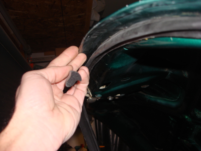

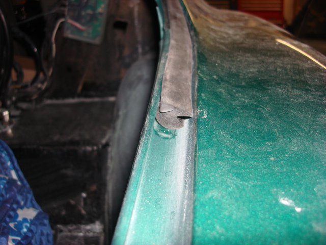

  15. We're all waiting Mr. Knocker. I got the back part on that goes in the jamb under the rear window but Like BadLuck said the piece that goes on the trunk lid just not fitting right.
  16. Thommyknocker
    Joined: Dec 15, 2006
    Posts: 1,244
    Thommyknocker
    from Colorado
    Mr. Knocker.....pfffft :p You guys are FUNNY
    In case you didn't get instructions, I scanned mine for ya, and here are a few pictures.
    Your using a good weatherstrip contact cement right?
    wipe it on both the body and the rubber, then stick 'em together. I worked about 18 - 24" at a time.
    I did the piece that goes on the body first. Then I marked the trunk with a piece of tape where it ends on both sides.
    They don't overlap.
    I actually did the trunk one twice (if your carefull, you can pull it off and redo it)
    My first try was at 45 deg, but the trunk wouldn't close :rolleyes: so I flattened it off (more parallel with the lip) the second time.
    Oh, and it will be tight. but a few days closed and it will squish down and be easier to close
    hope this helps.
