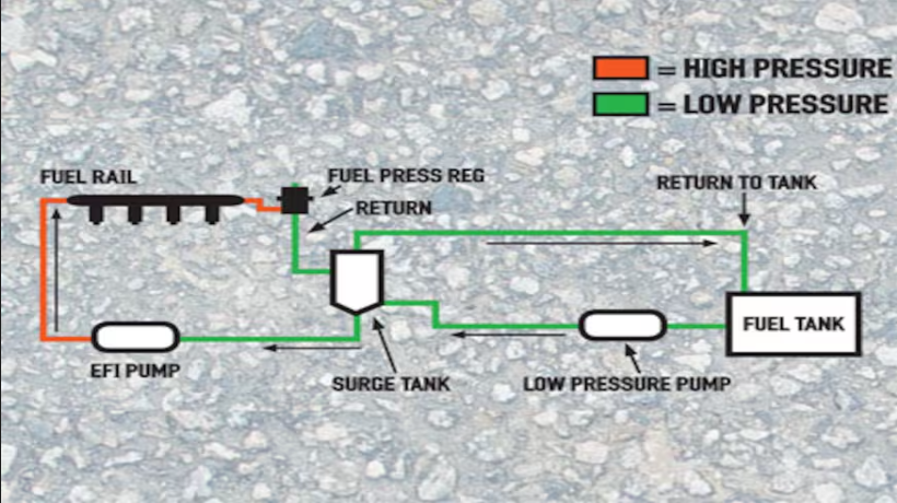

    We don't even use baffles on Road Racing Cars.
    A 2nd electric fuel pump and a surge tank with a return is better.
    For a road driven vehicle I wouldn't bother at all.

    Foam filled fuel cells is not there to prevent surge, it is there to prevent vaporising of the fuel [there will be a tiny secondary surge benefit]
    And there are plenty of Road Race cars with standard fuel tanks [spec cl***es eg: BMW E30 series , and 2K Cup in NZ]
    Fuel starvation is the issue NOT fuel surge
    This is true, it doesn't matter whether it is solid or liquid , because m*** is m*** [there will always be weight transfer with acceleration forces]
    In fact it would be more beneficial to lower the height of the fuel tank.
    The best method to prevent fuel starvation is a "surge tank" [basically a dry sump system for fuel]
    This requires a 2nd pump as a scavenge pump to fill a tall/slim surge tank
    On my Vintage Road Race Corvette "Surge tanks" were not a period correct modification. [But electric pumps were]
    So we used a tall Fleetguard fuel filter and added a tank return line to the top of the Adaptor [this was fed by an electric pump] THEN a mechanical fuel pump would draw from the bottom of the filter
    [these things were 11.5" tall]
