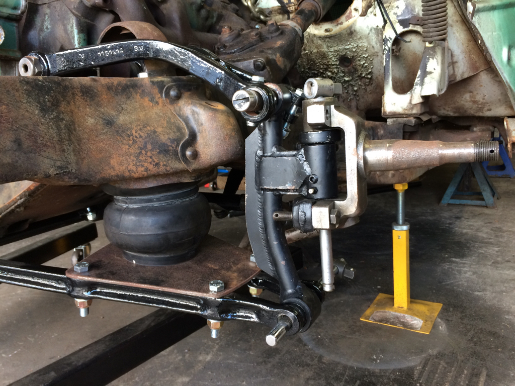

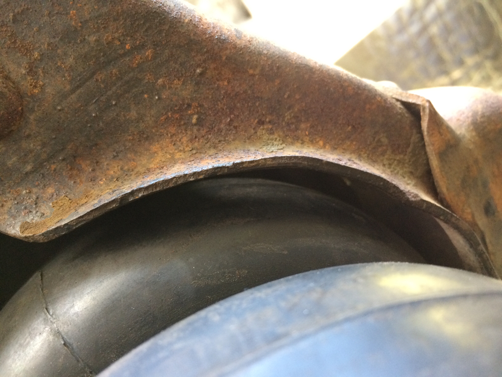

    You might need to trim the opening a bit more, some bags will get fatter when aired up an weight on them. Don't want rubbing.

    Haven't had the chance to get a decent look at the openings however will research further into it tonight. I know it looks like its gonna be a snug fit though!! Thanks for the advice Fullblast will keep u posted!! Got my top bag plates to suit Slam RE-6's yesterday so after few measurements tonight it's welding time!!

    Plates from Air ride tig welded in place (only just started to tig!!) & top ch***is plate & spacer tube bolted in. Bags fit snug inside their little spot with clearance all way round however undecided whether to trim ch***is opening or not.

    As you can see in pic the front RE6 slam bag fits with minimal clearance. Outta time now but soon to be trimmed for more clearance!

    She's in!! Bag has no clearance issues fully aired up or aired out!! Progress is good!!

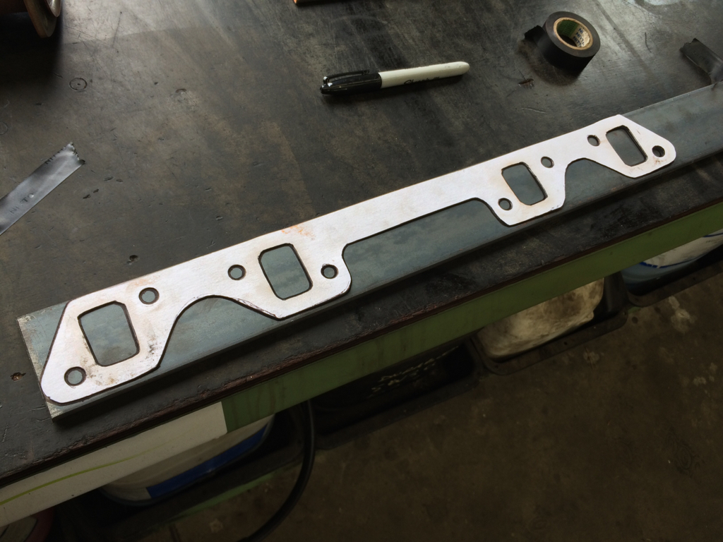

    Handmade exhaust header plates. File, sand, repeat. Gonna look good when done!!

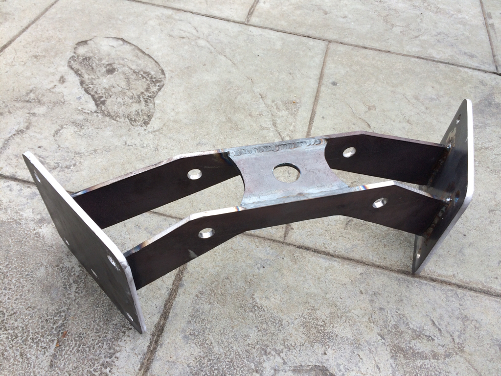

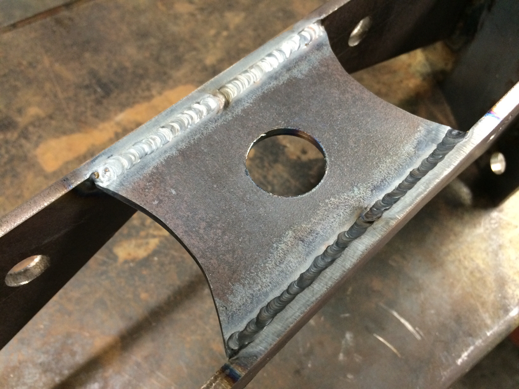

    Finally found the time to design, fab & tig weld a new X member for the T700 Trans. Only just started tig welding late last year so still trying to perfect the art!! Had to make the X member with a hard kick up so it wouldn't hang below the ch***is. Made it from 5mm (0.19") steel took few hours with only a grinder, drill & general measuring tools. Had to get it perfect to keep the Trans output shaft at 3 degrees in conjunction with the perfectly set up ch***is (0 degrees). More to come.....

    Exhaust header plates turning out heaps better using (believe it or not) a cylinder head tungsten tipped porting tool. Look at the finish!! Will eventually be proper port matched to the 401 nailhead later on down the track....

    Just a thought, next time, when making something thick like header flanges with a rectangle hole. Instead of drilling one big hole and then grinding out to shape, drill each corner with a smaller bit, and then connect the dots with straight cuts. That will save you some time with grinding and filing.
