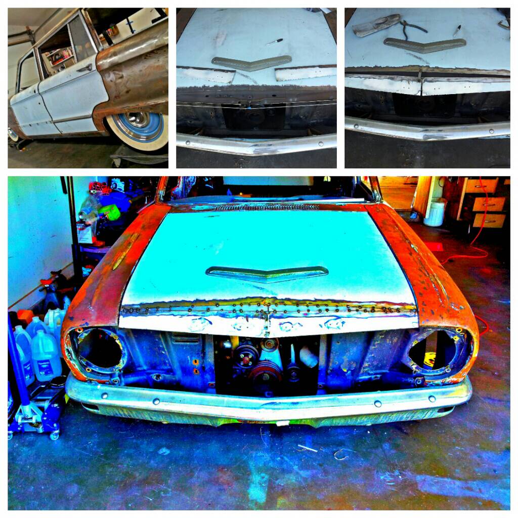

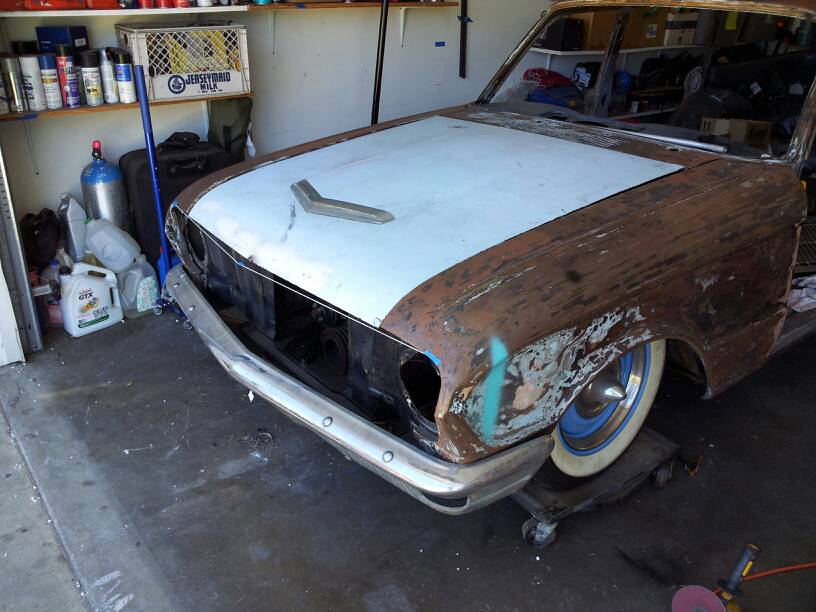

    I mounted the 1963 comet bumper and am experimenting with extending the hood and fenders to match the peak.

  25. falconizer_62
    Joined: Mar 2, 2007
    Posts: 637
    falconizer_62
    Ok. Had a day to work. I lengthened the fenders to match the bumper\hood. Just finished it enough to get the line.
