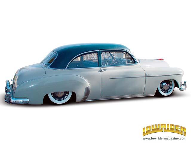

  15. Hotrob
    Joined: Mar 23, 2005
    Posts: 589
    Hotrob
    from DFW, TX
    Go to the www.lowridermagazine.com site, they did a 51 with airbags up front. Was a very straight forward proceedure and turned out well. Look in the tech section, its not to far down. Also ask Gambino Customs. He has bagged a bunch of these. You can get em down there especially if you also use dropped uprights. Buffalo enterprises in washington state will modify your uprights for a reasonable fee, and they are better than an aftermarket piece like fatman because there is no grease fitting interference.
    Hotrob

  23. Hotrob
    Posts: 589
    Hotrob
    from DFW, TX
    It gets plenty low!!
    I was'nt real crazy about the leaf spring method they used for the back. I would have changed to a ladderbar suspension, but it seemed to work.
  24. sinner13
    Joined: Sep 5, 2006
    Posts: 430
    sinner13
    from Buffalo NY
    Ya...I would say thats plenty low enough for me....
  25. sinner13
    Joined: Sep 5, 2006
    Posts: 430
    sinner13
    from Buffalo NY
    So...am I safe to assume that the car in the lowrider mag did NOT have dropped uprights and all the lowering was accomplished by bags?
    I didn't see a mention of them and If I go the same route, I don't want to spend the money on them if they are not needed.
