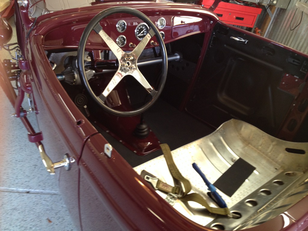

  16. stegman
    Joined: Aug 12, 2008
    Posts: 42
    stegman
    Thx, time to find the heavy side of the drum and balance the whole rotating m*** and jack it up and see how out of round they really are. Thinking 5.50 would ride better anyway, so not to scared to cut on em, but thx again. ImageUploadedByH.A.M.B.1395635376.510739.jpg

  24. stegman
    Posts: 42
    stegman
    Thx again, does anybody know of a tire shaver in St. Louis. I may call a couple 4x 4 guys. A couple of more pics it's been inside all winter, **** see ya in Austin in two weeks. ImageUploadedByH.A.M.B.1395704808.150798.jpg ImageUploadedByH.A.M.B.1395704832.467481.jpg ImageUploadedByH.A.M.B.1395704856.899643.jpg ImageUploadedByH.A.M.B.1395704886.995596.jpg
  25. rottenleonard
    Joined: Nov 7, 2008
    Posts: 1,993
    rottenleonard
    Man that's a great looking car, what is the color from?
