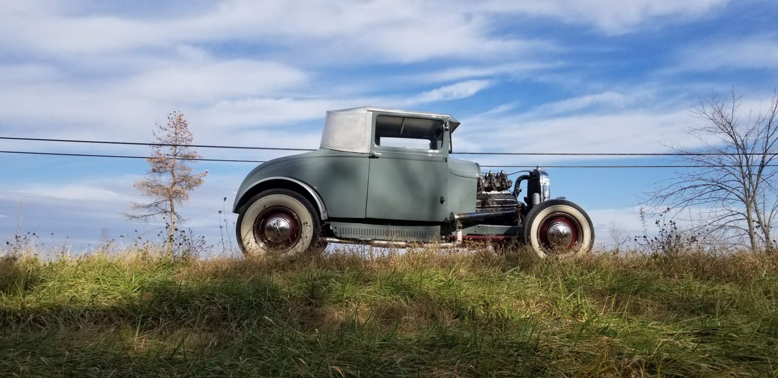

    I used gl*** beads. They did have a chart per Tire size if I recall...do they work?...Yes they do...my tires are tubed Firestone Champion Bias ply...
    I can smoothly get to 60mph without realizing it since those beads went in...that's good and bad I guess...I just watch my speed really...I can run up to
    One of my front tires was deemed near unbalancable so these beads allowed me to run them as there was good tread left...it's been near 5 years for me on them now.
    It's pretty smooth till near 70mph then they get a little shaky...I don't know if adding more beads would smooth that out or not but I don't really drive that fast unless p***ing and yes I will be purchasing new front tires in the near future as the oldies are getting there...
    I believe I have 3.5 ounces in the fronts and 3 in the backs...

    I want to add a note to my gl*** beaded tires...I did leave the lead weights on. They didn't recommend that but I left them figuring they minimize the amount of beads I had to add...
    I had so much hell making these tires work I settled for the notably smoother ride between 0 and 65mph. I felt if I removed the weights I may undo what I gained. Sorry I didn't mention that.
    My beads are the smaller beads in tubes and again I have never had an issue with the original valve inserts leaking. I did order the special inserts but didn't require them...it's been several years now...
    I never block my Hotrod, just park it and start it and drive...no notable flat spots.
    That is likely due to the fact they did many years ago change belt material thankfully. @Moriarity has mentioned this numerous times...
