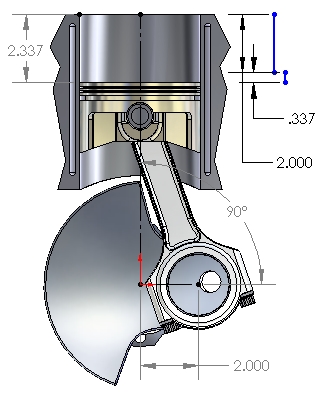

    Scrounged up this good read on Piston Motion.
    Fig 3.
    Note that the conrod is 2" from centerline, indicating a 4" stroke crank.
    It is at 90° from TDC, note the piston height is 2.337" down the bore. Not 2".
    Upper 180° sweep(90°BTDC - 90°ATDC) has the piston traveling 4.672" (58.4%)
    Lower 180° sweep(90°BBDC - 90°ABDC) has the piston traveling 3.328" (41.6%)
    In a flat plane crank, two neighboring pistons traveling in opposite directions will have a significant difference in piston speed.
