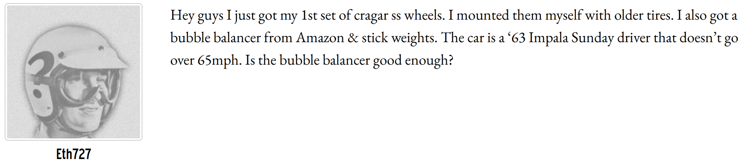

    Hey guys I just got my 1st set of cragar ss wheels. I mounted them myself with older tires. I also got a bubble balancer from Amazon & stick weights. The car is a ‘63 Impala Sunday driver that doesn’t go over 65mph. Is the bubble balancer good enough?
