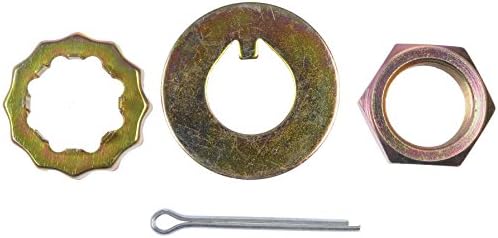

    I like to use these as you're not limited to lining up the holes. The inner nut can be at almost any location yet the outer lock will still line up with the hole. Not a big deal, but I like 'em.
