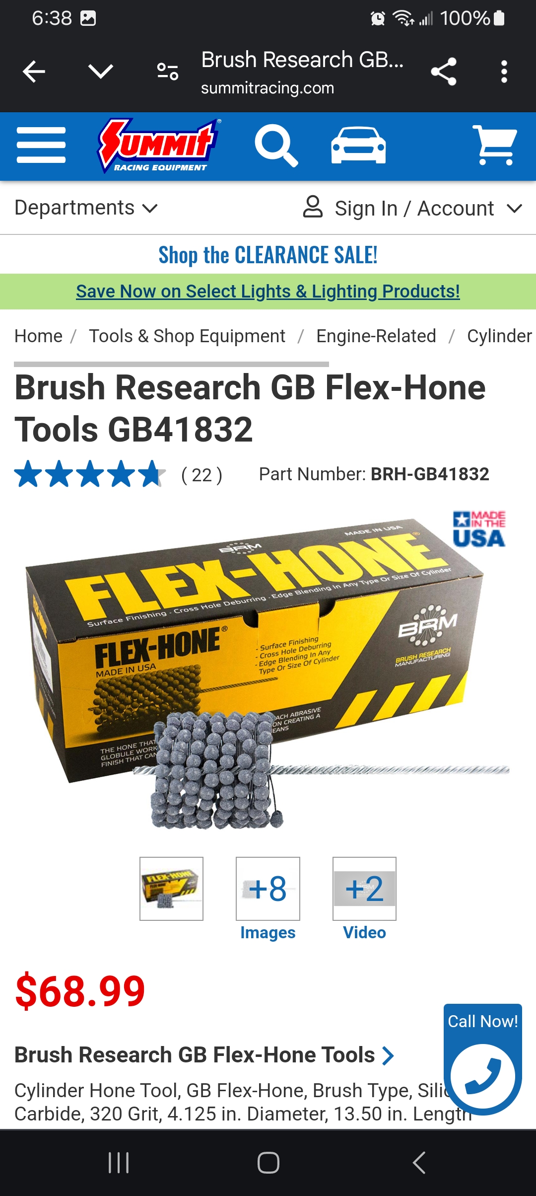

  15. wheeltramp brian
    Joined: Jun 11, 2010
    Posts: 3,351
    wheeltramp brian
    This is what I have ordered. Screenshot_20241023_063841_Chrome.jpg Screenshot_20241023_063853_Chrome.jpg
