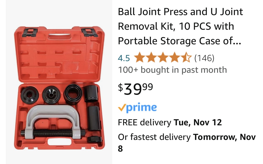

    They look a lot a like. Ever remove wheel studs with a ball joint installer? Thanks

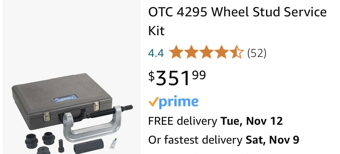

    Hey, $40 for a knock off ball joint installer vs a real wheel stud remover @ $350. $40 is cheaper than bearings these day’s.

    If the ball joint press thingy will fit behind the axle flange and hub, you should be able to use it to remove the studs. But since they're not swedged on Chevys, you can just whack them with a hammer and you won't hurt anything....the kurled connection holding in the studs is not nearly as strong as the bearings or axle shaft.

    Yes a balljoint press works as long as there is room.

    Size for size they appear the same. I’m just referring to the c-clamp like portion of each type of tool.

    Yup. Works fine, I’ve done it.

  27. Like I said if the ball joint tool fits why not? Especially if you want an excuse for another tool.

    Where’s a comparison of the two tools: IMG_3337.jpeg IMG_3339.jpeg
    One brake shoe may need to be removed.
