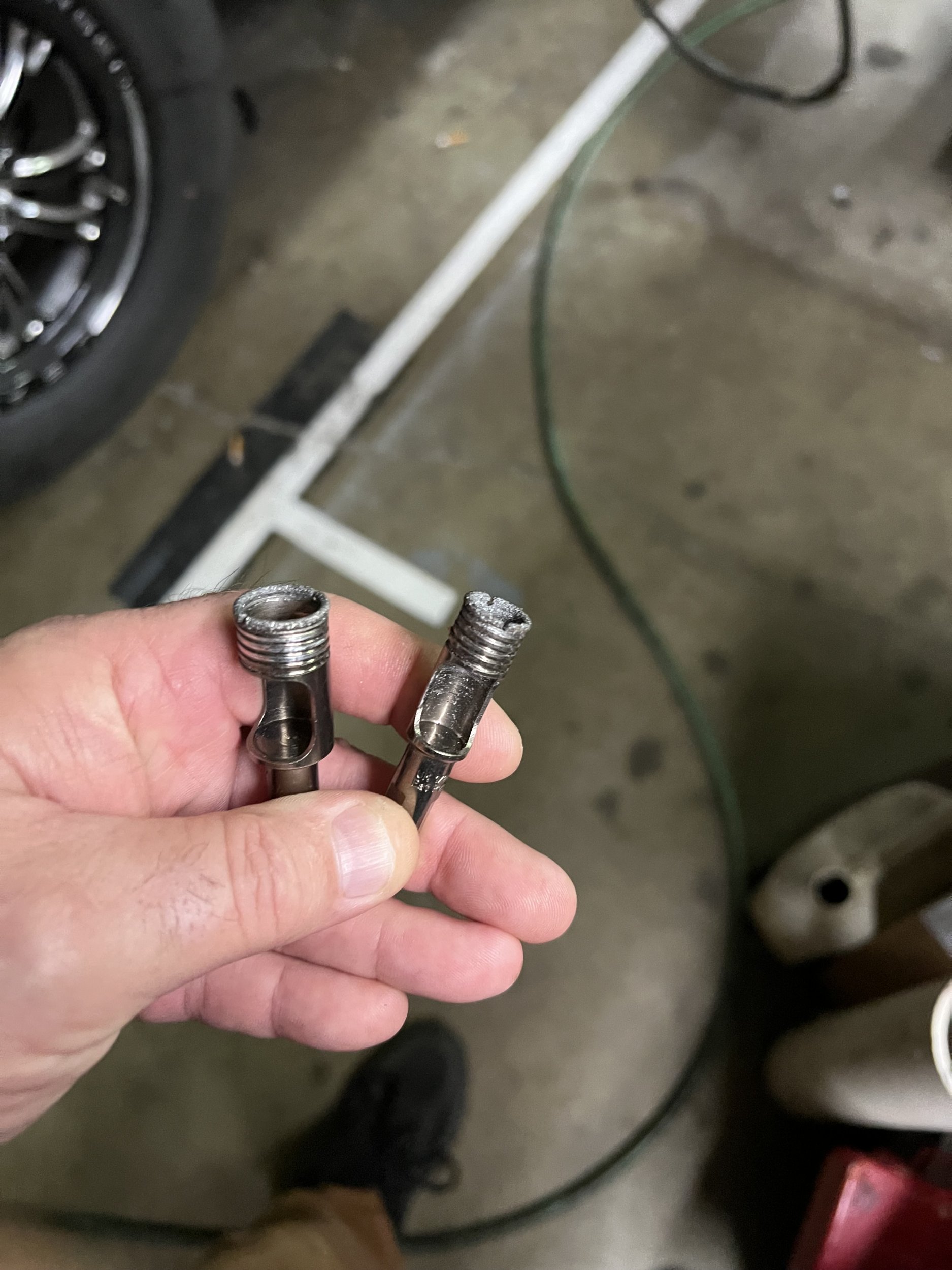

    & I use these hollow Diamond hole saw
    To remove "" Swedged"" studs , they cut real well , like $10
