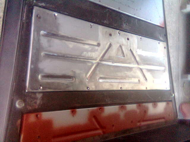

    heres a floor i'm doin for a 32.made the floor with no swages.then made a bead roller-but had trouble rolling it as the edge is folded back on itself and also the 1.2mm thickness didn't want to form easily.so rather than remake i swaged using ply with a groove clamped underneath and a lenght of 20mm diameter bar and a big hammer.had to finnish/tidy up using same round bar-turning over and hammering on the bar and lengths of flat bar on edge to define the edges.is bolted down at edges through countersunk inserts to stop edge crushing in.is kinda overbuilt but as seats and seatbelts mount to it wanted to be sure.
