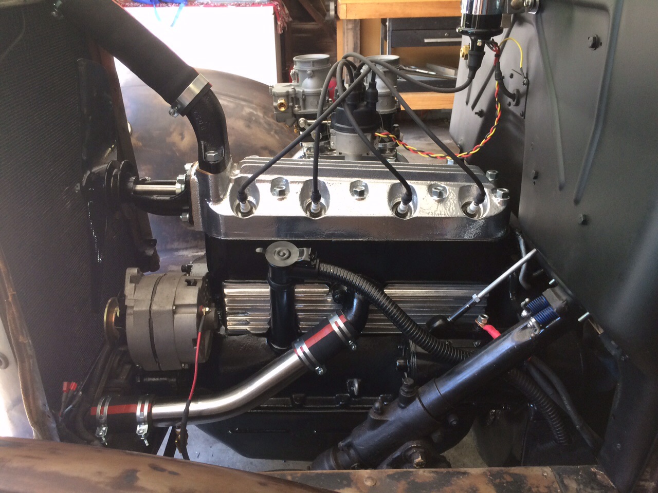

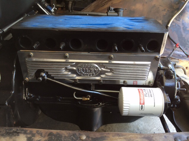

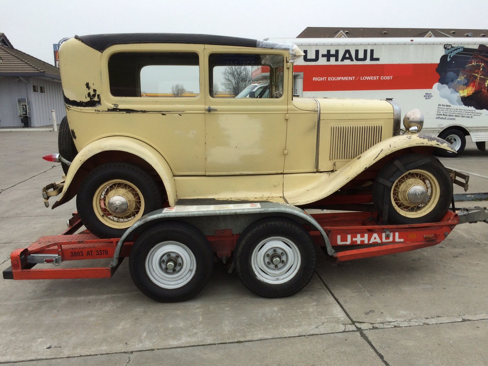

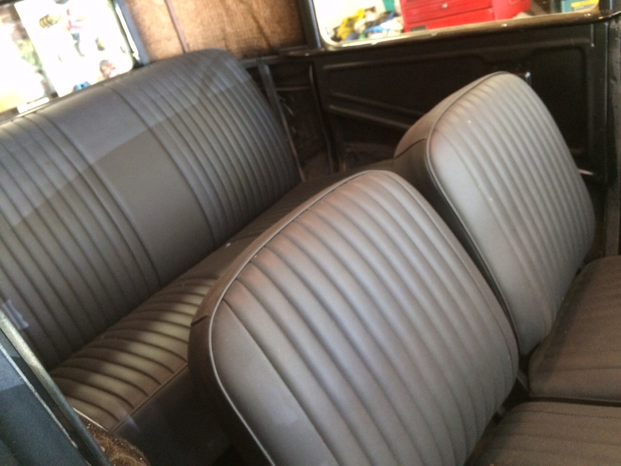

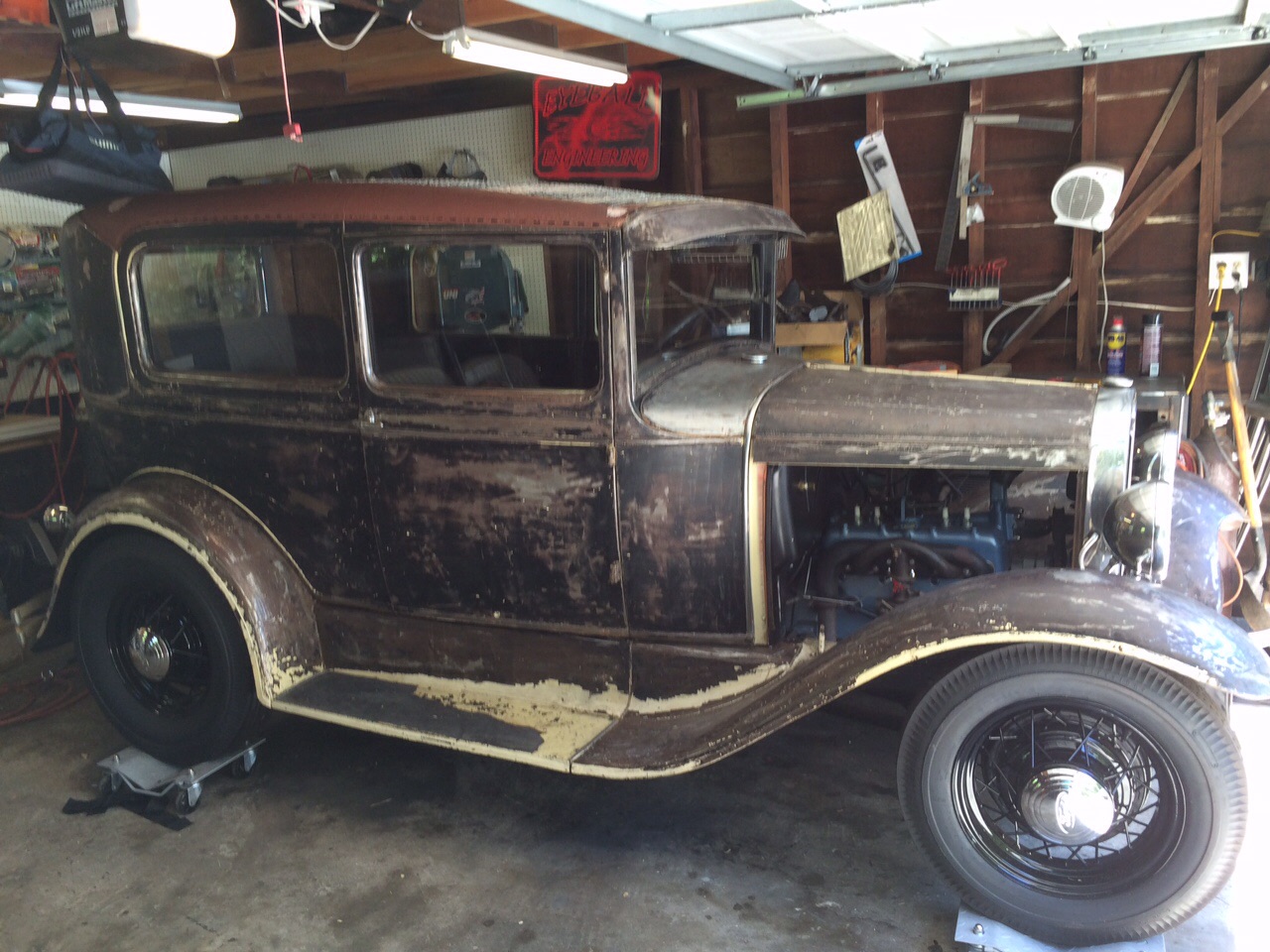

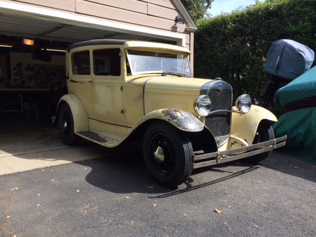

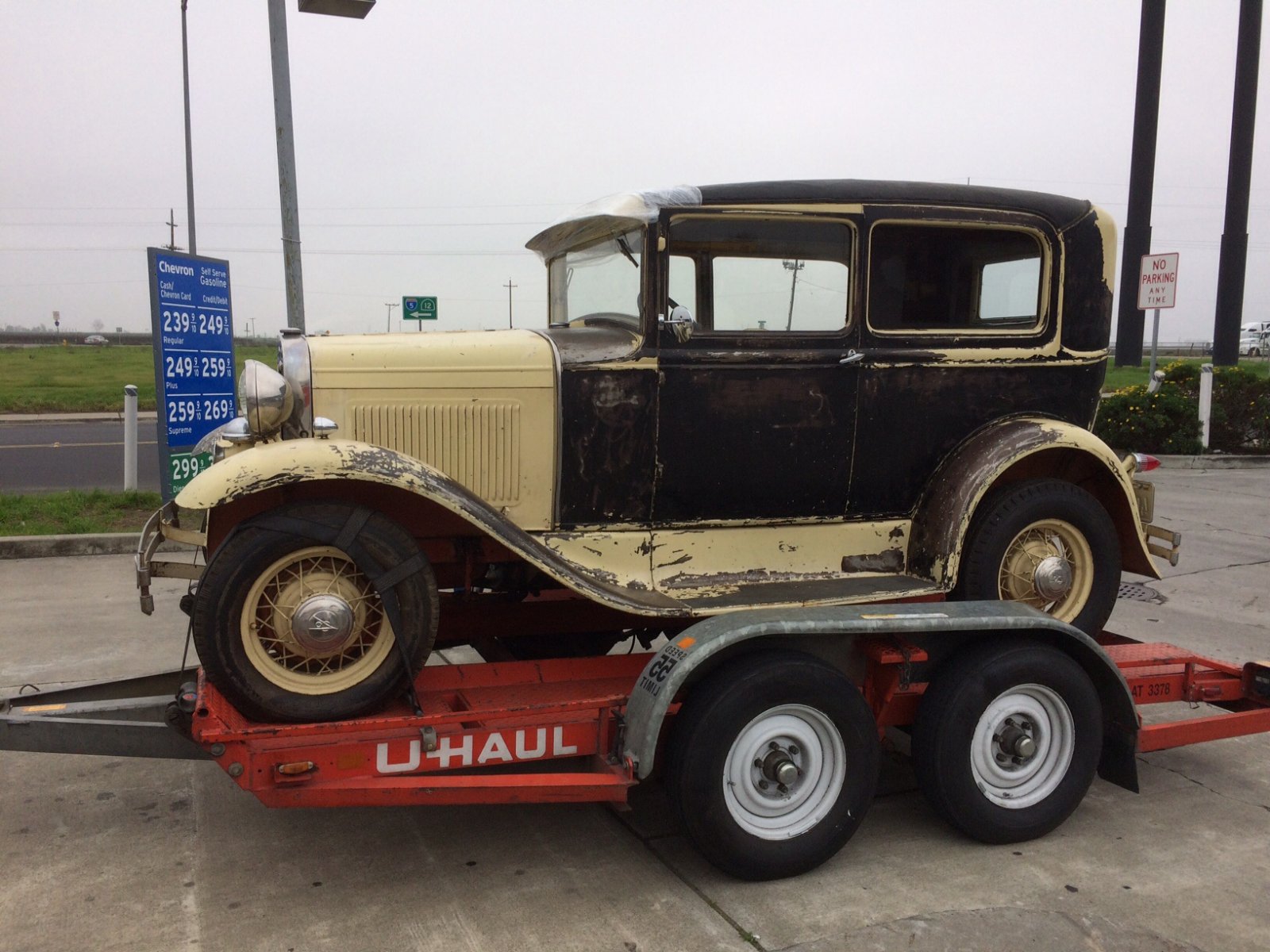

    Im new to HAMB but really like this site. Great info all over here. Picked up a30 Tudor a few months ago and been hot and heavy on it ever since. Motor was in great condition so decided to build a banger. Motors pretty much done and starts and runs great. Paint stripped and 4" drpped axle installed. Some leafs removed and spring eyes reversed front and rear. Thinking leaving finish as is and pin striping right over the way it is, nicks, dents and all. Luckily this was a rust free dent free car. Close to gettin it down the road. Looking forward to meeting a few HAMBERS in the Central Valley, Ca area.
    Still a lot to do but here is a few before during and after pics.

    Good looking engine, keep it on the road!
  3. 340HilbornDuster
    Joined: Nov 14, 2011
    Posts: 2,113
    340HilbornDuster
    Hey Back up a little with the camera...so we can see the whole car.
    Looks like a really nice stance!
    Cool Banger Goodies!

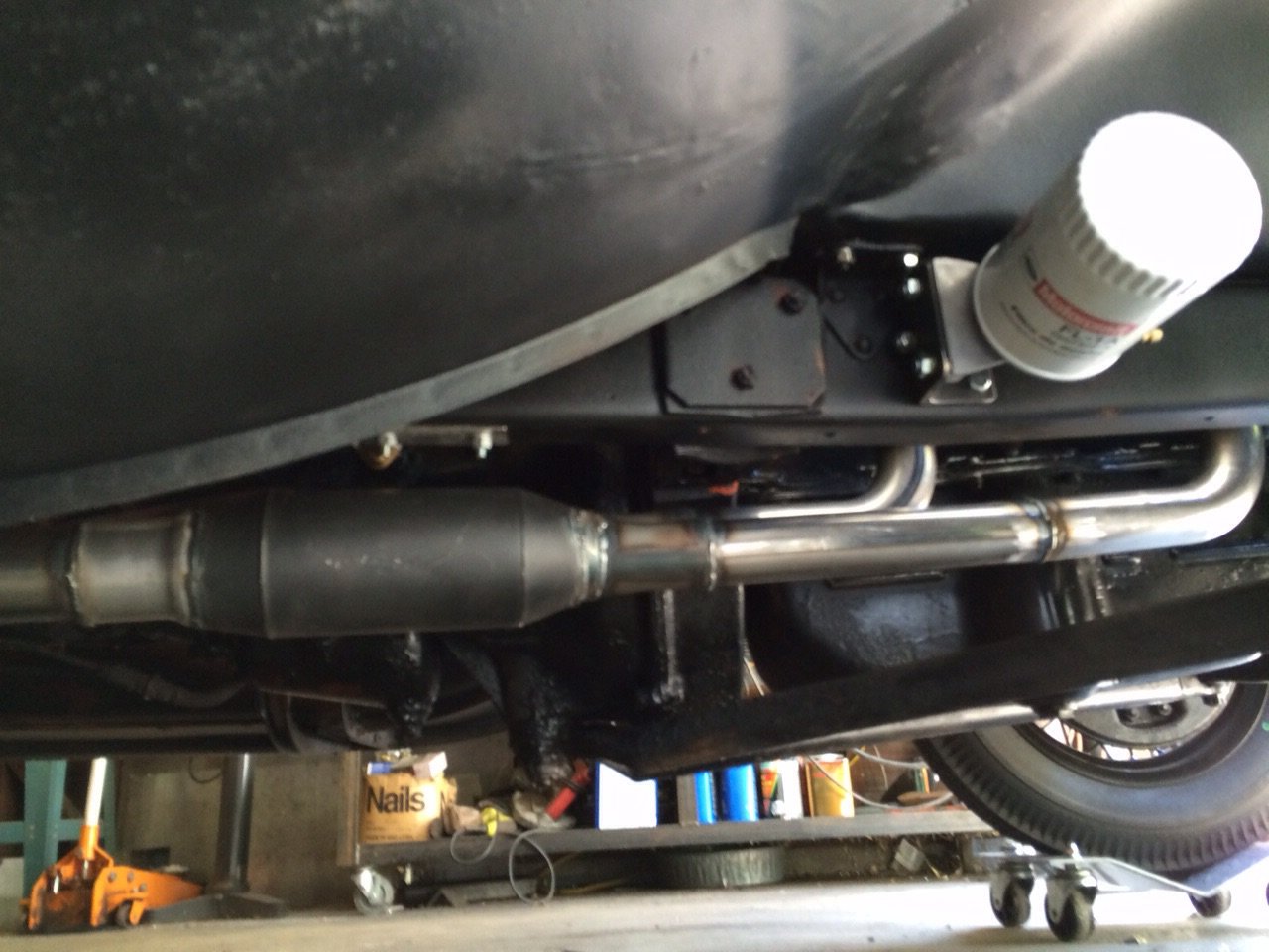

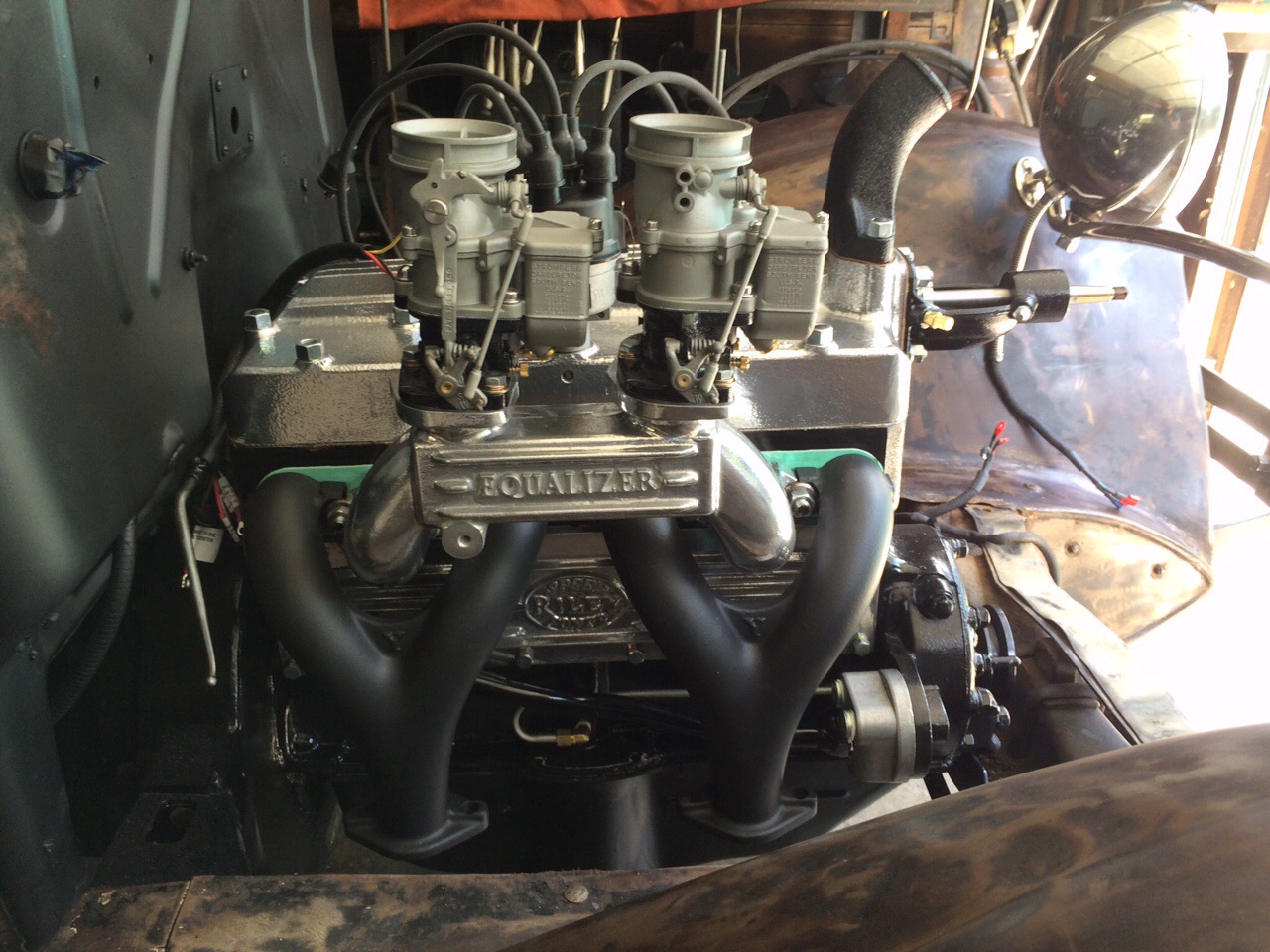

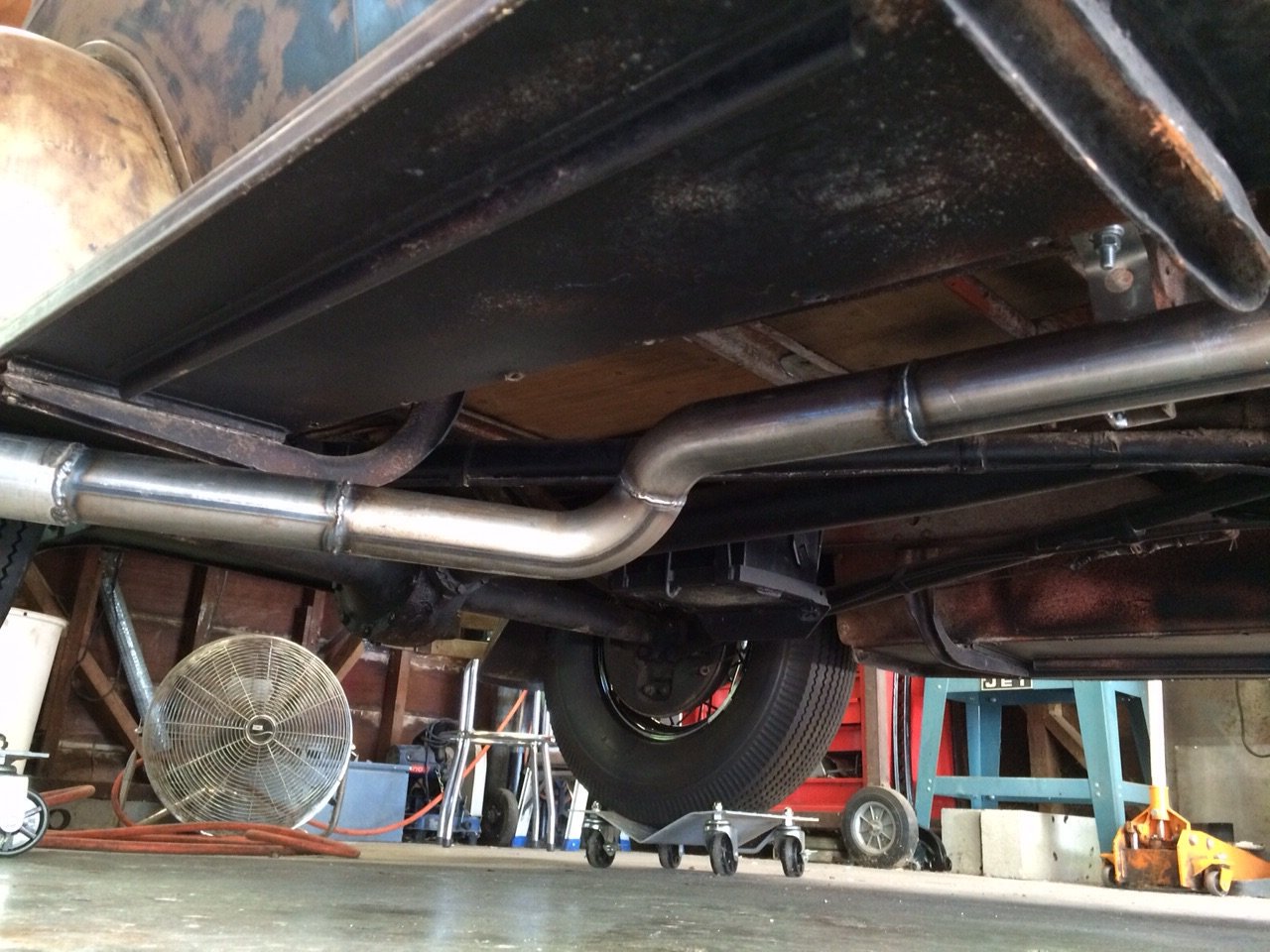

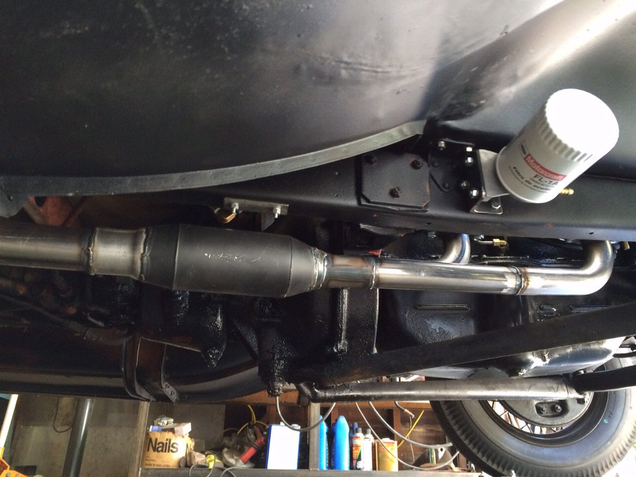

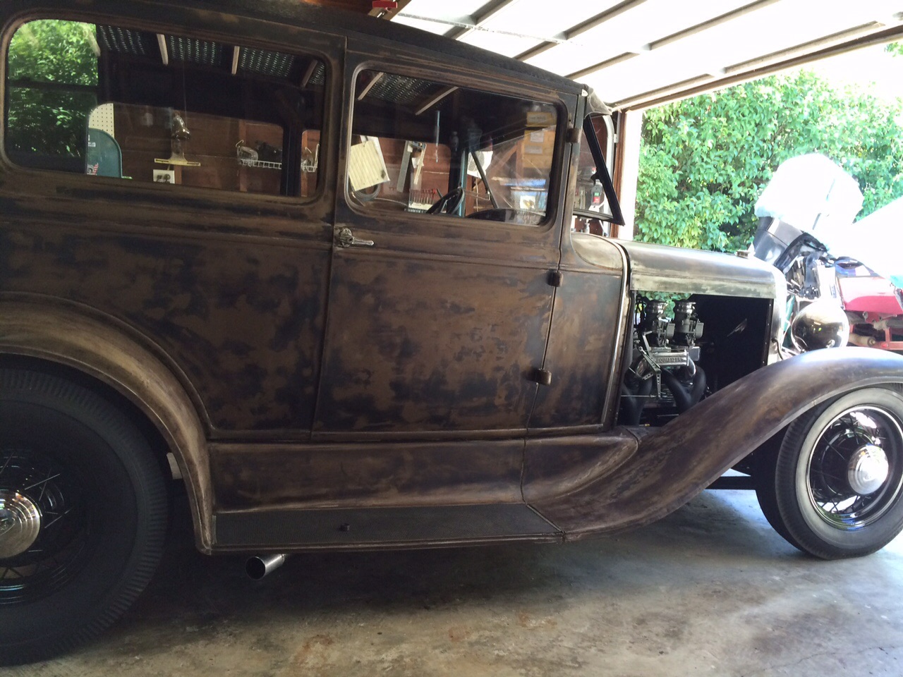

    The engine was newly rebuilt and ran really well so I left the internals for now, but plan a cam upgrade after I run it awhile as is. The head is a Lion Speed IV 6.5 compression. Equalizer intake...cool thing about this intake is it directs all the fuel to the center of the manifold to help from over fueling some cylinders while under fueling others, kinda like a distribution center. FSI electronic ignition. Yap exhaust 2 into 1 cast headers. 2 Mr. Stromberg 97s. linkages are home made as well as exhaust all done with mandrel bends and a few other small goodies like steel crank pulley and greaseless water pump. That's about it for the motor for now...fires right up and runs pretty well as is but still tunin a bit. Here's a couple pics of the exhaust, pretty simple and straight forward actually.

    Man....that is sweet!! Great work!!

    That's a great looking Sedan.

    This is a traditional Rod with some Hot Rod improvements...
    Awesome Style!...(Looks like you're having fun!) can't wait to see the rest!
  15. i like the linkage with the choke built in

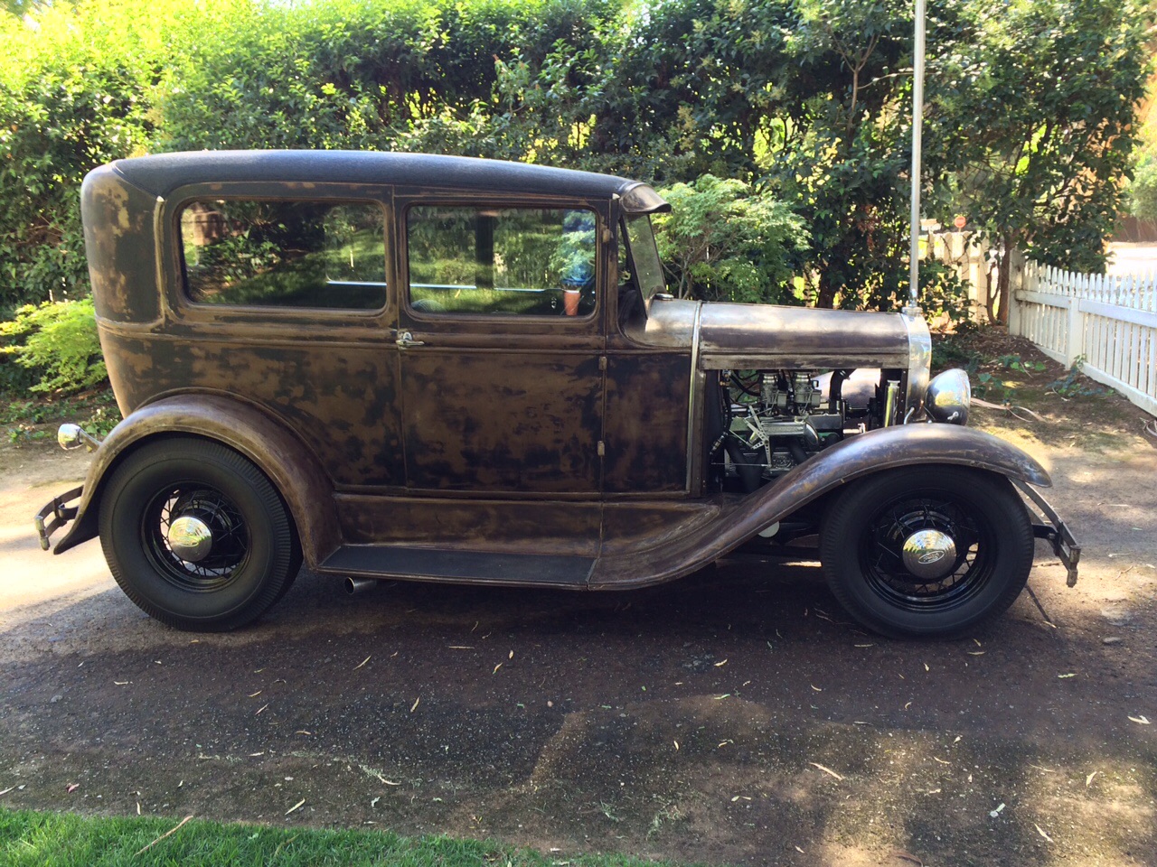

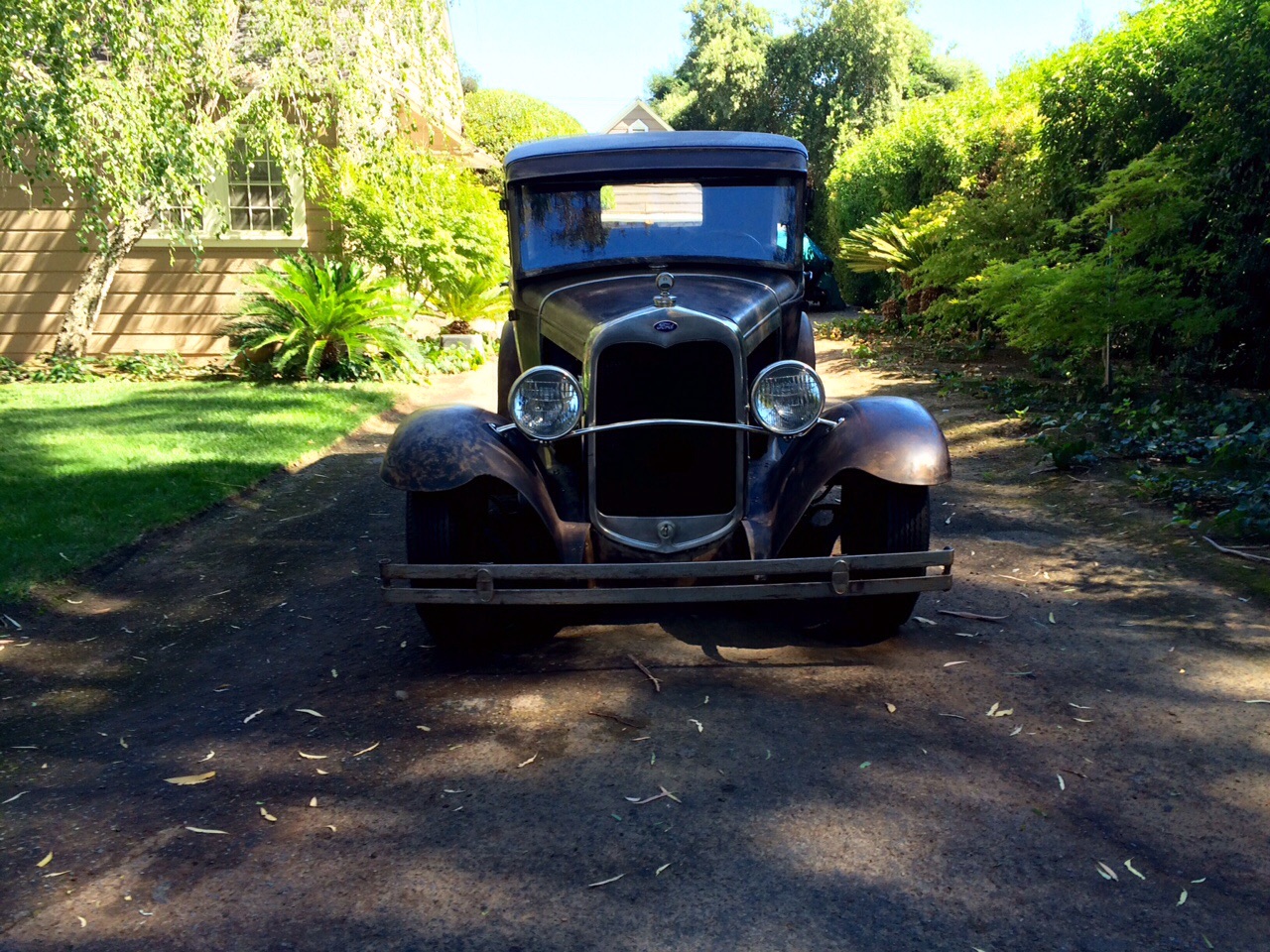

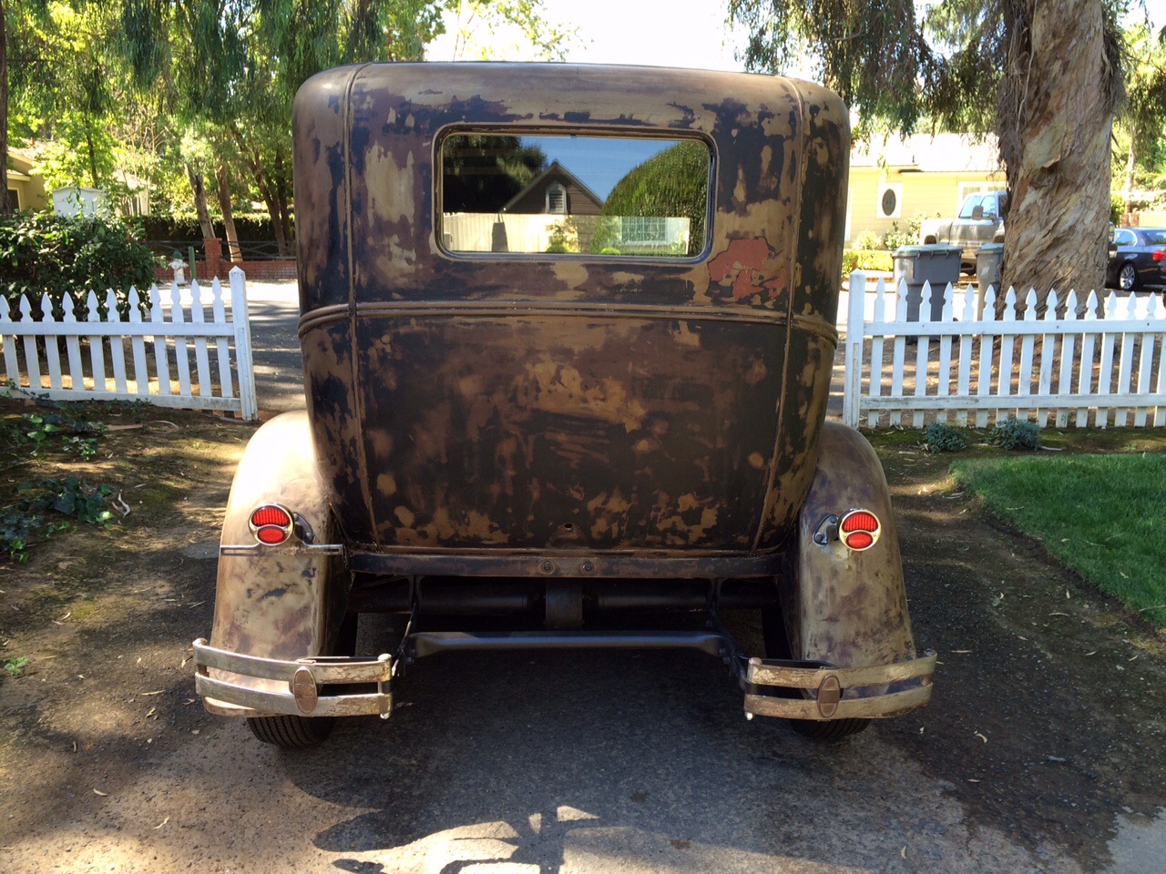

    here are a few picks outside. thinking of lowering the back end a touch more but looks pretty good as is.
    kidcampbell71, CTAV8 and waxhead like this.

    Looks rite on the money Ron. Bob.......
  18. Tony Martino
    Joined: Apr 2, 2010
    Posts: 3,930
    Tony Martino
    Hey Ron,
    Stance is almost everything around here,
    and your car nails it.
    It looks just about perfect,
    And WAY cool!
