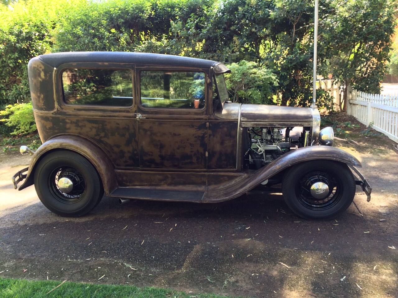

    Killer car! I started out with something similar. The stance is perfect, I wouldnt touch it. Nice work.

    I bet you'd get more people looking at your sedan because it is unique in it's own way. Much more interesting than a row of "gl***" '32 coupes with fancy paint and a 350/ 350 combo. I call those "jelly bean cars"- same flavor, different colors. Anyone that would call that gem of yours a "rat rod" is a dip****, and isn't worth acknowledging. Some people just don't get it! ( and some people need a lesson in manners, like "dumprat" suggests!) Cool, plain, and simple- BINGO!--- More info needed on how you re-worked your suspension- looks perfect!

    Love the banger, nice tudor!

    Hard to beat a good looking Model A sedan,it's a beauty! HRP

    I wouldn't change a thing!

    Mike...here is how I lowered the car...Wheels are 16s, tires 5.50 front 7.00 rear. Back end, reversed eyes ( done in garage with press) and 3 leafs removed. Front, 4" dropped beam axle, Reversed eyes on springs, remove 2 leafs. Had to build spacers for the springs to make up for the difference in spring pack thickness. I originally tried using the original spindles but switched to a pair of 32 spindles so I could remove steering arm balls and reinstall upside down to help clear oil pan. This axle moves wheels inboard about an inch on each side, which works well as it centers the tire in the fender well. Nothing rubs so should work pretty well. Short pitman arm helps clearance with drag link as well.
    Also for anyone interested, I figured a way to reverse the rear spring eyes and reinstall under the car without a spring spreader. let me know and I can p*** this info on if you like. Ron

    Great looking car with a wonderful stance.. I like the "patina".
