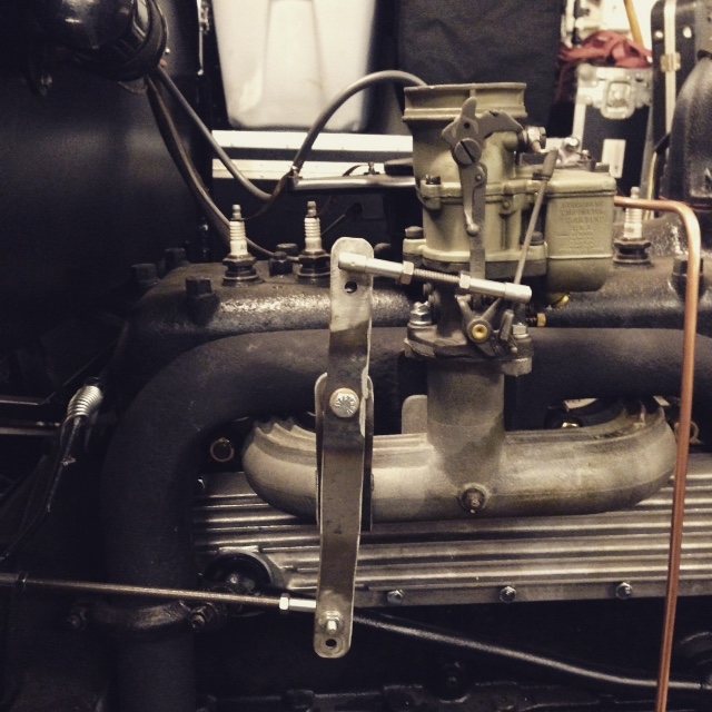

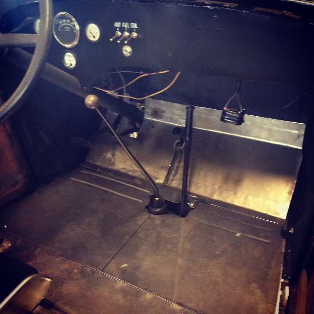

    Been a while and been very busy buying/selling and wrestling this addition of rust and speed. Recently picked up the fibergl*** body for our first Bonneville V4F banger belly tank build and a 1928 Model A Truck (hand made wood cab not a Huckster) that will be our shop truck. You can see it's a bit full at the moment.
    But, we've made good progress on the coupster by adding a 6:1 head with a little extra shaved off (6.5:1), mech advance dizzy, burns intake and 97. Finished up the floor, fabricated the throttle linkage, and made a few p***es to tune her in. Just have to finish up some items for track safety, tie up loose ends and we are ready!. Here are few pics, I'll post some more then.
