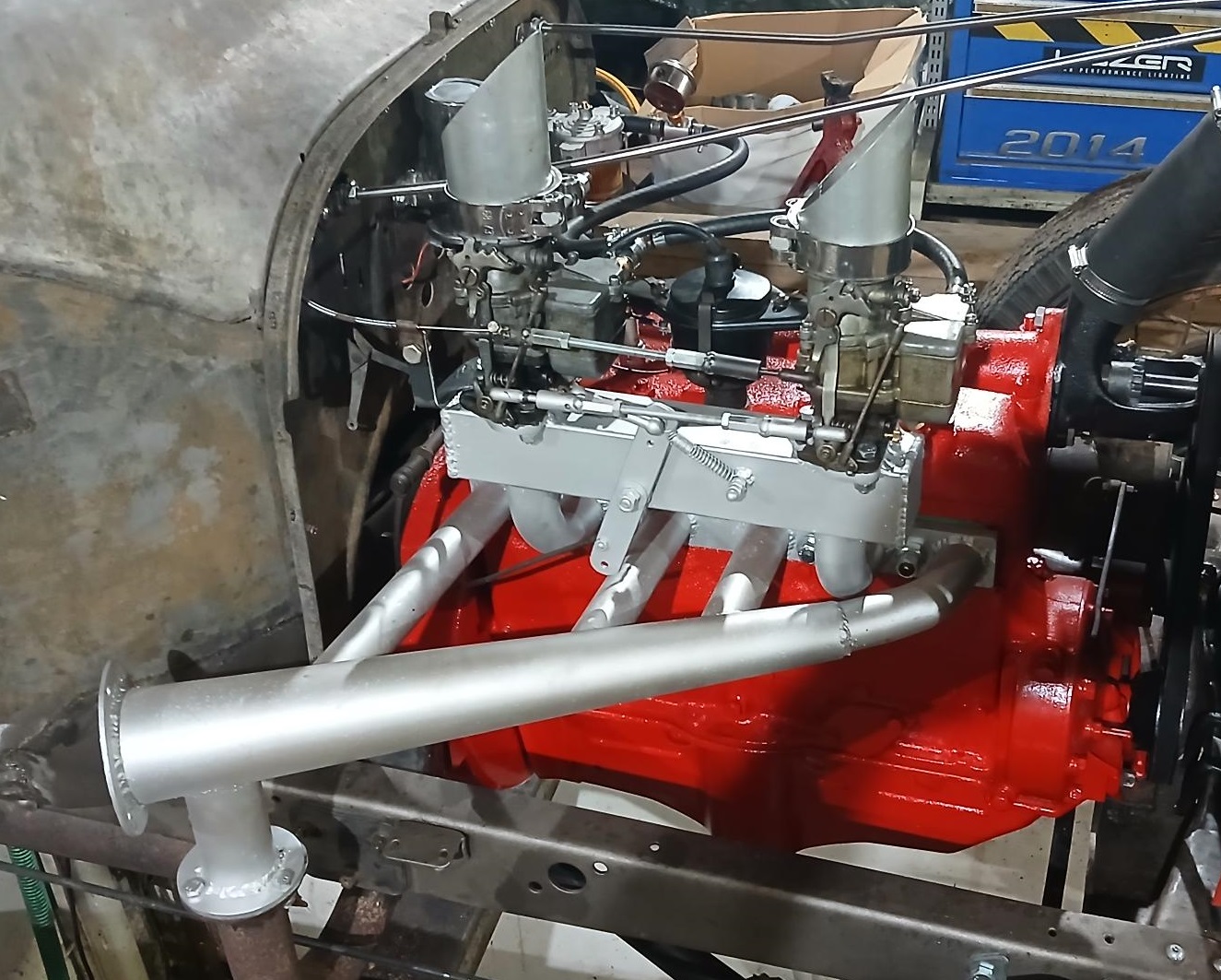

    I do not know if this helps any, but this is how i made mine for two downdraft carbs. I connected original A linkage to a rod pivoted in the middle and connected that to the carbs. So linkage connected to the carbs move opposite way. Not pretty, but works with Strombergs anyway.

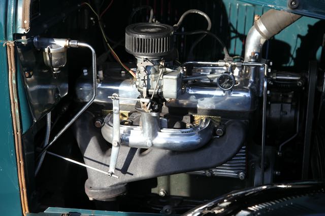

  5. Maybe something like this? (not my car)

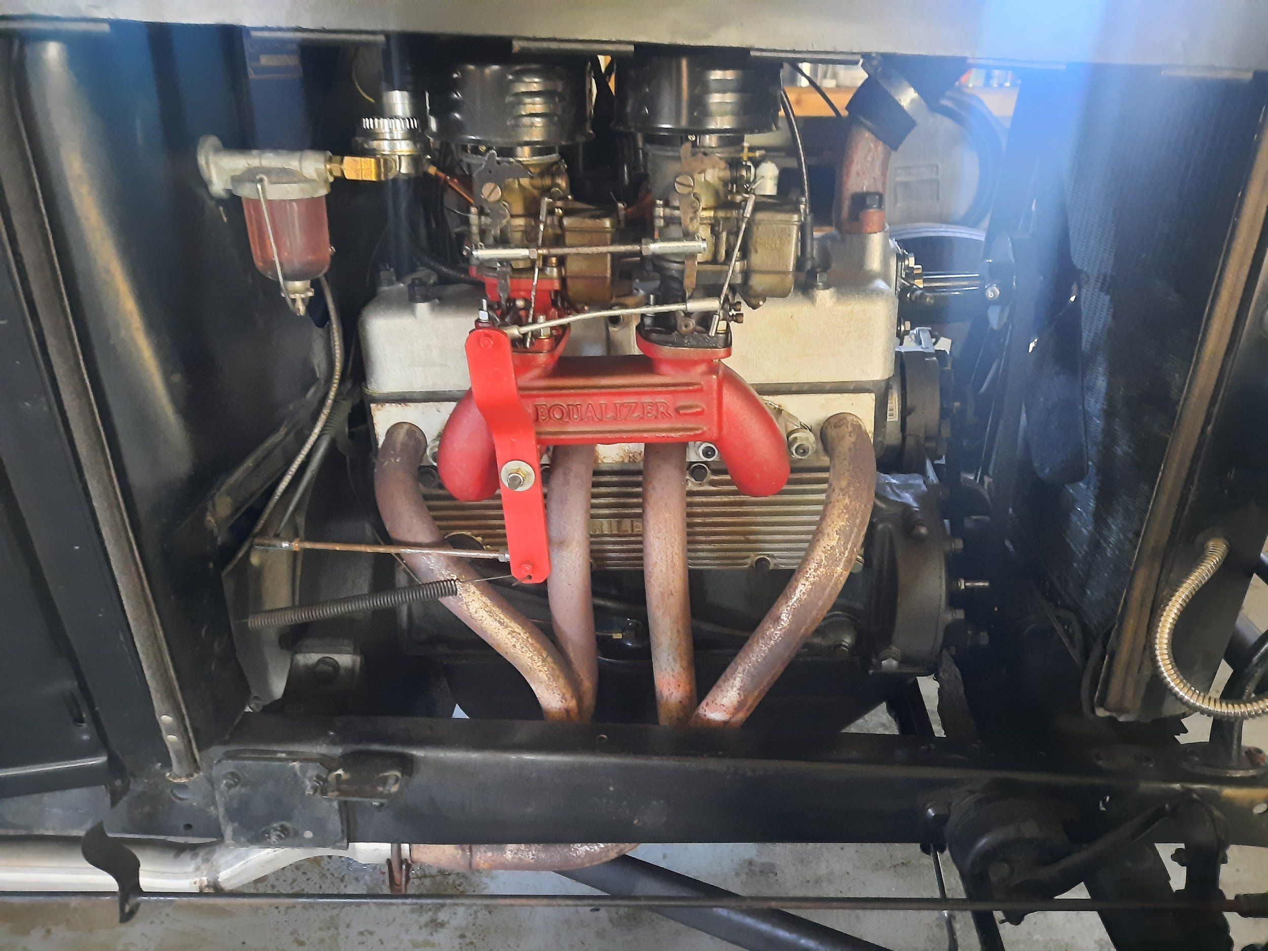

    cabby engine latest resized 1MB.jpg yes, you need a bell crank mounted to the manifold..someone was making these and listed them in the cl***ified section...but that has been years ago...but you get the idea and one can be made with a piece of flat iron

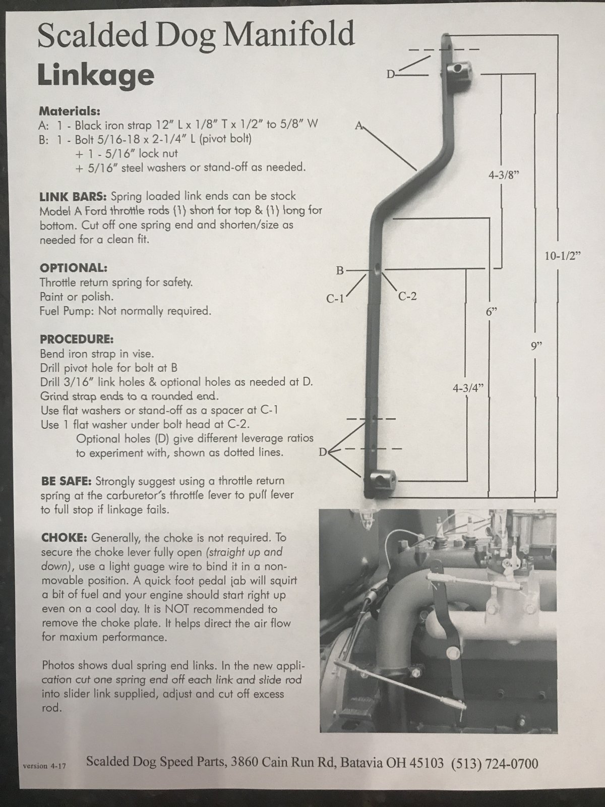

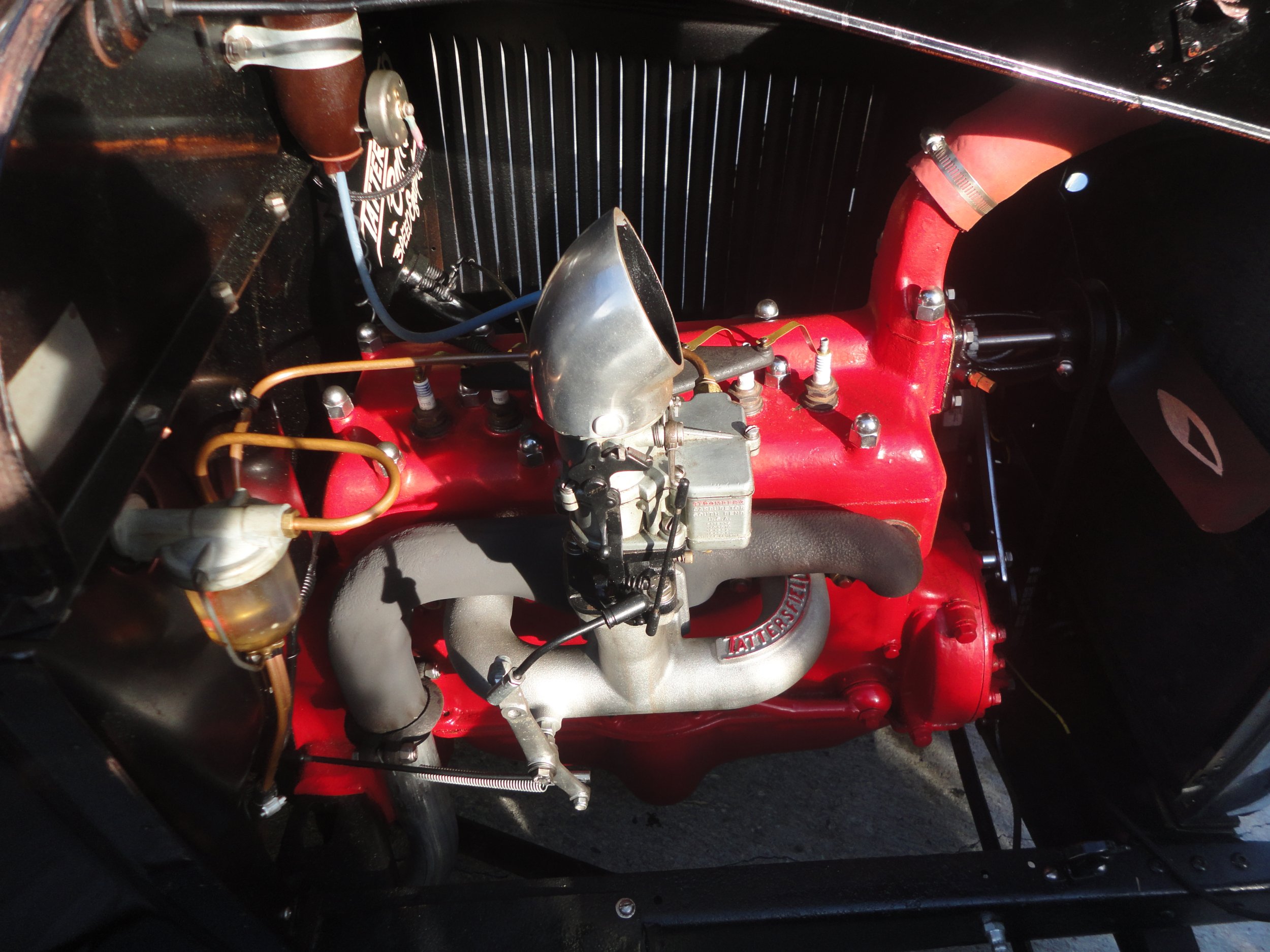

    Here is a do***ent from Charlie Yapp detailing making your own bell crank. When I got my Equalizer intake, it didn't have one so I made this. It works great with my dual 97s. I make my own link rods by threading some rod the proper length and installing the spring ends.
