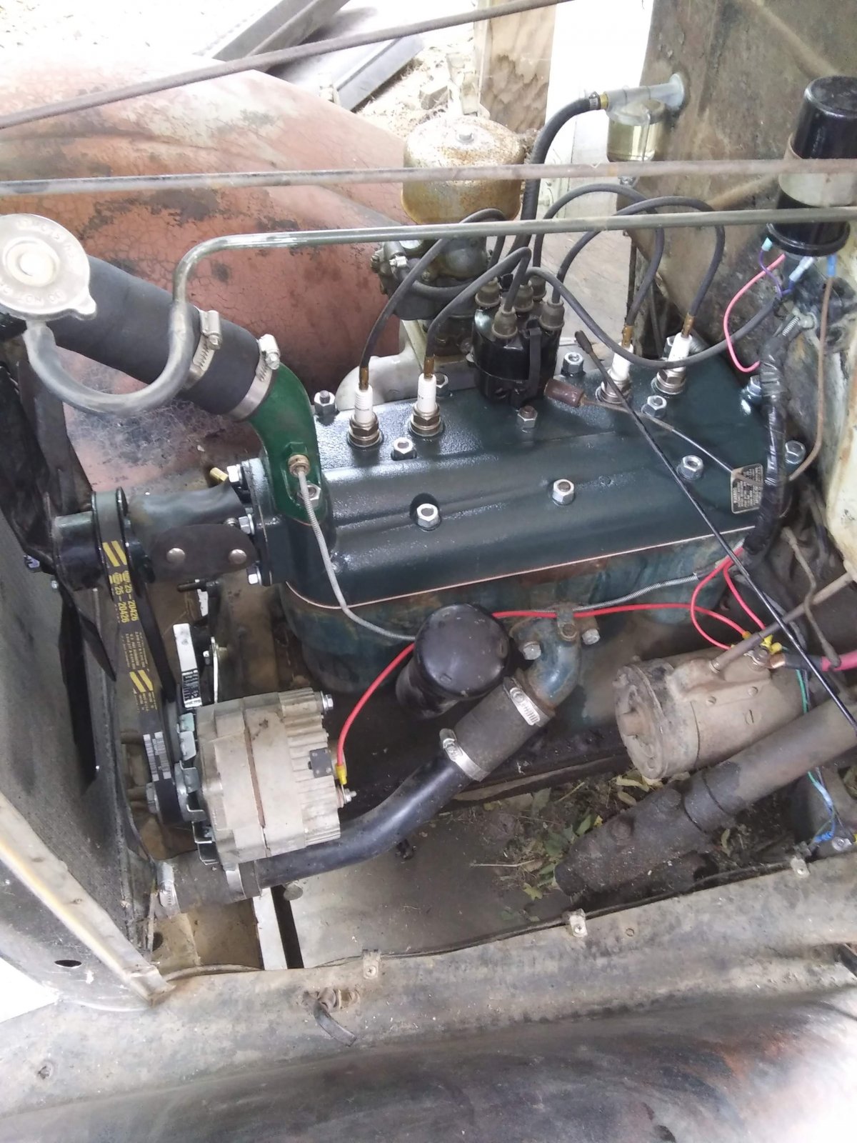

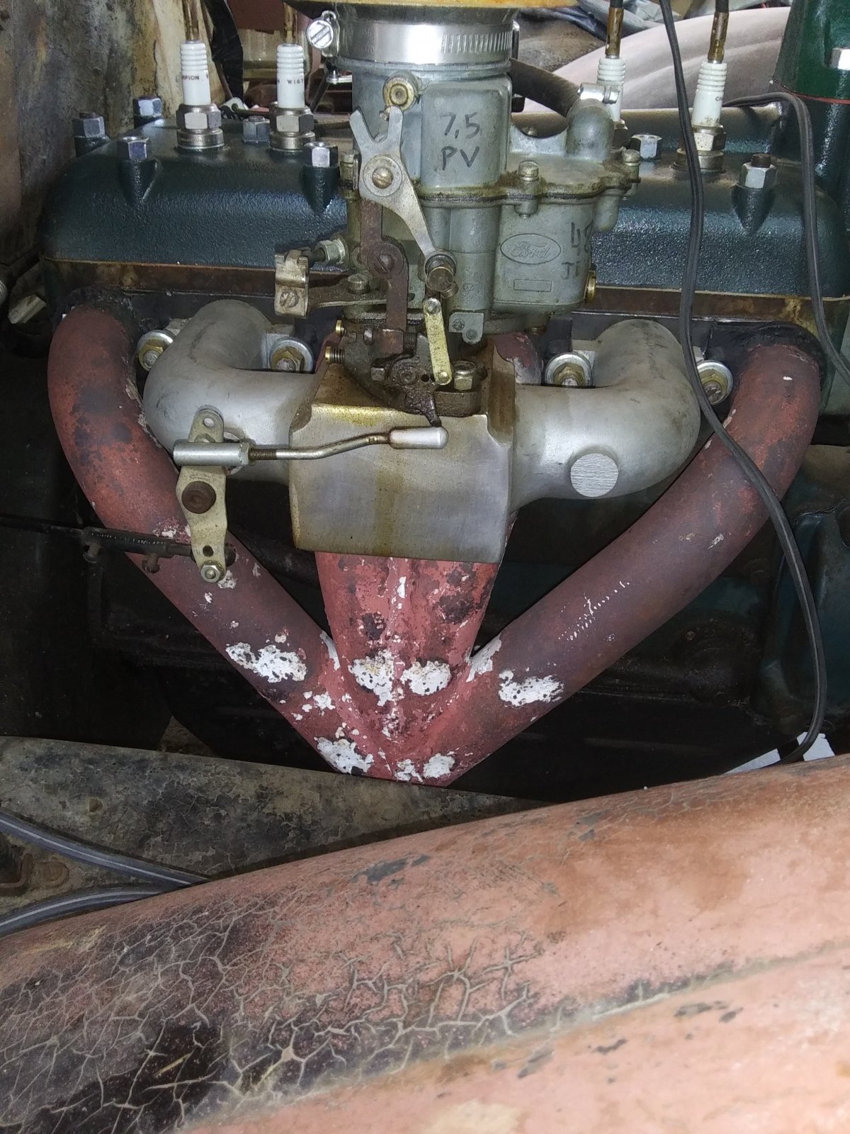

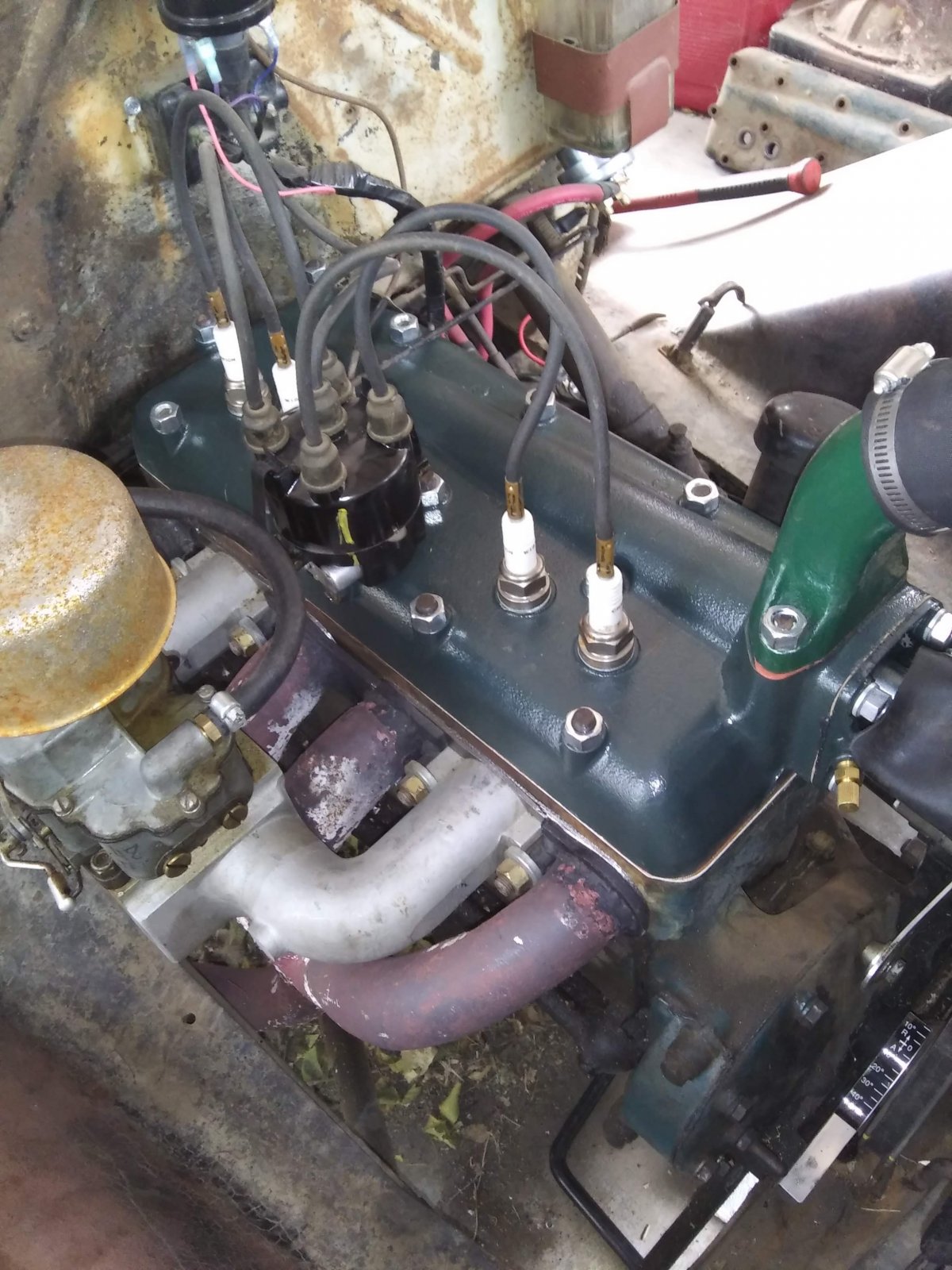

    20200913_100647.jpg 20200912_104538.jpg 20200917_182258.jpg 20200912_104529.jpg my set up sits lower than the fuel Outlet. The intake is unknown manufacturer but if I'm going up the hill and have less than quarter tank it'll run out of gas

    I run a Weber carb and manifold on my B Diamond block and 6-1 head. Gravity feed. They are low like @wheeltramp brian and no lack of fuel in my '31 coupe. I also added a steel angle plate bolted to the exhaust manifold that is against the bottom of the intake to keep it from icing the carb and intake manifold.
