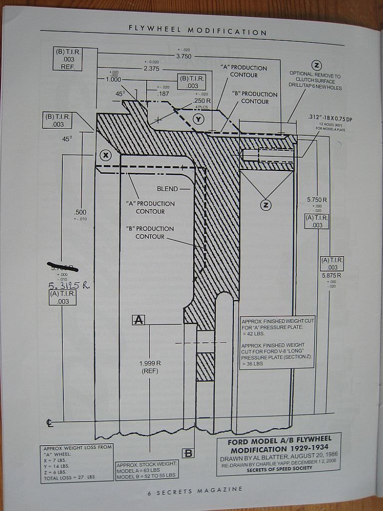

    For the life of me I can't find a print of a banger flywheel that has been modified to take a V8 clutch/pp. I thought it was on here somewhere but no such luck in finding it. Anyone have a copy they would share?

    Cut the top ring off, down to the contact surface. You should have a small little groove left, and don’t cut more just to remove that. Then drill the V8 bolt pattern in it.

    This maybe....
