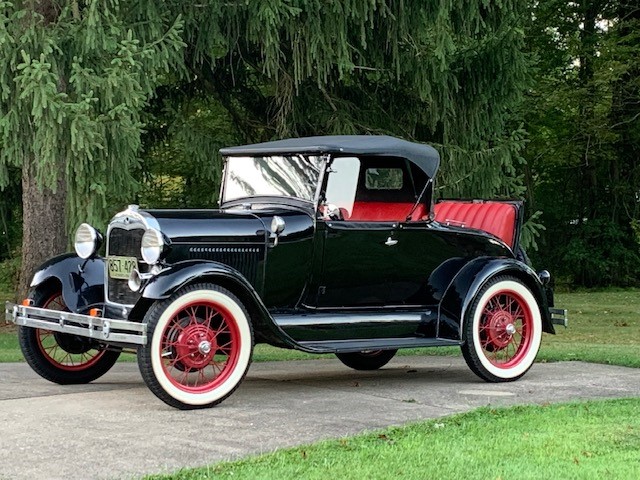

    This is what she used to look like:

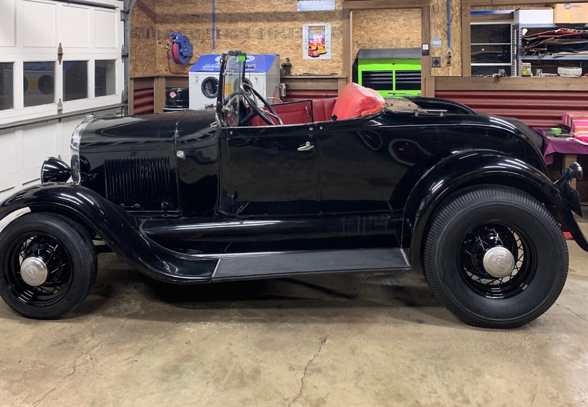

    Before new center caps:
    With new caps and the dropped headlight bar:

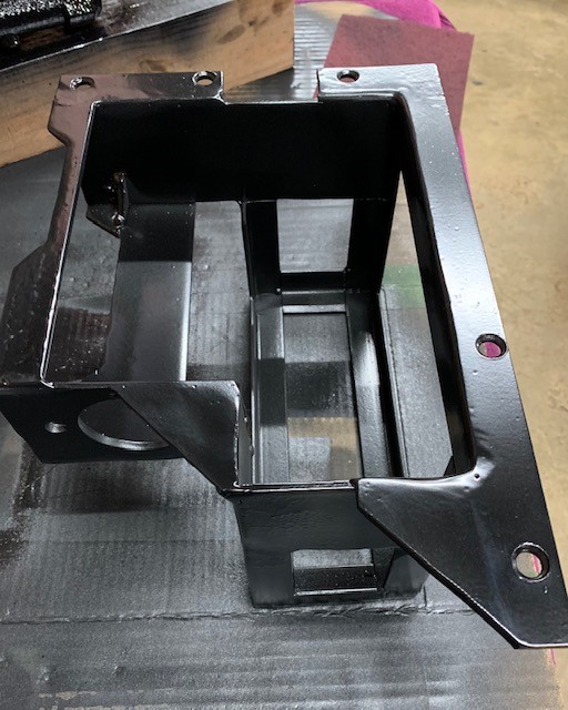

    My custom battery / Master Cylinder box:

    What a cute little roadster. I like the way you used the stock location for your battery and master cylinder. All the things you mention will keep it "period correct". Bratton's has a downdraft carb and manifold PN 13870, two barrel Webber, mounting kit and air cleaner for $680. Just make sure it's compatible with your planned headers. You may need to install an electric fuel pump, rather than gravity from the stock location. If you have deep pockets you can install a Mitchell Overdrive, a bit pricey at $2700.

  6. Nice job on the battery box....master cylinder...
