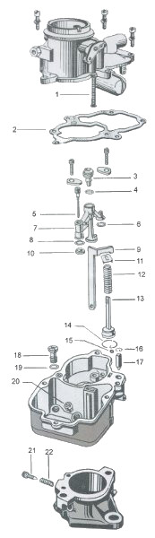

  3. power valve may be opening too late. Change it by shimming the spring or stretching it.
    Holley 847 Diagram
    [​IMG] 1. Power Piston Assembly
    2. Bowl Gasket
    3.Nozzle Plug
    4. Nozzle Plug Washer
    5. Idle Tube
    6. Nozzle Bar Gasket
    7. Nozzle Bar Assembly
    8. Nozzle Bar Gasket
    9. Pump Operating Rod
    10. Nozzle Bar Screen
    11. Retainer Spring
    12. Return Spring Pump
    13. Pump Assembly
    14. Retainer Check Ball
    15. Check Ball
    16. Retainer Needle
    17. Needle Valve
    18. Power Valve
    19. Power Valve Gasket
    20. Main Jet
    21. Idle Screw
    22. Idle Screw Spring
