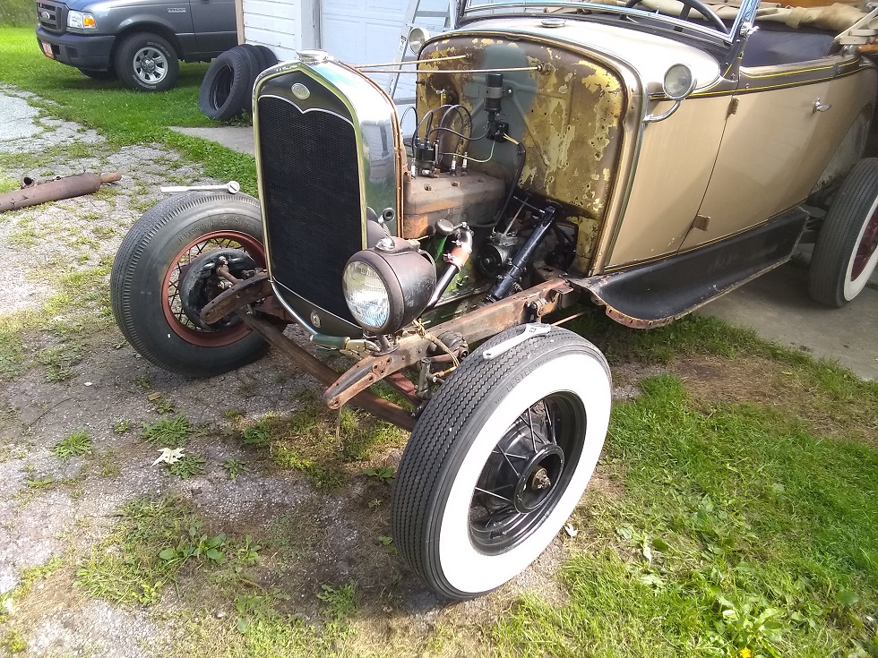

    I picked this up recently after a fairly long search for the right car. It's an older restoration that spent some odd years forgotten in a damp garage by the looks of it. It's fairly solid with good metal in the lower cowl, doors, and most other areas. It does have some rust down low in the wheel wells and a spot under the rumble seat where the mice whizzed, easy fixes.
    The plan is to work this into a traditional highboy one system at a time without taking it all apart at once. I've got other cars in various torn down immobile states, no need to add to the pile.
    Interior: 1930's steering wheel, maybe a 32 ford dash, lower the seat and windshield.
    Exterior: Some cool tail lights, Guide headlights up front, and paint it blue eventually.
    Ch***is: 3" drop up front, 16" wire rims, and hydraulic brakes.
    Engine: Temporary use of current engine to mock up downdraft carb, lake pipe, linkages, etc. Then build a new engine with high compression head and move all the stuff over to it.
    First thing on the agenda is pulling the fenders, running boards, and bumpers off. Second thing is scrubbing the mildew off it and a deep clean...

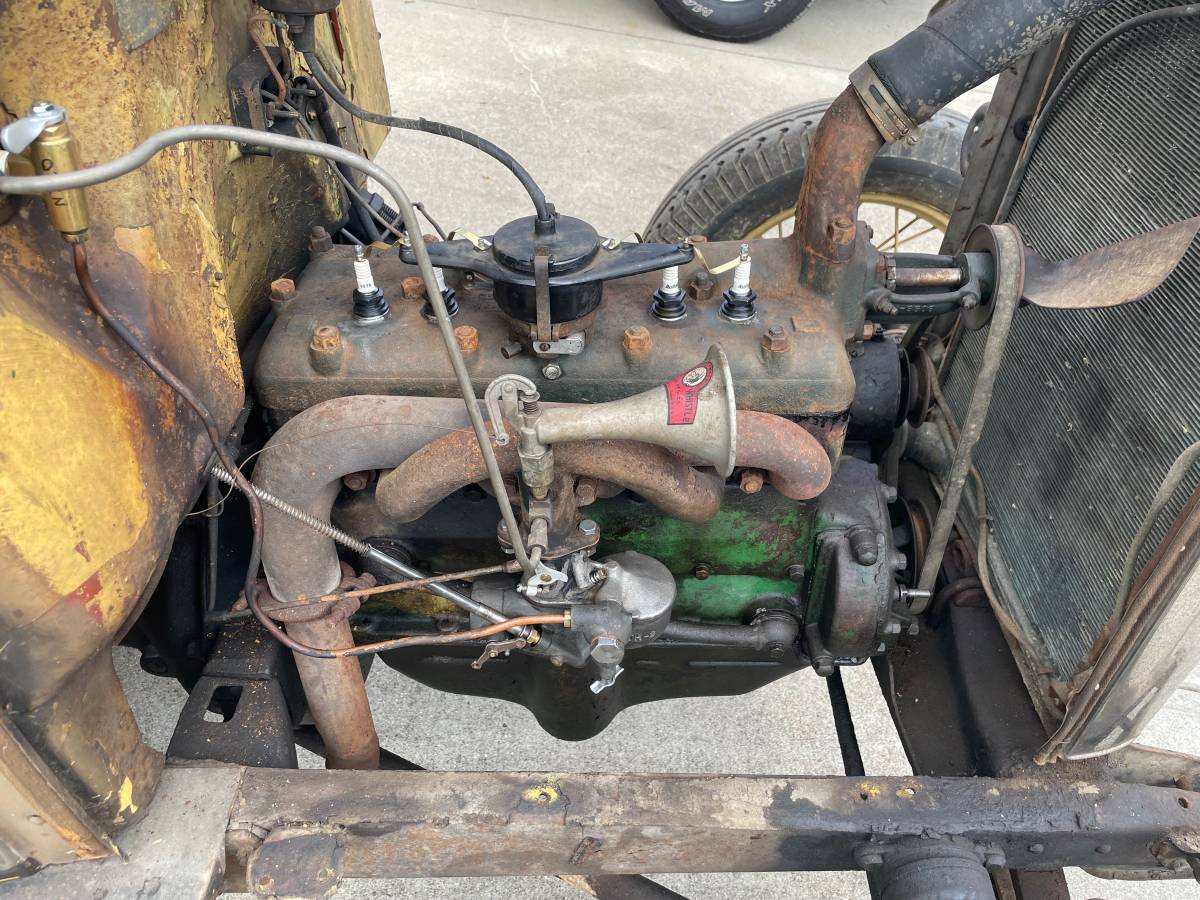

    I spent some time today cleaning... The amount of crud on the engine, transmission, and front axle was impressive!
    The engine has had some interesting color applied over the years...

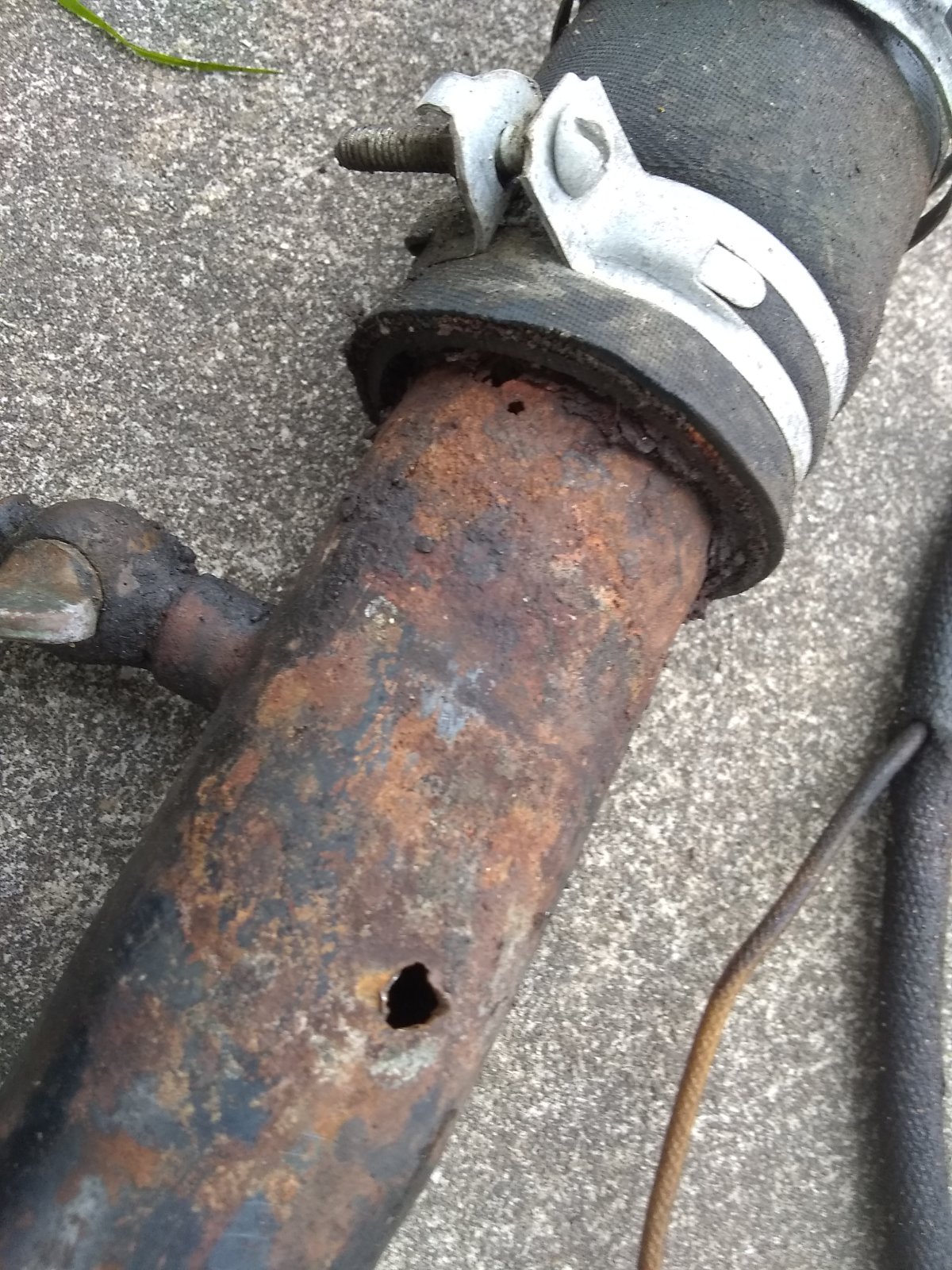

    The cooling system was dry when I got it. The lower hose piece had rusted through at some point and was full of rust flakes, replacement was mandatory...
    The rust through was hidden under the thick grime and after some cleaning it looked suspect. A quick poke with the screwdriver popped through the rust with little effort. I picked up a new part along with some new hoses and clamps and installed them also.

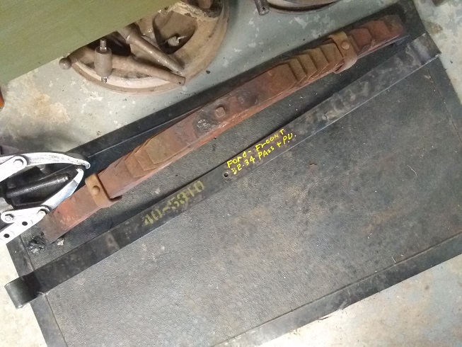

    I spent the last two months tracking down goodies for the front axle... I found some 32-34 hubs, spindles, brakes, and NOS perches.
    I found a 33-36 axle too...
    Since I finally had most of the parts for the front I spent an hour this afternoon pulling the old one. It's pretty worn, lots of slop in the king pins and shackles.
    I spent some time harvesting the bits I need including the wishbone, spring, brake levers, and hardware. I got lucky, and the gobs of grease from decades of use had seeped into the perch bolt holes and they came right out, no fight. The spring itself will have the bottom leaf replaced with a NORS 32-34 leaf I pulled from a spring pack I picked up a few years ago. I'll reverse the spring eyes for some more drop.
    I've got some vacation coming up over Thanksgiving I plan to put to good use. I'd like to mock up the new axle this coming week...

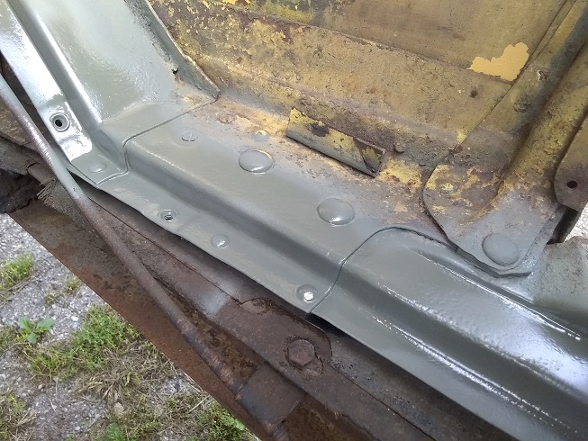

    I got the floor around the opening cleaned and primed. I didn't want to put the new floors in with all the grease and flaking paint going on...
    The floorboards themselves were hit with multiple coats of oil based finish, I'm not planning on running a floor mat so I wanted them to be tough!

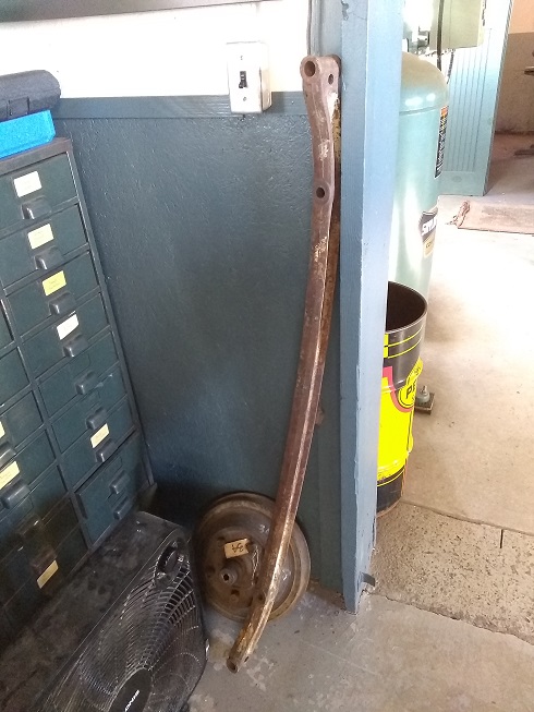

  27. lahti35
    Joined: May 23, 2004
    Posts: 248
    lahti35
    It's been unseasonably warm here the last few days so I'm taking full advantage to work in the unheated side of my shop where the sandblasting and larger items are cleaned of grease and rust.
    I got the wishbone and new axle cleaned, de-rusted and primed in preparation for painting.
    I also did the backing plates and grease retainers too.

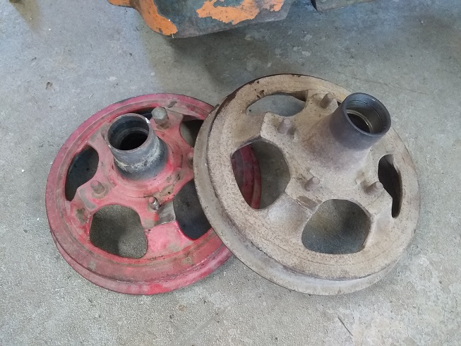

    Back when I started this I had planned on going to juice brakes but the more I thought about it the more I liked the idea of staying more prewar and running the mechanicals. I picked up the needed bits which included some 32-34 brake drums and backing plates... I blasted the brake drums and removed the old bearing races but I found that one of the drums had some severe wear and there wasn't enough left to turn them down again. I found a new set of drums that looked good last week.
    They both looked good so I chose one and darned if I didn't have the fight of my life on my hands removing the smaller bearing race on the outside. Usually I just weld a few rings around the inside of the race and they pop right out but not this one! Welding the race had little effect so I had to heat the housing and beat on the race from the backside several times to get it out. When I did finally get it out it looked like no race I'd ever removed. The ****er was cracked and actually expended upon removal, no wonder it was so had to get out.
    With the difficult removal I decided to use the other brake drum and blasted that one instead.
    I got it painted and will take it to the machine shop along with the other good one for turning this week.

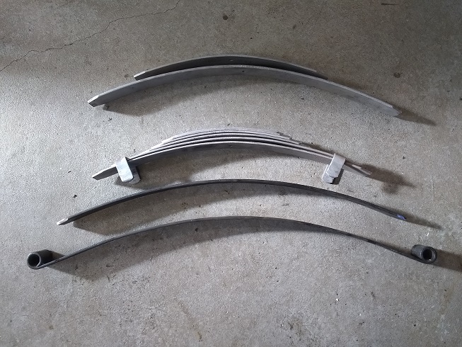

    I picked my spindles up from the machine shop Friday after I got the call. I bought a new kingpin kit to replace the old worn out ones that had groves worn in them. I work a mile from a good shop so it's handy to just run over there at lunch to drop off/pick up stuff. I had them install the new bushings and hone them to fit each kingpin. I degreased and primed them today.
    I also re-arched the NORS main leaf of my front spring today. I made a little press tool out of a junk Ford FE rocker arm shaft and some angle iron to keep it positioned on the ram of my hydro press...
    It worked well and I was able to reverse the spring in 20 minutes or so. I ended up using the second leaf from the NORS spring as well and cut it down to fit and look like the original leaf. The original leaf had some decent wear from the leaf above it rubbing so the new one took care of that. I played with the spring for a bit and ended up taking to leaves out of it, we'll see where it sits when I mock it up in place.
