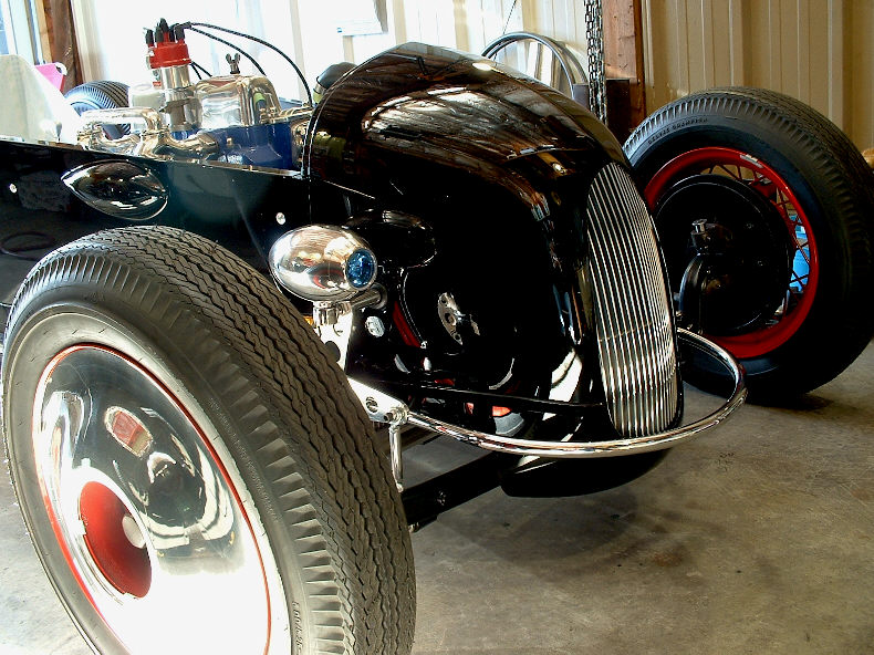

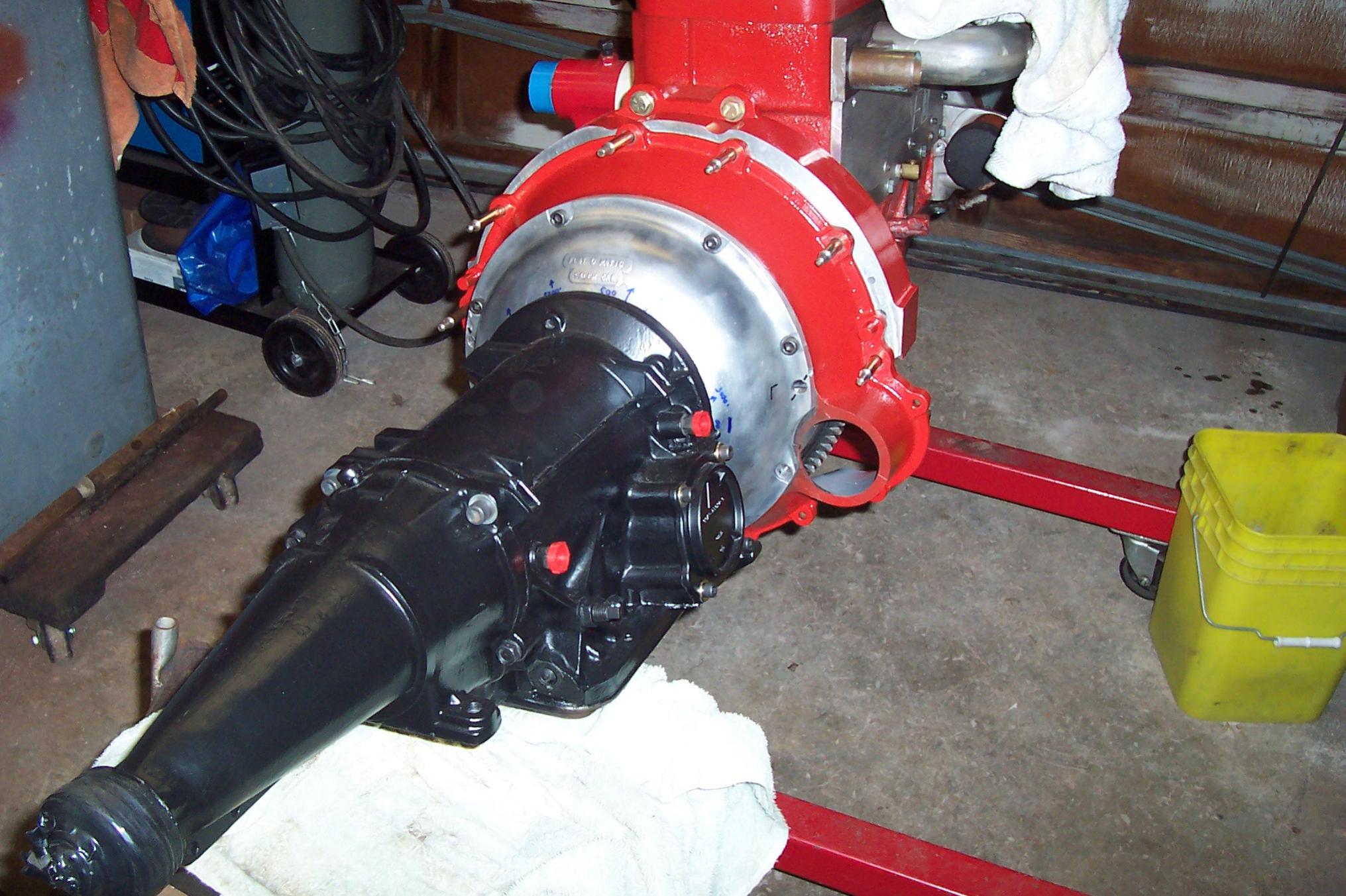

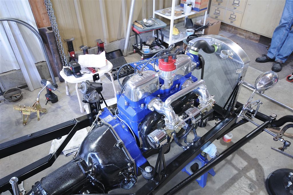

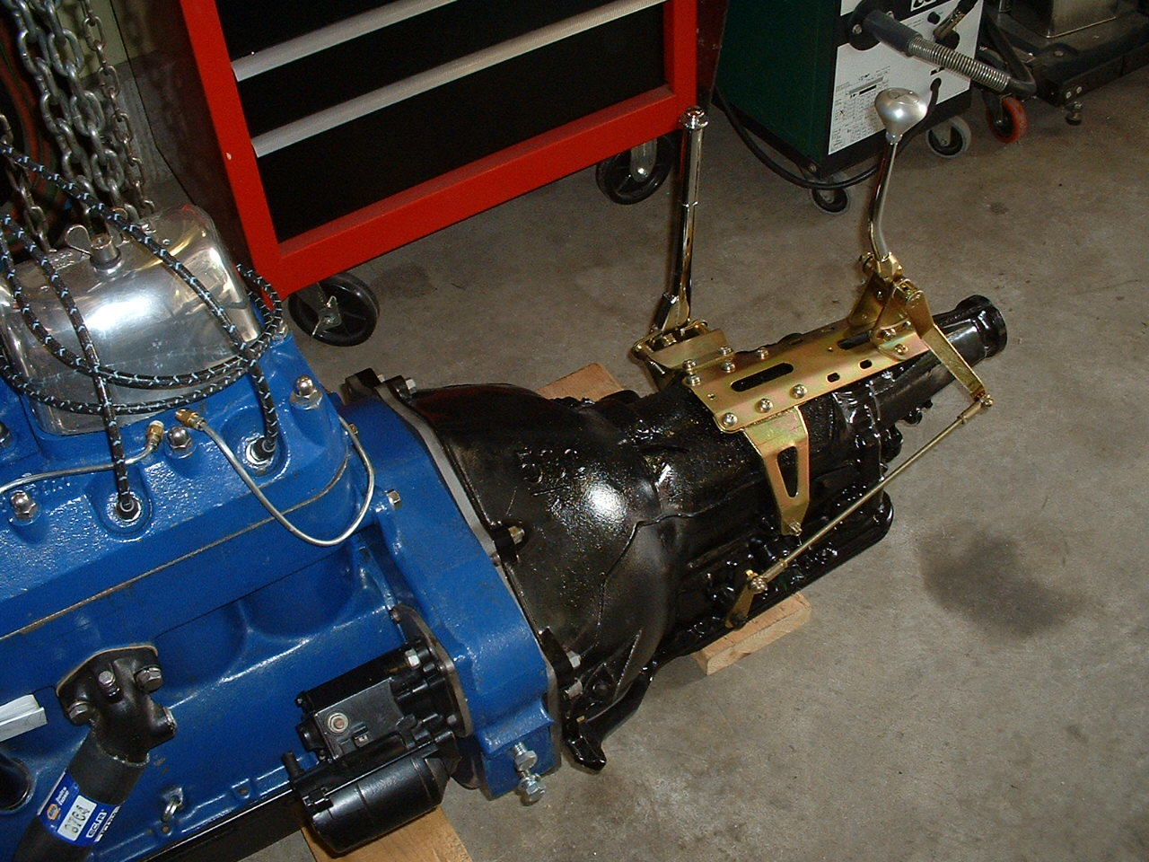

  22. Here are a few pictures that might be of interest to you. I'm using the Bendtsen package with a GM 200c auto behind my "B" engine.I'm also using a 1946 Ford truck rear end, which has the open drive shaft pinion set up.
    Hope this helps,
    Ron
    p.s. just had to show you the nose:)
