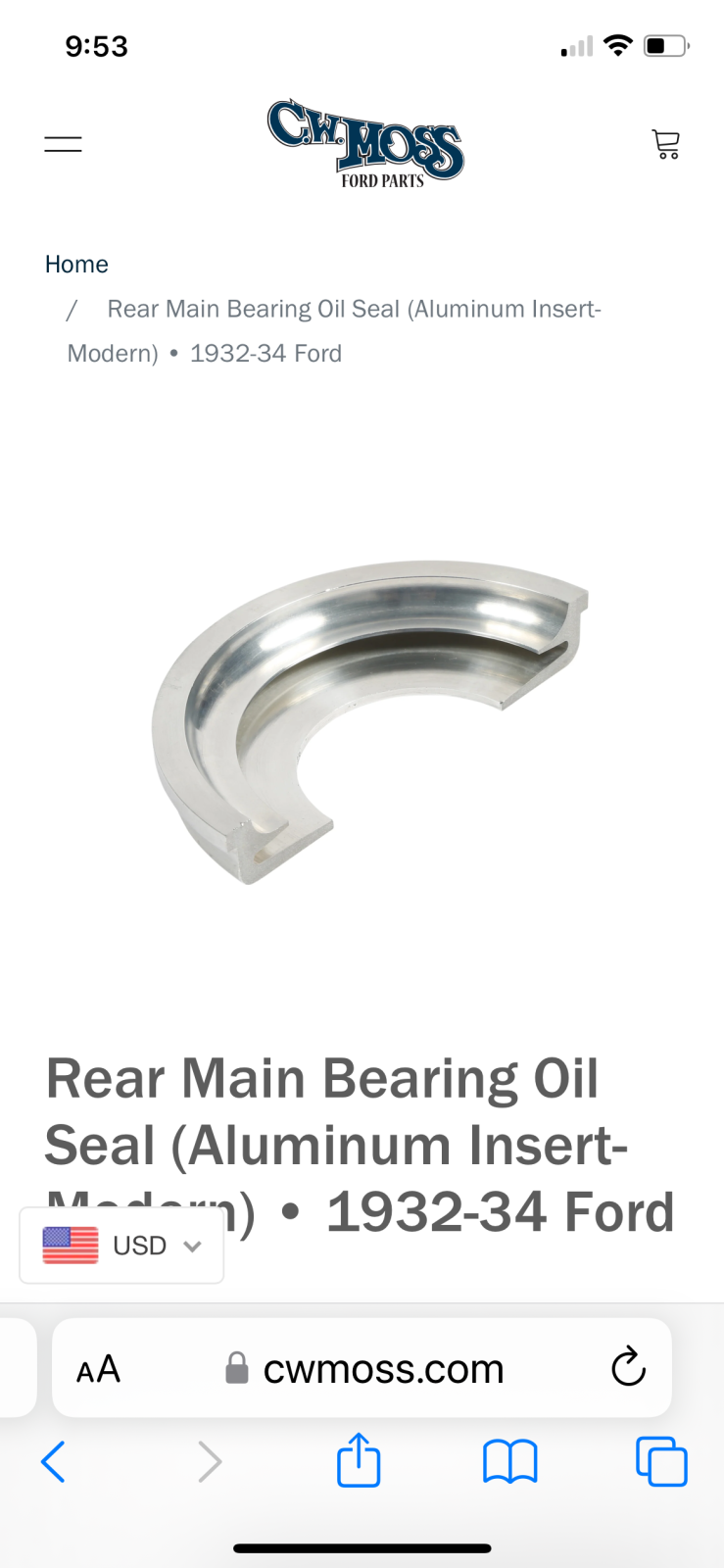

    IMG_8141.png IMG_0420.jpeg IMG_0421.jpeg IMG_0422.jpeg Recently, I had the same exact issue with my B engine. Leaked oil everywhere from the rear and after pulling the engine, I learned that the engine builder owning it before me forgot to install the rear main seal in the block.
    I installed the RMOS insert in the block and it never leaked again.
    I was running a B with high comp head and dual carbs. I’d suggest making sure you have the B oil breather tube also, The B tube is larger diameter than the A. B tubes are hard to find.
    https://cwmoss.com/products/rear-ma...rt-modern-1932-34?_pos=8&_sid=67c869758&_ss=r

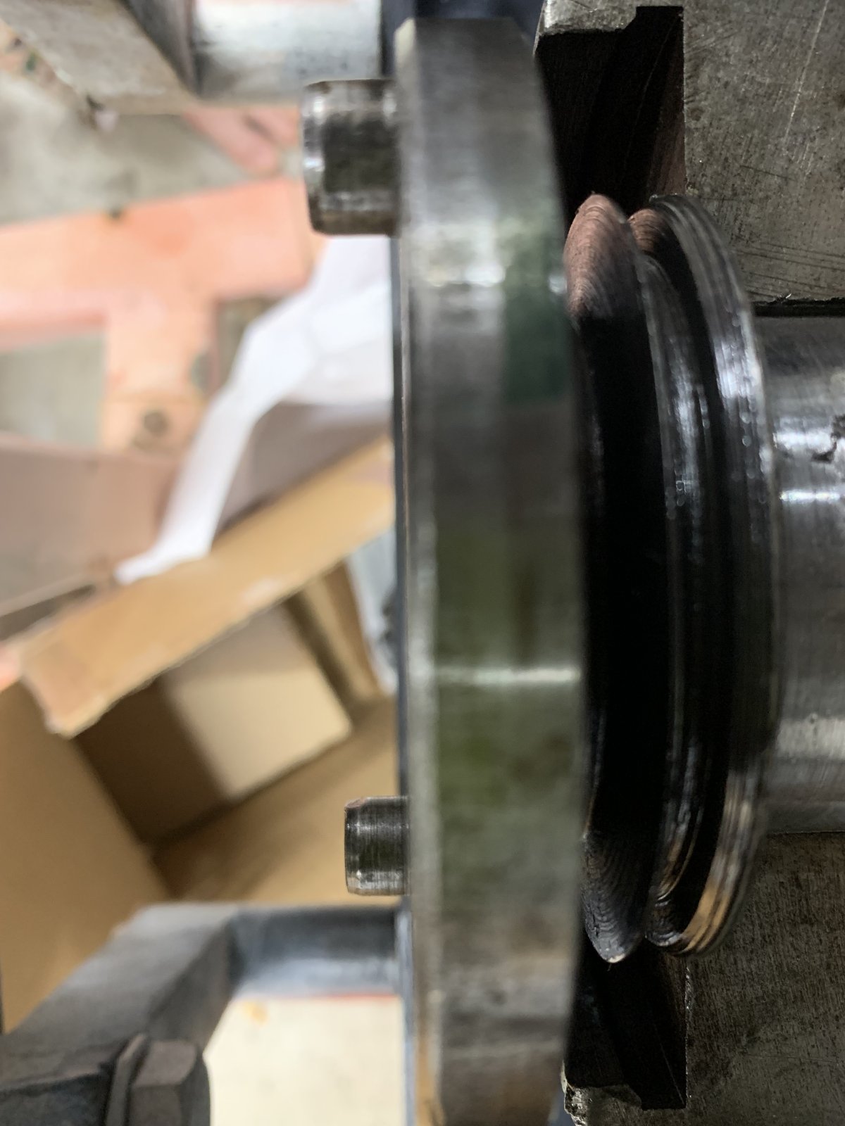

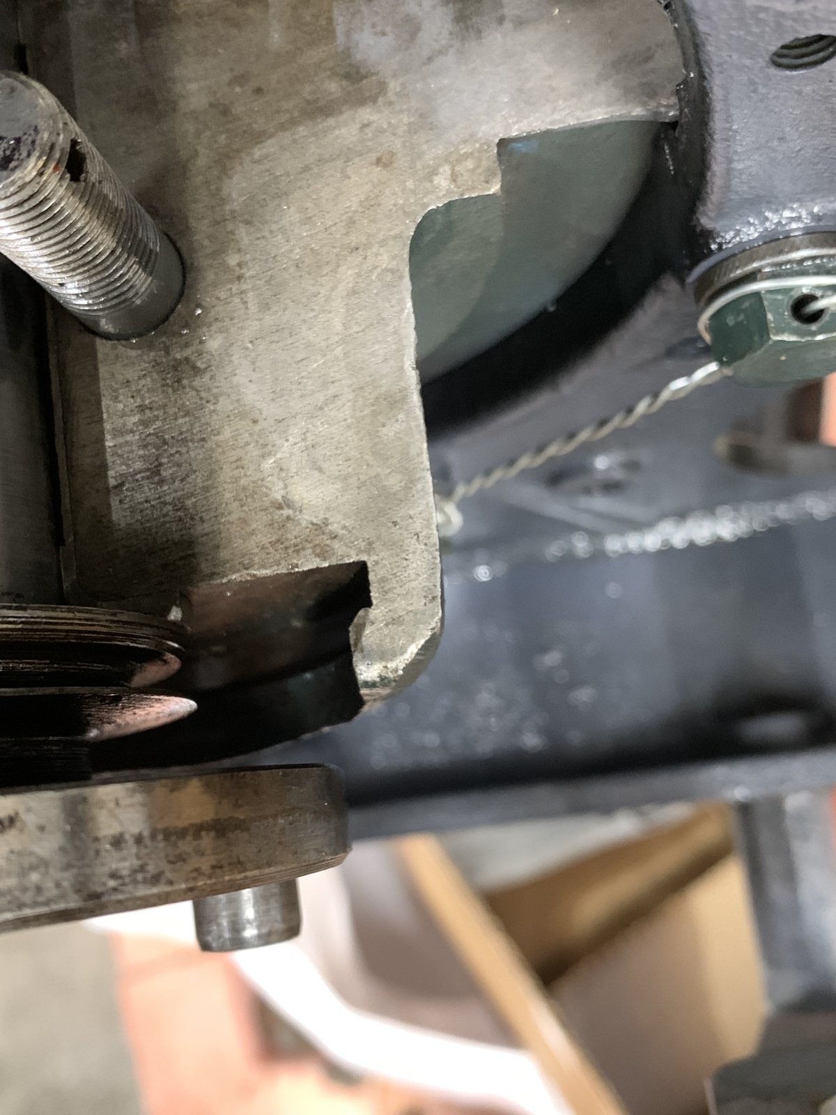

    Not being able o see what the rear bearing and seal look like, it's hard to say if it's actually the cause of the leak. It looks to me, however, that the amount of oil leaking out is too much for the common rear seal leak. I'm betting on the leak is coming from the rear cam bearing. The gasket between the engine block and flywheel housing may be damaged or missing. Also, the "B" oil pan must be modified to use in a stock Model A. In doing so it could have been damaged at that point.

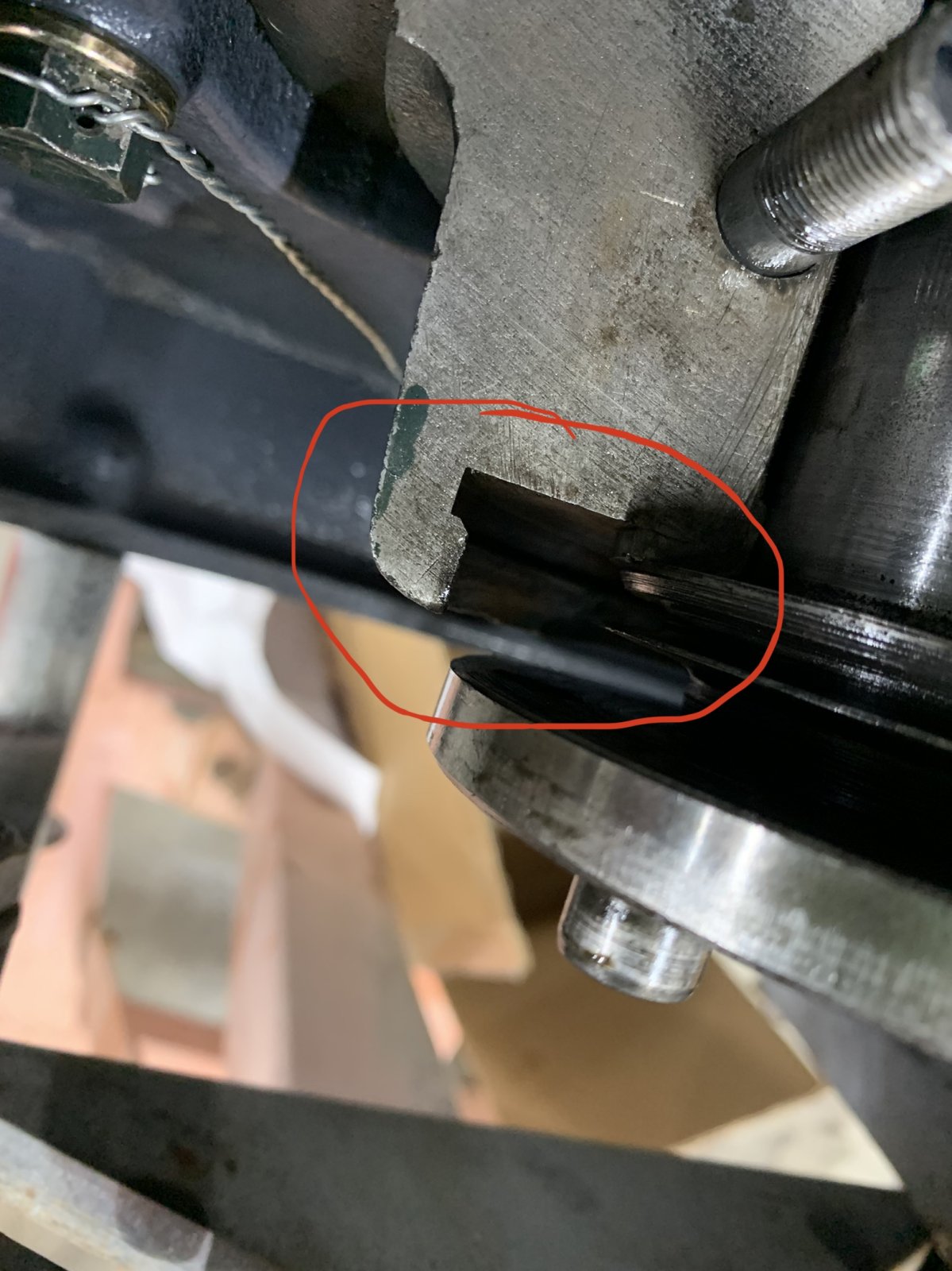

    If you don't have the seal part shown in the CW Moss picture, that's a big problem, and probably the only problem. It's a must have for the slinger to work properly. It's possible to install it without pulling the engine by just rolling it in around the crankshaft. If you have to get help with your engine and can't find it in Vegas, take it to H&H Flatheads in the L.A. area. They specialize in such things.

    Do you have any pic of the crank with the rear main cap off ?
    has the oil slinger been turned down or cut off for a modern style seal ?
    if the oil slinger has been turned down , has all the burrs been taken of and edge rounded ?
    I have seen a lot of the modern seal cut and nick when being installed
    does the rear main have shims ? were the shims push in close to the crank to seal any oil leaks
