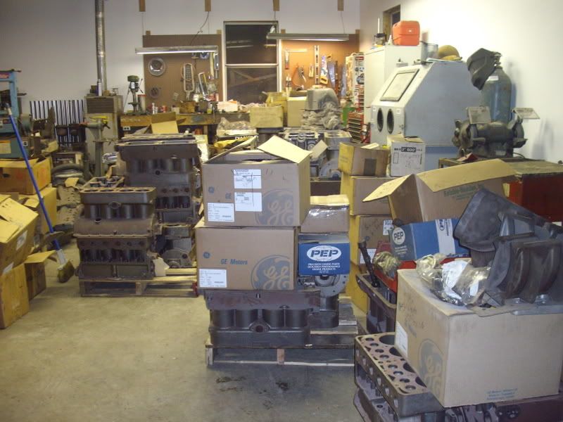

    hi all...thought this would be a good place to post these. some recently aquired engines and parts. i hope to have some finished engines available soon....

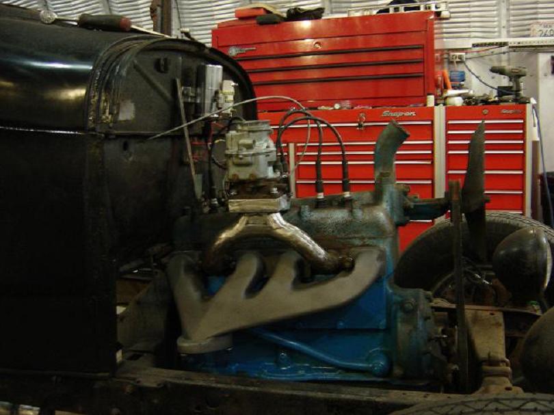

    Willys 134ci engine from a CJ3.
    This one only has a mechanical advance but some models have a vac*** adv as well. The body is just a little to big ~.040. The shaft lenght will be nearly perfect after the off center tab is removed and a off center slot is made to drive the oil pump.
  6. Petritl- Keep us updated. If it works out for you I'll be trying it in mine.

    I am going to a friends tomorrow to turn the distributor body down. This should be the last big hurdle I need to cross before I can put the engine on the run stand.

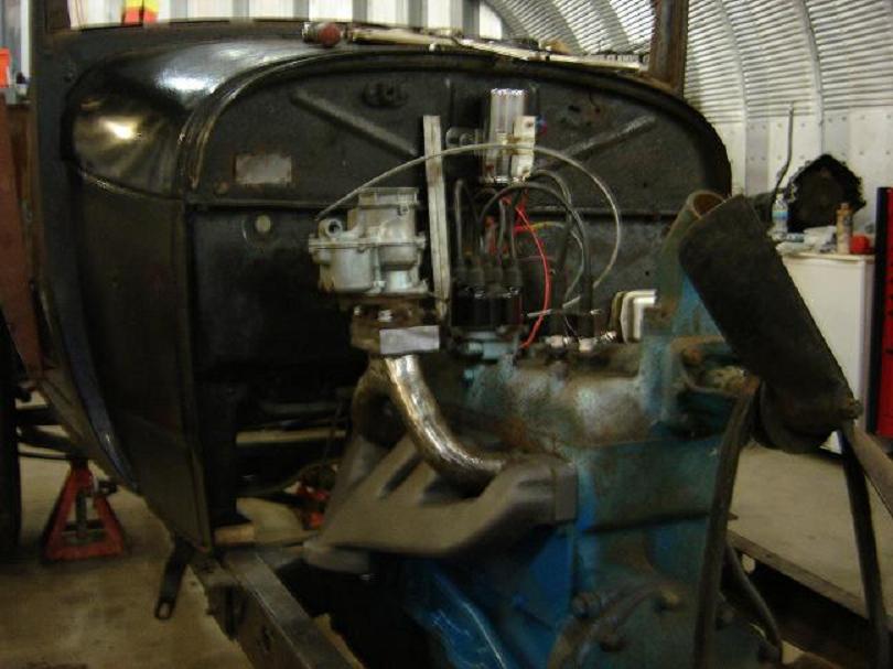

    Converted my stock updraft intake to downdraft with a Stromberg 94 on top.
    A good friend got me the cast iron header for christmas.

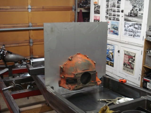

  15. As far as the rules for the SCTA are concerned... You need a shield for the flywheel, i.e. "****ter Shield" that is SFI 6.1, 6.2 or 6.3... so, we're going to buy one for the flywheel which is on the back side of the aluminum motor plate (which goes between the adaptor we made and the ****ter shield. So, we're legal!
    Here's a pic of the motor "mid" plate installed...
    Sam
    The orange bellhousing will be replaced with a ****ter shield.

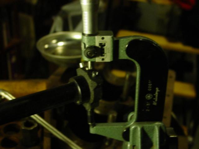

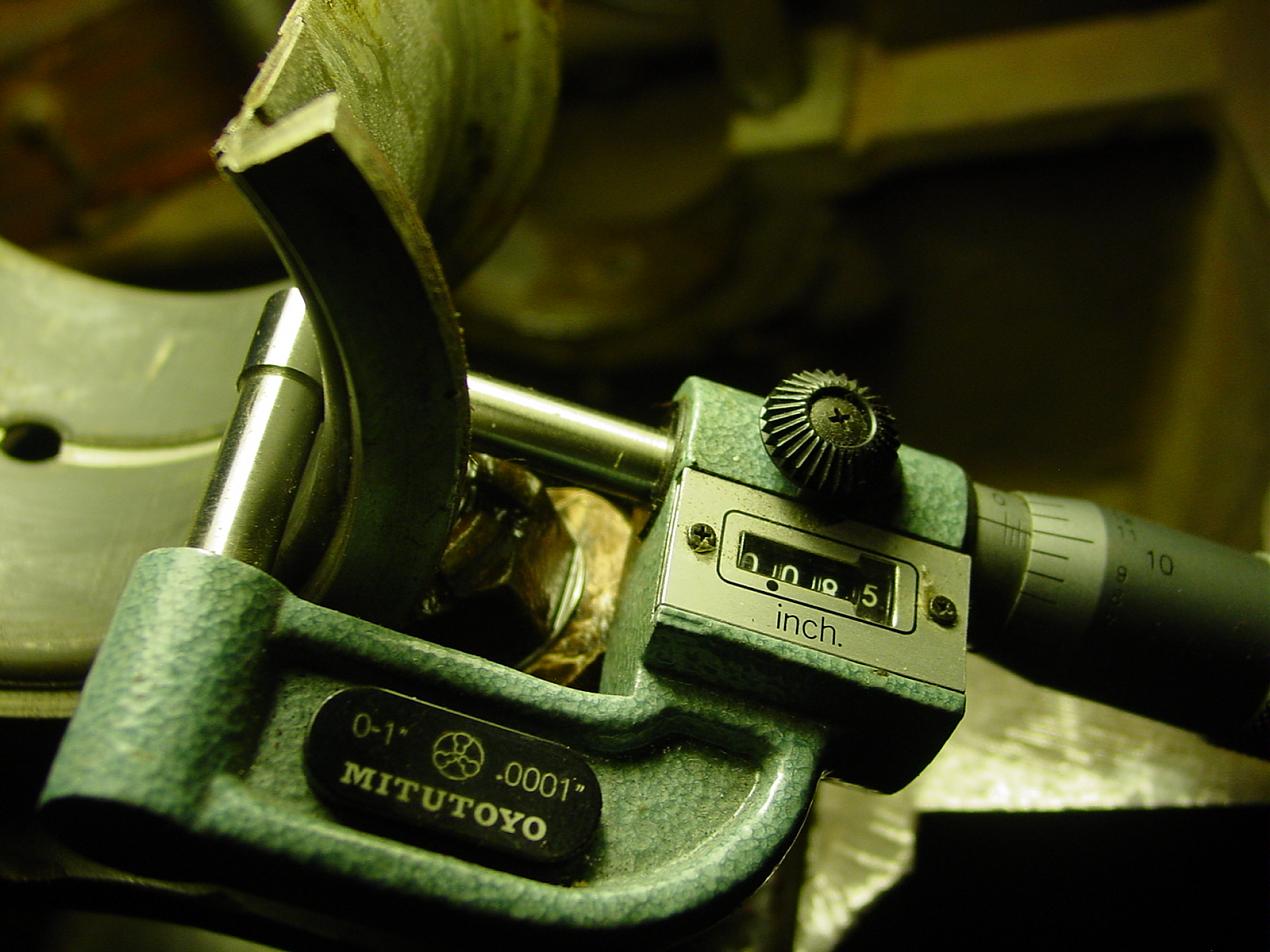

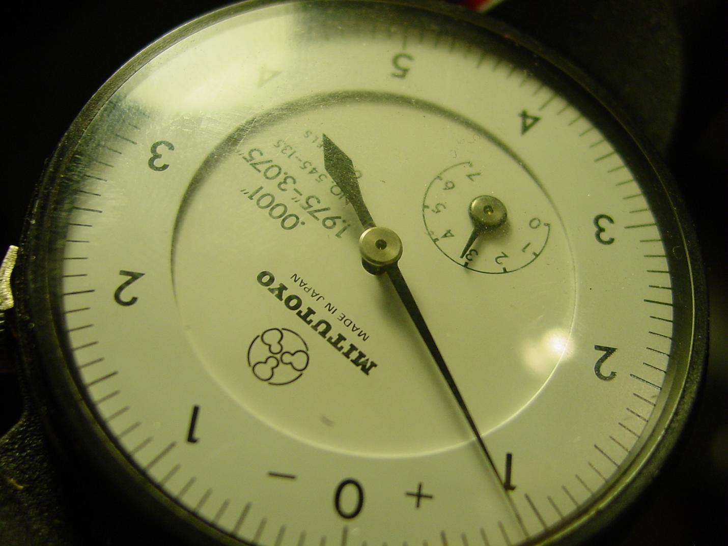

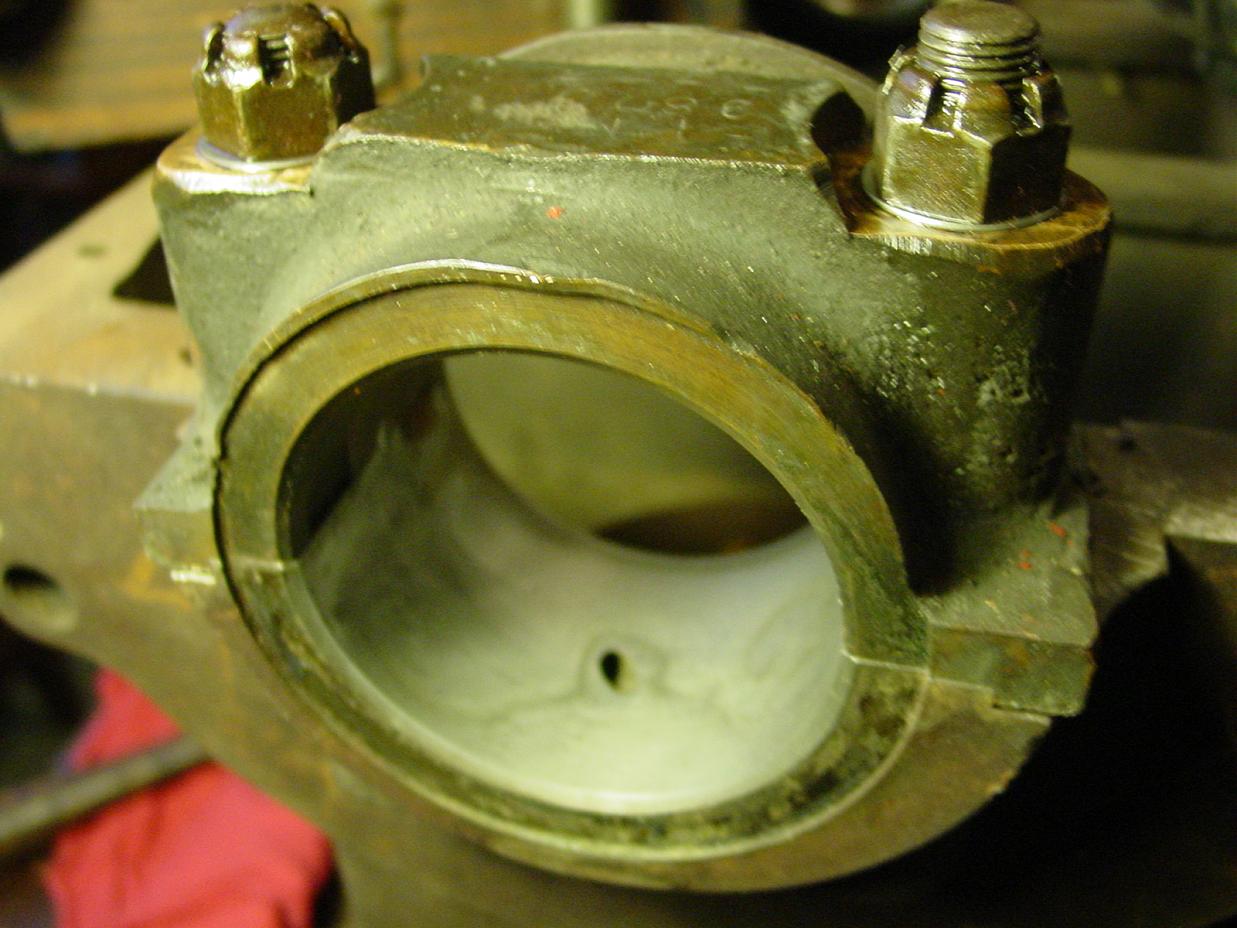

    This is how I'm working thru the bottom end of the 5 main block. I know none of you will ever have to do this on one of these (I have two) but may help you somewhere along your engiine building life.
    I cleaned the cap and block up. There was a lot of old sticky stuff inside both parts
    Then fit a snap gauge in to get some place to start.
    Mic'd the gauge and fit it to a stand
    Then the self centering bore gauge is set up to that measurement

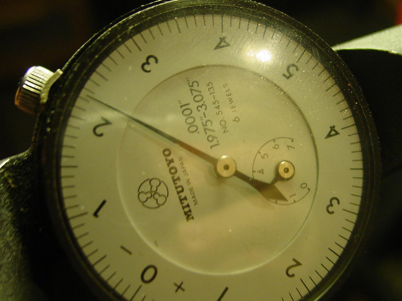

    OK Here you can see the main bores are anything but round. Each number on the bore gauge is a .001. Each little line .0001
    Next step is to measure the bearing shells and see how thick they are

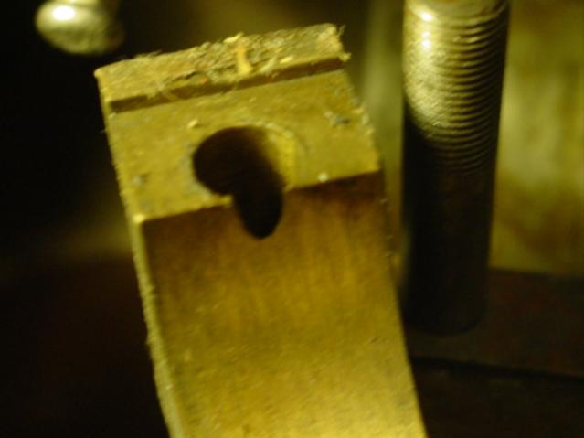

    turns out .077-.085
    My guess is these bearings were 're-sizable' They aren't an even thickness
    When the block was bored for these bearings for the 2.500 crank they went way into the maincap bolt bores.
    Next step it to fit both bearings in and see what the actual ID is.
    We are only going to use the old upper main bearing half as a spacer.
    We'll make new caps fit them and line bore the old upper bearing half in the block. The new caps will be the OD of the new bearing as will the old shell. So the new cap holds the new half and the old bearing will hold the new bearing top half. The new cap also holds the old top half(now just a spacer). It the machine shop do their job right well have a straight set of new mains. We'll install the bearings and measure the ID..... check for round and tell them the size to grind the crank too
    The loads and therefore the heat are greater on the lower half of these mains than the top half. Heat transfer is much better without a spacer. So the new caps do many things. They don't have damaged stud holes. They retain the old bearing half in the block with crush. We have a straight main bore of correct size. AND the new caps are 4 bolt blocks of steel. We sleeve the outer bolt hole so the cap location is repeatable
    Honest once the crank turns we just have to design the con rods and pistons. Then on to getting the oil system to work while I wait for a couple months for these to arrive. And fix years of ch***is abuse!!
    May seem like a lot of work, but the effort here makes up for 'broken trackside' after a long day's tow to the track.
    Have a good New Year everyone :)

    The distributor was dis***embled and chucked the distributor body in the lathe and turned down the stub .040 to .996. The distributor will now fit in the head. The shaft of the distributor had a off center tab that engaged the oil pump drive. I needed the shaft to be a 1/2" shorter and a off center slot. The shaft was chucked in the V. mill and the bit was centered on the off center tab. The tab was then milled off at the same time the new slot was made; .025 at a time. The distributor is now ready for use.
    My next big hurdle is waiting on the lightened flywheel.
