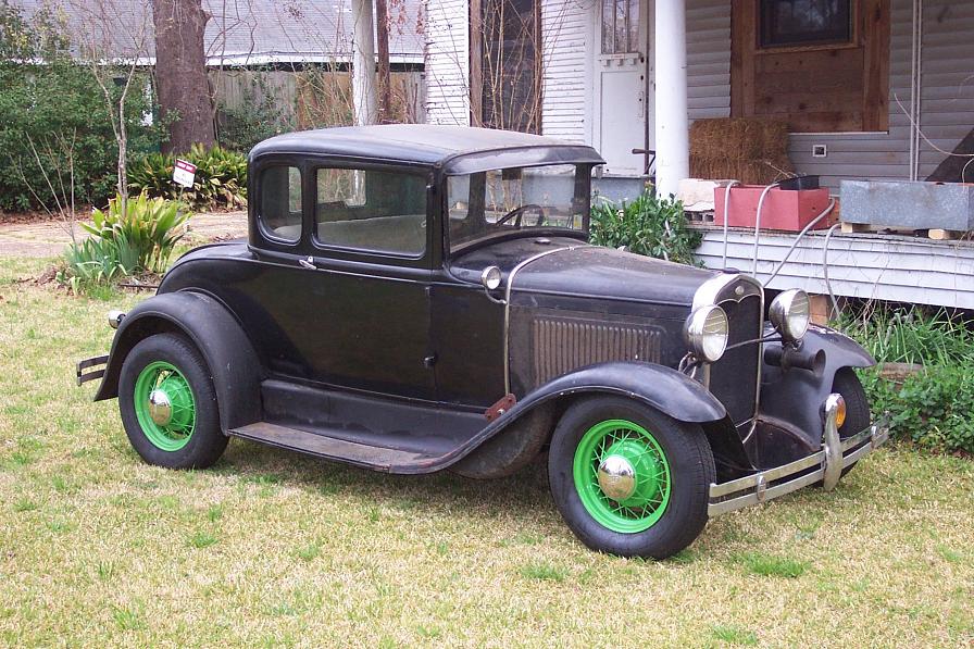

    I am building a stainless steel header which will use 2 SU carburetors.
    Exhaust will be stainless and straight through to the back bumper, no muffler.
    I've been driving this one 10 or 12 years.
    The original engine has been balanced and has fresh babbit, a new bore with a hi performance Bill Stipe cam, and a 7:1 Lion speed head and 12 volt, one wire alternator, and Pertronix ignition.
    .The transmission is a fully synchronised 3 speed with overdrive.
    The brakes are 1940 brake drums with 2" shoes and self energizing, self adjusting 75 chev parts on 1939 Lincoln backing plates.
    I got rid of the useless rumble seat and now have a nice useable trunk with a dropped floor.
    The metal insert in the roof has been fitted so that the original weltline is visible.
    The front axle is dropped, the rear spring has been re-arched to lower it.
    The steering box bushing has been replaced with needle bearings and a grease seal.
    The 16" tires on powder coated rims are only one inch wider than the original 19's but were made for the all-electric RAV4. They were designed for low rolling resistance and long life and have the benefits of being steel belted radials.

    Which SU's are you planning to use, Manyolcars? A few of us over here have toyed with the idea of an SU or two. :)
    That's certainly a very nice & well-sorted coupe by the look of it. Have you got any pics of the brake set-up? It sounds really interesting.

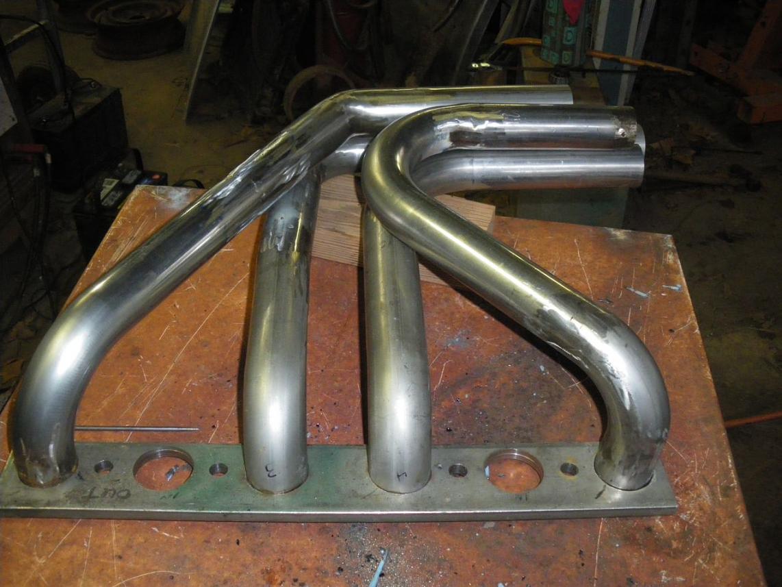

  28. Had some spares so I started building this
  29. CoalTownKid
    Joined: Mar 12, 2005
    Posts: 2,024
    CoalTownKid
    HA,ha,.... That tubing configuration looks familiar, I know what you're building! ;)
