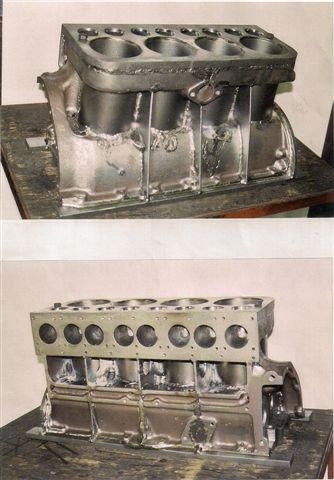

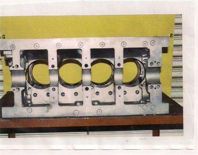

    Thought you guys might like to see some pictures of a modified model A motor. I believe the owner plans on running in V4F at El Mirage. The deck has been replaced with a 1 inch steel plate. The port face replaced with a 1/4 inch steel plate. All cylinders are sleeved with the numbers 2 and 3 cylinders moved to accomadate the 5 main bearing crank. Pretty racy don't you think?

    That's incredible, Rich. Any more info?

  18. RichFox
    Joined: Dec 3, 2006
    Posts: 10,020
    RichFox
    All I know is that it uses a Miller crank and several people don't want to see it running in V4F at the lakes. Me included.
  19. was curious as to your stance on that set up. per your comments in the past, it would distinctly fall outside of the "spirit" of the V4F cl***. As it really is no longer a period motor of any specific make.

    Rich, is this the one that there was so much hul a bul lue about?--TV

    Well, We will let you all think that, that was our backup motor. Our #1 is a lot different, it's a B and the one in the book is an A.--TV

  27. RichFox
    Joined: Dec 3, 2006
    Posts: 10,020
    RichFox
    Tom; Aparently this is the motor that all the hul-a-blu is going to be about. Roy sent me the pictures and said it's comming up. Looks like an interesting new home made motor with some Ford parts.

    The first one a couple years ago was, I think< pretty much the same thing but the cam was mounted in a case outside the block so that it used rocker arm type followers to get a good high lift ratio. The out of block cam was made illegal and I guess this is the answer.
