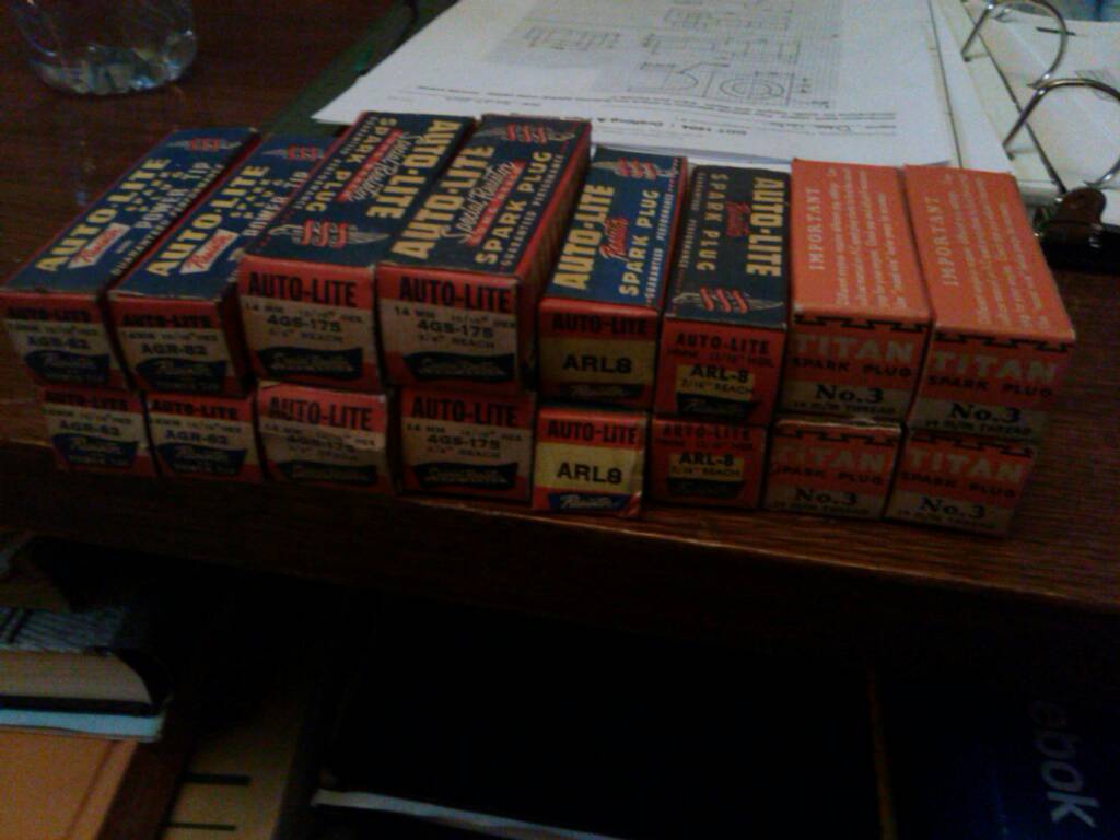

    Anyone know what the original plug application was for a Super Winfield head with 14mm plugs?

  24. Carter
    Joined: Mar 18, 2006
    Posts: 1,533
    Carter
    I've got a bunch of NOS 14mm plugs. If you can figure out reach you need maybe one of these would work.

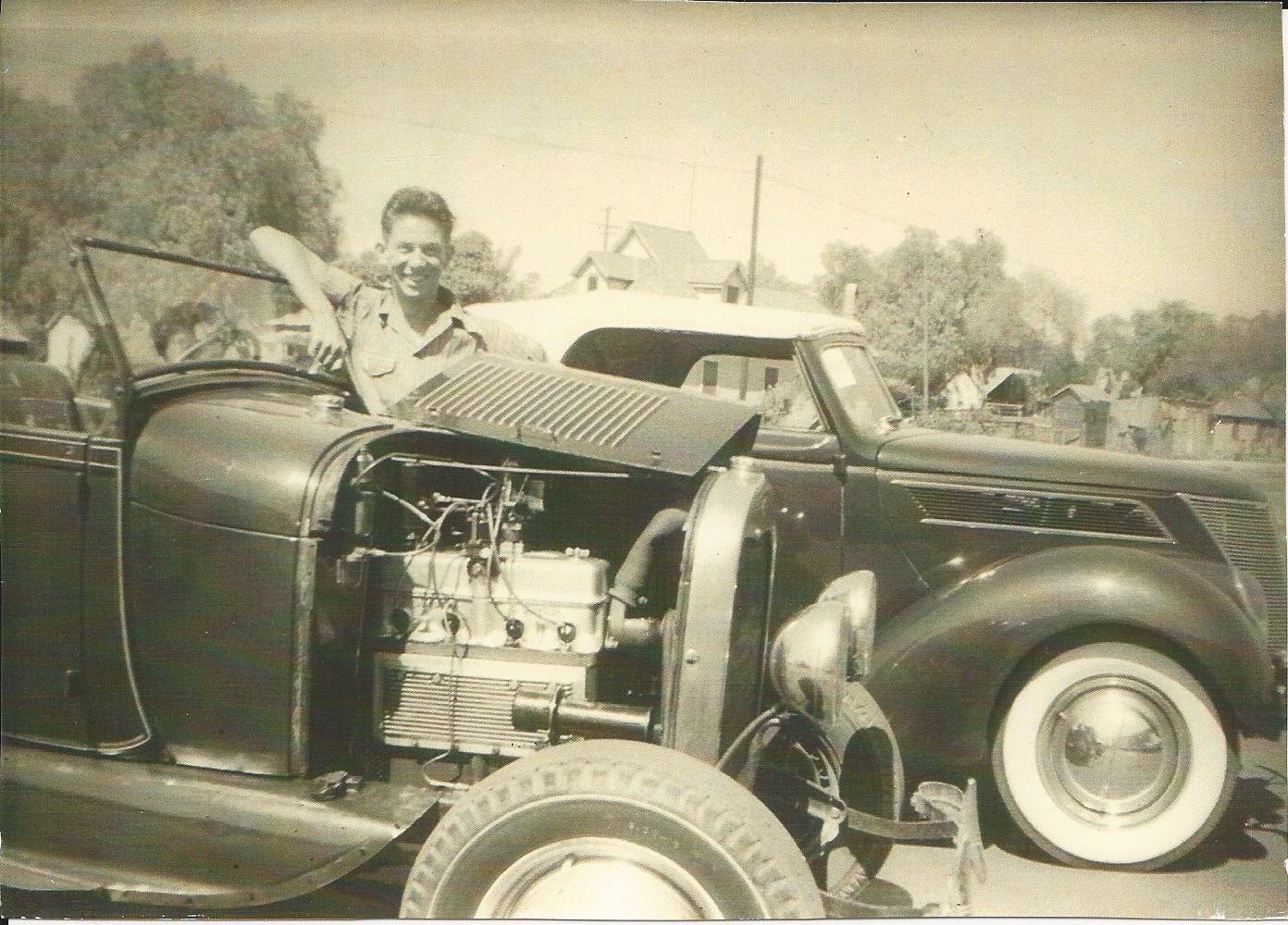

  26. rogeroadster
    Joined: Dec 24, 2007
    Posts: 164
    rogeroadster
    from Corona, CA
    For those of you who know the different OHV conversions, what conversion had both the intake and exhaust on the left side? This picture was taken in Corona, CA, sometime in 1938 (which would make the '37 in the background a pretty new hot rod). I'm wondering what the OHV conversion is. Anyone have any ideas?

  28. Named Aristocrat, by Alexander Automotive Eng. Inglewood Ca.
    J

    Looks like an Alexander.

    The Alexander is a unique head that had a steel face plate cast integral to the aluminum head.
