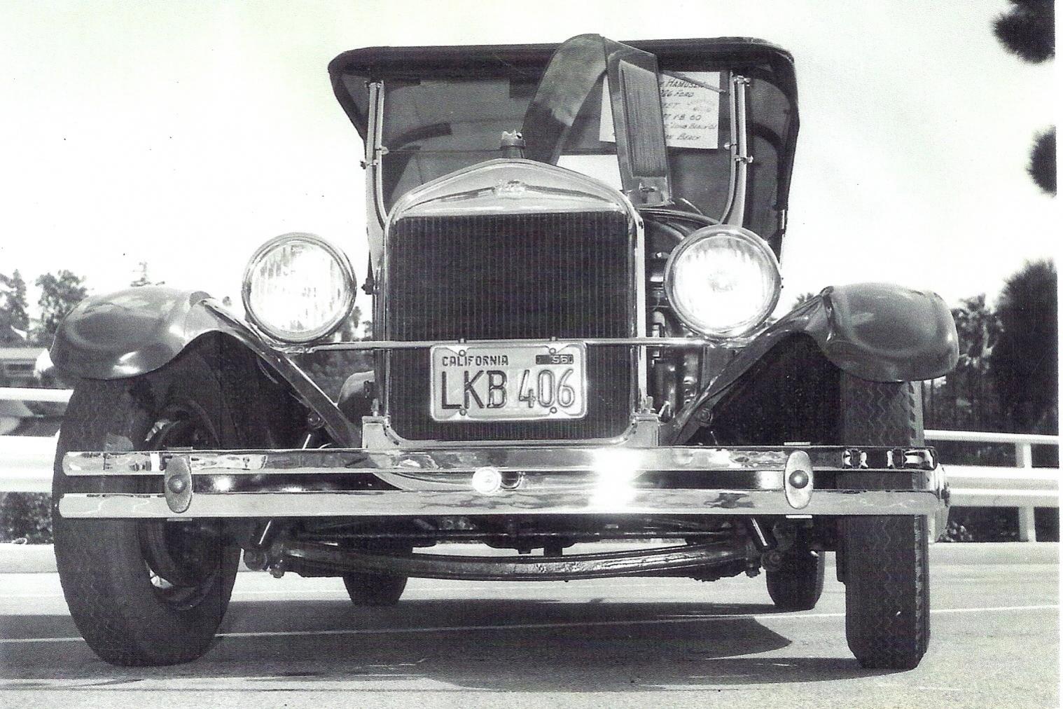

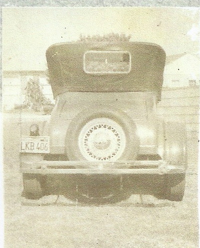

  3. This roadster was my high school buddy's '26. I have posted pictures on other forums but maybe not here on the HAMB. Pictures were taken (by R&C Magazine) at the second LA Roadster show at the Hollywood Bowl in 1961. It had a V8-60 in it. It was just the perfect traditional roadster at a time when SBC's and mag wheels were king. I am currently building one inspired by it only with a banger in it.

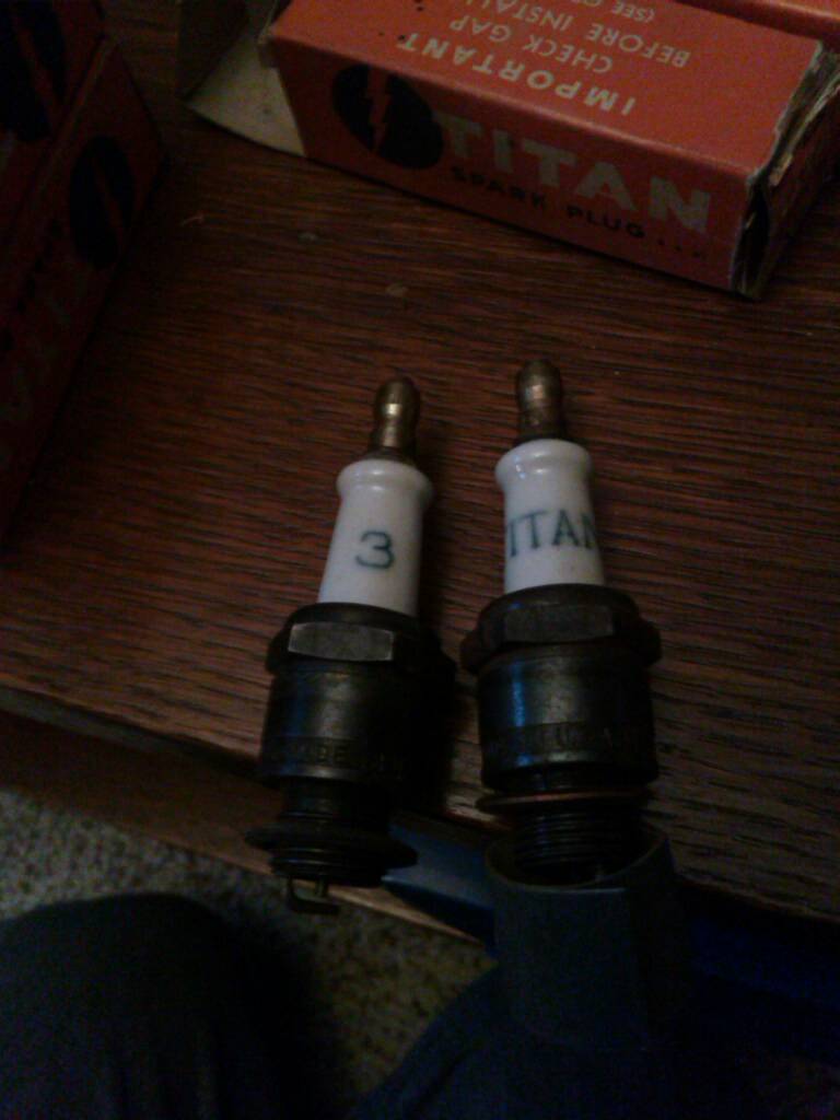

  4. Thanks guys. I ordered up some new plugs in the different lengths so I can figure out what exactly I need. I should have those monday. Thanks for all the help. I really appreciate it.

    Autolite plugs are manufactured black. Look great. Try XS 4093 (14mm) or 3076 for an 18mm head
  15. Wow!! That's a great pic of an actual Alexander in use! Thanks for the inspiration.
  16. I started out with Champions but while sorting out my engine I had fuel fouling problems. When I switched to NGK problem seemed to go away. possibly tuned away but just never went back. I use the exposed tip style. I have used the R's but no apparent advantage in my engine. I once went to a local "high performance" shop and asked for the NGK R's and the clerk said you buy those at Pep Boys. LOL I made some brass caps styled after the aftermarket ones sold by restoration supply stores. If you look real close you can see the brass caps under the wires on the plugs

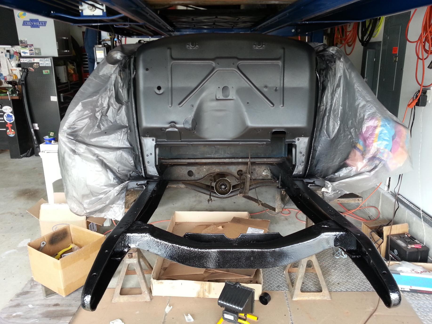

    I need a little guidance. I am dropping a B engine and B trans into a 31 Ford Roadster Deluxe. I bought the Brattons conversion kit for the pedals, clutch, ebrake......
    I thought I had done my homework (searching the Barn and HAMB) and was set.
    I just read on the Barn that I will need to trim the crossmember and shorten the driveshaft to get the B trans to fit. That new info messed up my day a bit!
    Does anybody have details on what exactly the necessary alterations would be to fit to B engine and trans into an A?
  19. Not sure exactly what you read but I have an A motor with a B trans in my 31 roadster and it fit with no mods to the crossmember or driveshaft. The A and B motors are the same length.

    I used a 32 k member in mine, but dimensions are same. B eng, B trans, using A front mount, stock uncut A torque tube/driveshaft.
  22. This is what I did also but even without the 32K member the length is still the same. I dont think the B transmission is any longer. The A has a bellhousing so if you put the bellhousing on the A transmission and measure them they should be the same. The B transmission has the belhousing attached.
