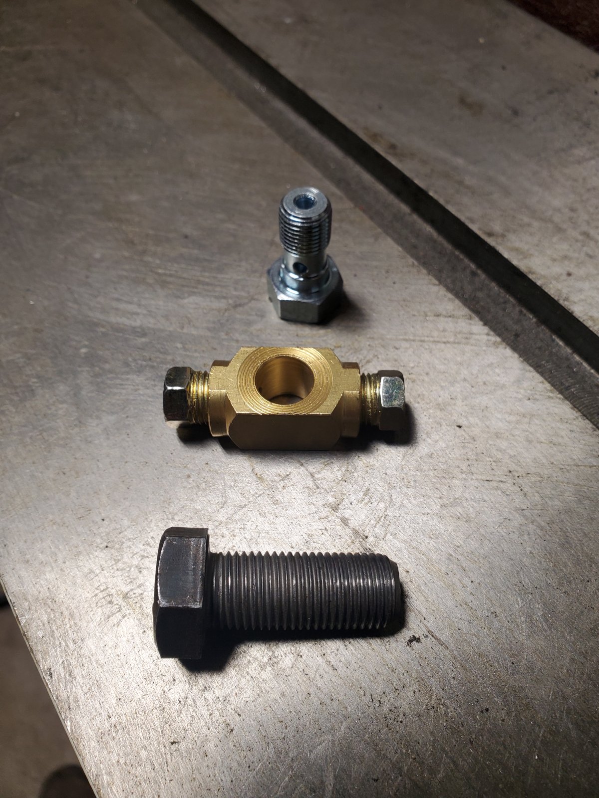

    I just went through this same ordeal on my build. I ordered what I thought was the right block and bolt from a parts source, but it was the wrong size. So I just decided to make my own. Not a simple task, and one needs a lathe to do it. Just want to post that it can be made. Might not be in your plan though.
    Personally, id pick the one up from Summit that was mentioned above, but call first and make sure it's a 1/2". I have one on my 62 willys pickup but didn't want to disturb a good working hydraulic system to check.
    Pics of what I made.
