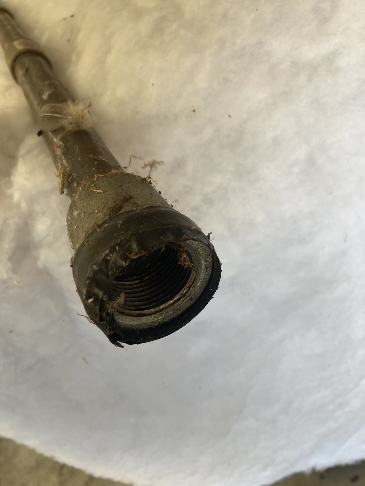

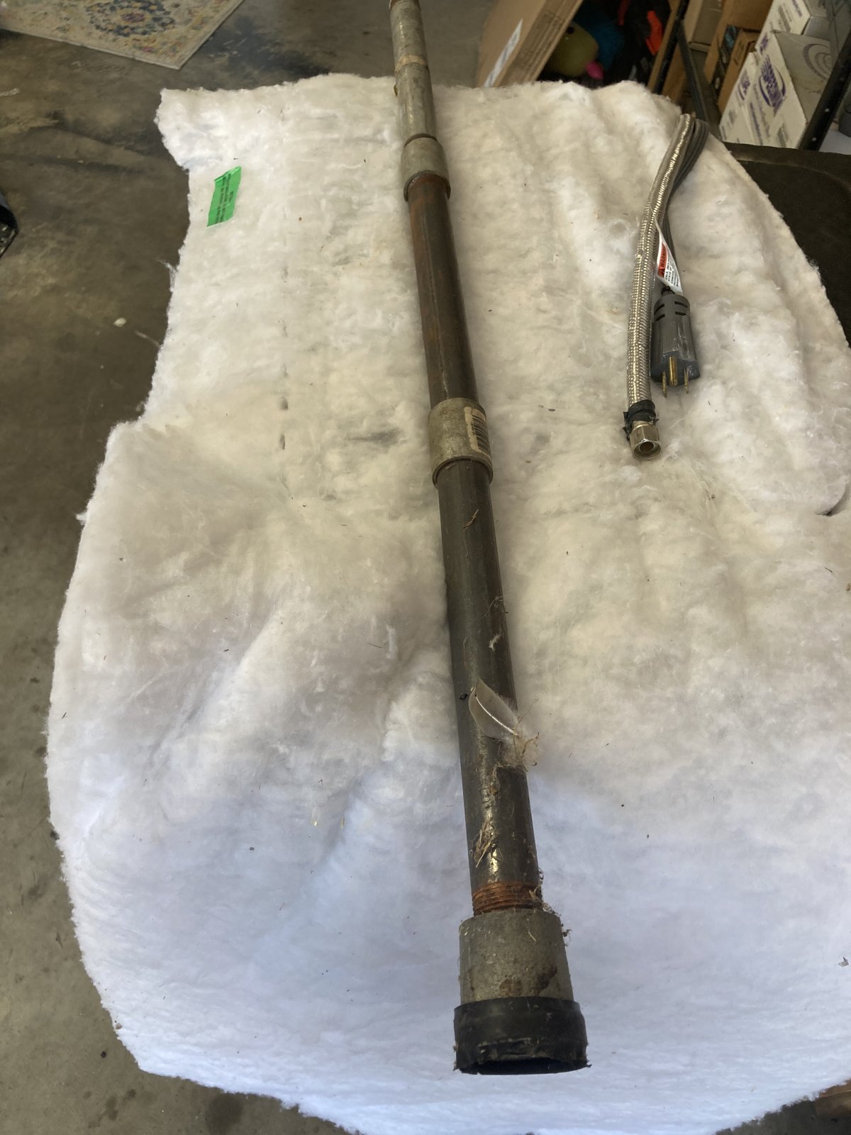

    72414213-BDCD-456C-A278-D074B480C9E7.jpeg 4D494FB9-42EC-44C3-A97E-308A9121D998.jpeg ADBBF59C-2790-406C-98EB-AFB296901764.jpeg
    @alchemy Here’s the tool, basically a long driver made from threaded pipe. The tape on the end had the seal driver taped to it, the one in the picture. I guess the seal driver fell off at some point when we moved.

    The little part from the Early Ford Store, does the sticking out part hold the seal as you are lowering it into the housing? A snug fit?
  14. Dan Hay
    Joined: Mar 16, 2007
    Posts: 6,424
    Dan Hay
    No, that's what made it such a booger. Had to kinda drop the seal in there, use the driver to get it square in the bore, then try to tap on the end with the hammer praying the seal doesn't go in sideways, which it usually does. I'm sure old timers had a better way but this is what I came up with.
