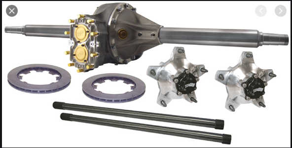

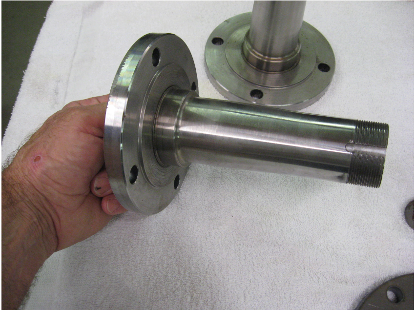

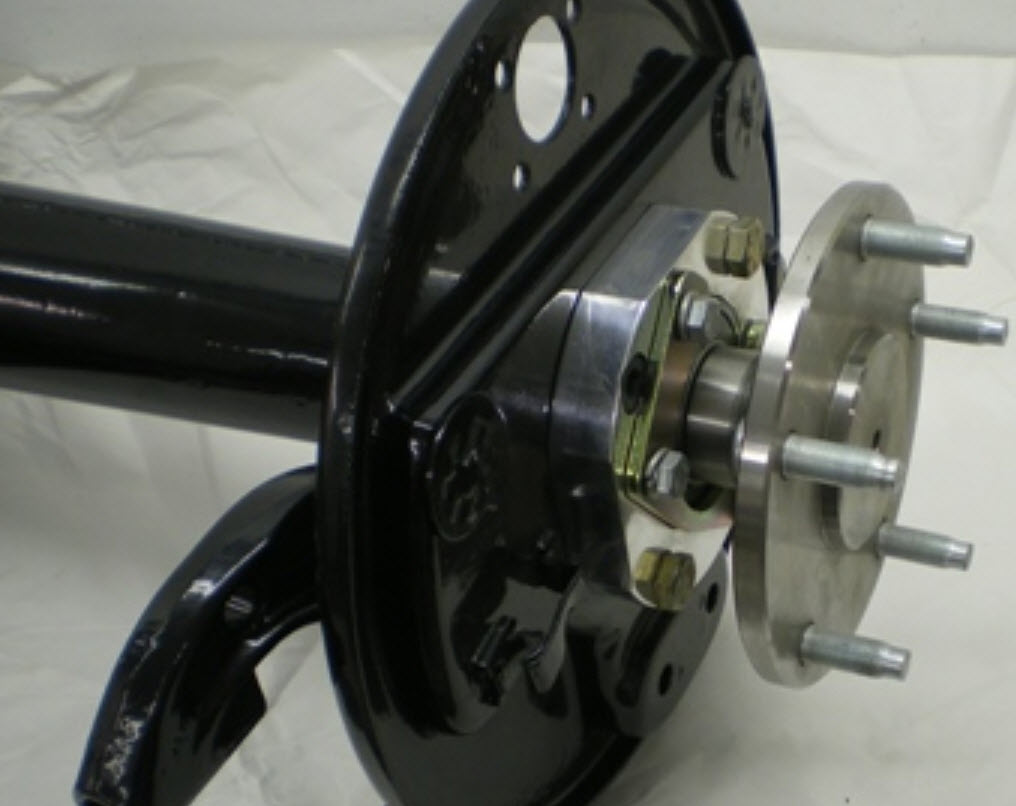

  3. An old stock car trick I have seen some drag cars do it as well.
    Was to use bolt on spindles(in the early days they would cut the ends off a 3/4 rear and machine the which is what I did.) and 12 spline 3/4 Ford axles and hubs sometime 8 lug but usually stock Wide 5s or Safety Race Engineering (S.R.E.) hubs.
    I think there was an after market spool that had 12 splines and fit the banjo ring gear.
    My S.R.E. hubs and bolt on spindles I am running a Champ Q.C. or 10 spline. I have two Frankland spinldes for the front of my project.

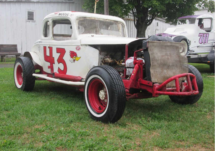

    Kerzon "Moose" Carye 34 Ford with V-8 or 6 splines as we oval tracker call it.
    Owned by Dick and Jeff Ackerman

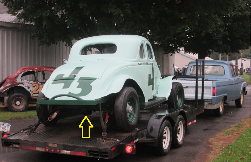

    Gene Cole 43 replica note the stock banjo center section and 3/4 ton hubs
    Built and owned by Dick and Jeff Ackerman
    Note most tracks required the use of a "safety hub" on the right front using the same method.
    Frankland stopped building bolting on spindles long ago, they show up from time to time but you need to be careful the are often bent
    This photo was post by @Marty Strode he and @GearheadsQCE should be able to shed some light on the subject
    Check out this thread-https://www.jalopyjournal.com/forum/threads/has-anybody-made-a-full-floater-banjo-rearend.949982/

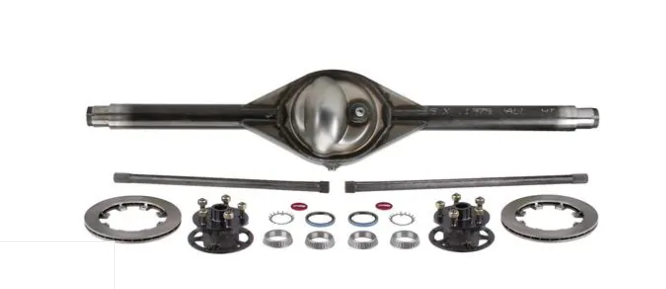

  6. Hot Rod Works has parts to convert the axles to a spline (like a 9"). Also there have been posts on here about doing it with stockish parts, but those parts are really hard to find now.
    Automotive Stud and adam401 like this.

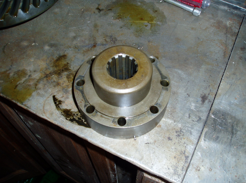

  8. I think this is the 12 spline (3/4 ton) axle to banjo ring gear spool posted by @Shaun1162
    Okie Pete and adam401 like this.

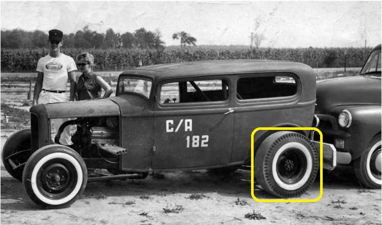

    On pics of dragsters in the days when 180 was the goal you can frequently see the stock Ford axle ends sticking out in the wind, looking ready to slice the flagman in half...

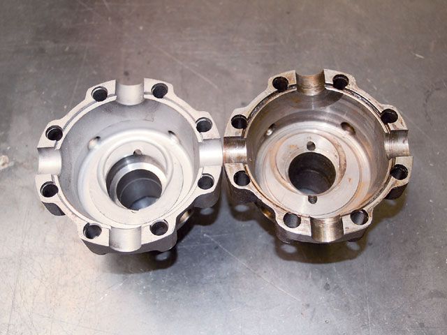

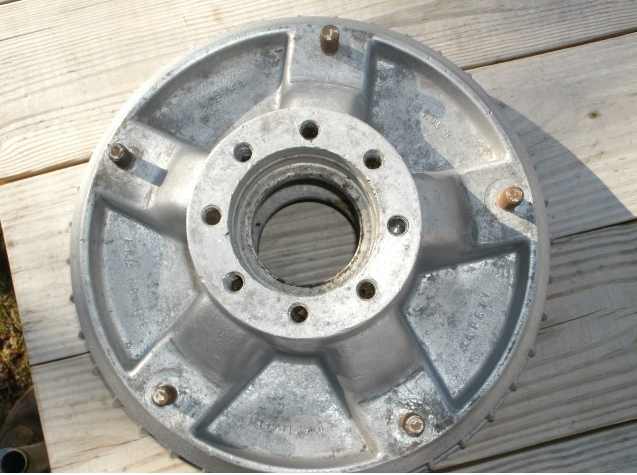

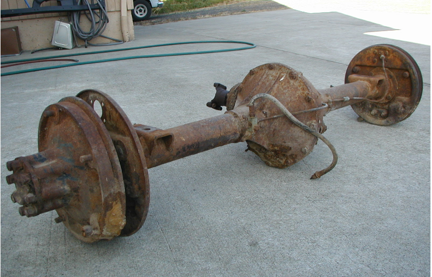

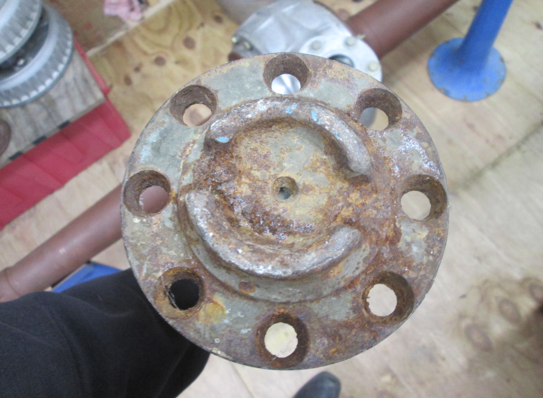

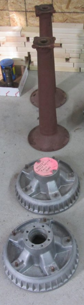

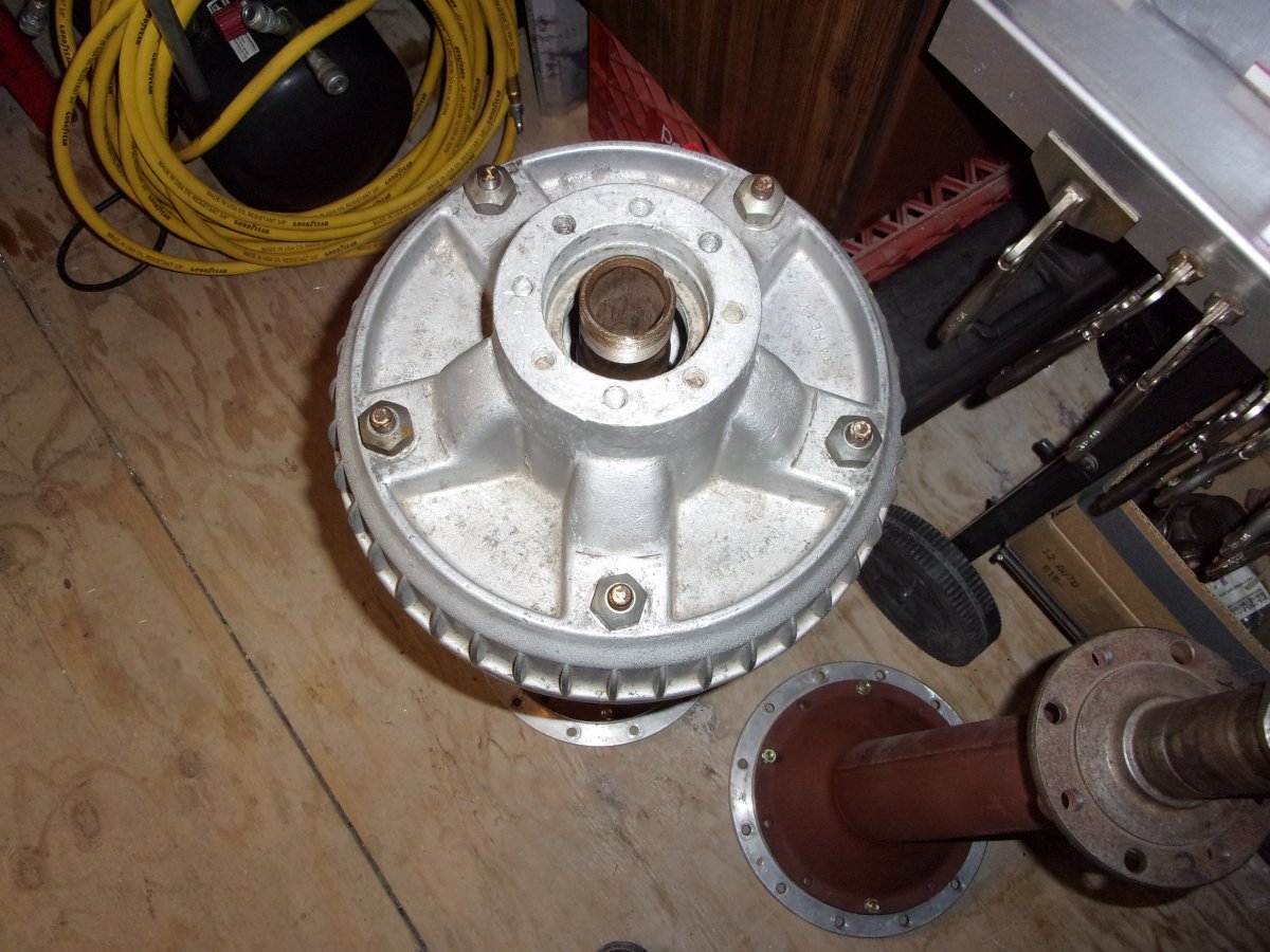

  10. These are the 12 spline 3/4 ton axles used in the Timken split floater. Ford and Studebaker both use them.
    Ford used started using them in 1937
    I don't know the years for Studebaker.

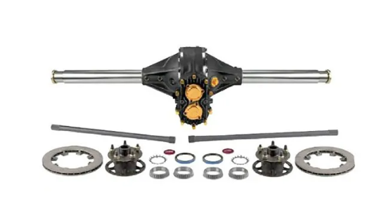

    The stock Timken floater rear this was a common set up in stock cars from the 50s through the 70s
    It is the base for the big 10 spline or Champ Q.C.
    I have seen them use in drag cars mostly gassers. They are heavy the axle tubes are a 1/4" thick!

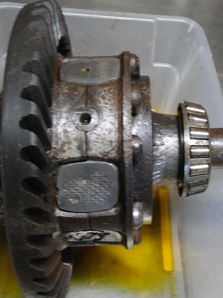

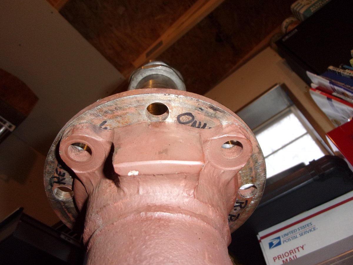

  16. the shadow
    Joined: Mar 5, 2005
    Posts: 1,105
    the shadow

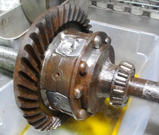

    I restored a pre-war midget a few years ago and it had a narrowed model A rear banjo, when I split the case's i was surprised to find out it was an early locker rear, locker meaning they poured lead into the spider gears to make it a locker, early back yard hot rodding.

  17. Bruce Lancaster
    Joined: Oct 9, 2001
    Posts: 21,681
    Bruce Lancaster
    The brass-faced screw was standard on Ford big truck rears, so the idea was right there in for the taking!
  18. GearheadsQCE
    Joined: Mar 23, 2011
    Posts: 3,670
    GearheadsQCE
    Alliance Vendor
    So much for low rotating and unsprung weight.:eek:

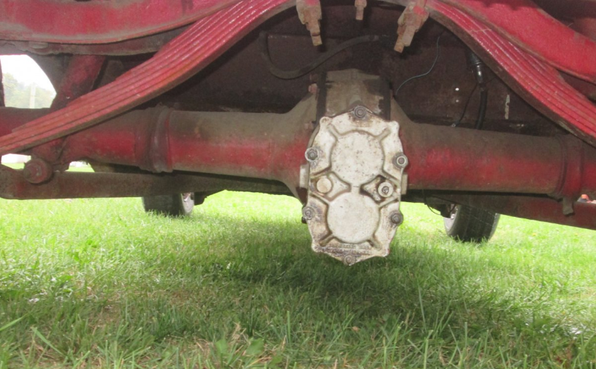

  19. Pete1
    Joined: Aug 23, 2004
    Posts: 2,262
    Pete1
    from Wa.
    I saw a couple of those over the years.
    The easiest way to lock one of those was the 5 gear method. No welding or mods to the whole case and very simple to put back stock if need be.

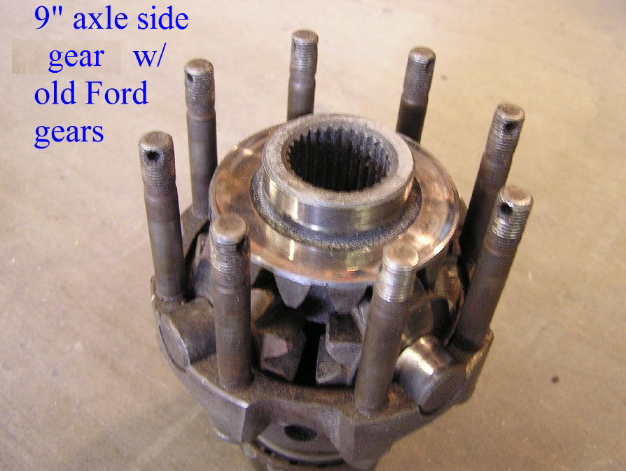

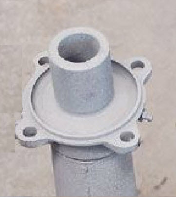

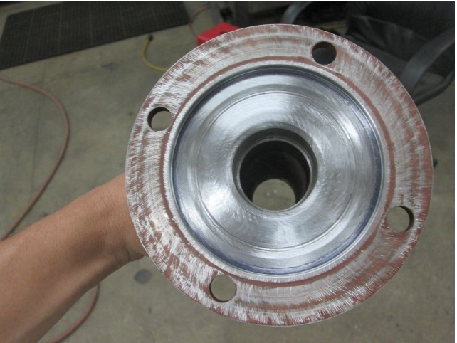

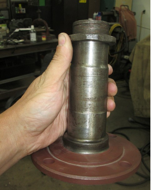

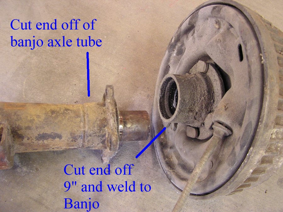

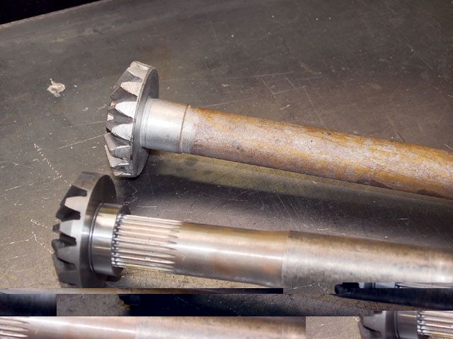

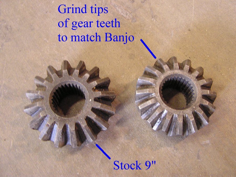

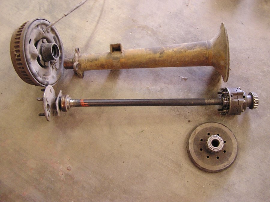

  20. I did the late model 9" axle conversion on my Mysterion reproduction. This fixes the biggest problem of these units in really weak axles.
    9" side gears mesh with banjo side gears with a couple of mods.
    First is the OD of the 9" side gears must be ground down to fit inside the carrier.
    Next the crowns of gear teeth on the banjo spider gears are too tall and hit the roots of the side gears. The tip of each tooth on each spider gear must be ground shorter. If you want to be fancy, you could do these two mods on a lathe but grinding works fine.
    Next the side gear bushing holes in the differential housing and in the ring gear must be bored in a lathe to fit the larger stub on the sider gear. Use carbide tools and it is easy to do.
    If using the whole old axle tube, the old bearing stub must be cut off and the end bored to receive the oil seal.
    Key to my conversion was this bearing conversion kit. Allows use of 9" axle bearings. Seal goes in the hole in the axle flange behind the aluminum adaptor.
    Another option is to cut off the banjo wheel bearing housing and weld on the 9" one.

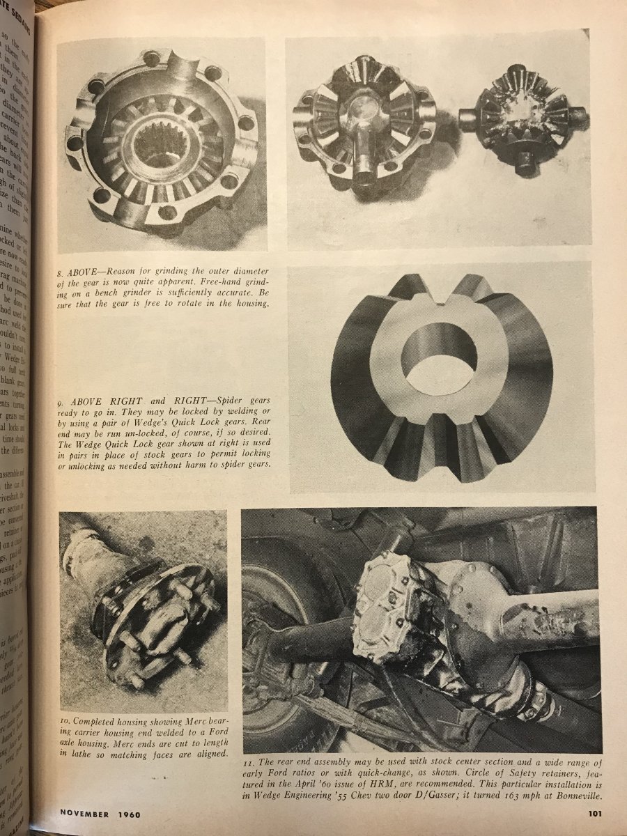

    I remembered seeing an article from the old days updating the old Ford rear ends. Here's the article from the November 1960 HRM. I love the lead picture with C.J. Hart and two Chevys. It's basically the same process as posted above but using the parts that were common back then.
    In the article the work is performed by Irv Cohen of Wedge Engineering. I found this very interesting because I worked at Wedge Engineering years later. It was owned by Carman Pisano and was located at the outskirts of Downtown L.A. I knew they were friends but I was unaware of the business connection. We made scattershields and some exhaust accessories while Carman did performance tune ups for Warren Biggs (?) Chevrolet. Irv owned Drag Machine, still in the Gardena location at the time I worked at Wedge. He narrowed rear ends, made engine/transmission adapters and did specialty machine work of all kinds. He did the driveshaft and a few other parts for my dad's homemade inboard ski boat - I was 12-13 at the time. Irv's shop was just packed full of amazing hot rod stuff (Wedge Eng. too), a gold mine for a hot rod addicted kid.
    Working for Wedge, I occasionally made pick-ups and deliveries to Drag Machine. Irv was a good guy who didn't seem to mind the dumb questions of a young hot rodder. This article sure opened the memory floodgates.

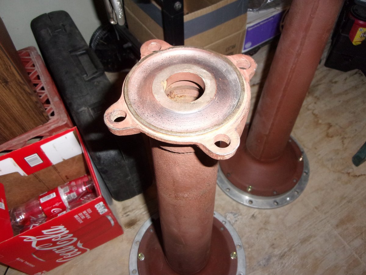

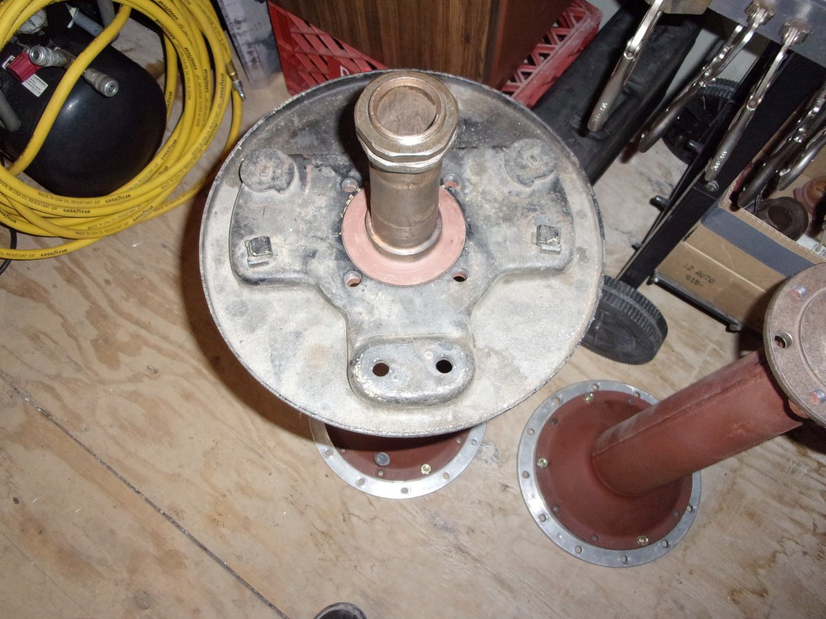

  24. I just got everything back from the machinist.
    This is how it all goes together
    100_0046.JPG 100_0045.JPG 100_0041.JPG 100_0042.JPG 100_0047.JPG 100_0048.JPG

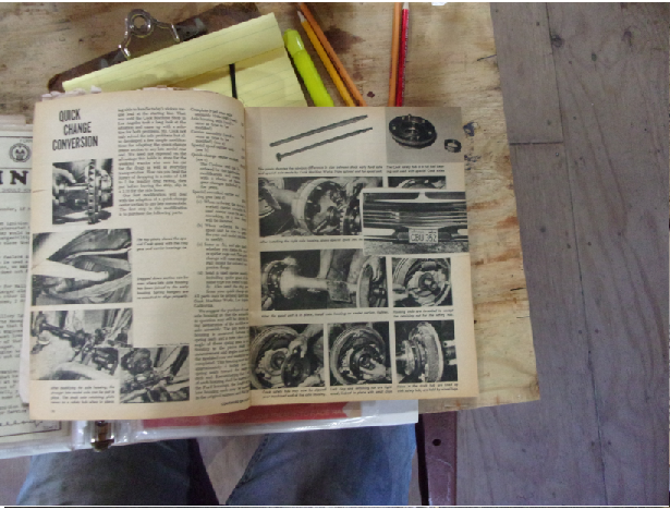

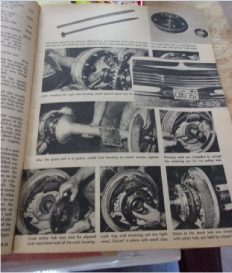

  26. @adam401 keep our eye out for a Nov. 1959 issue of Car Craft, I found this is a bunch of stuff I forgot I had! This ones is hurt some one cut part of the article out for the photo of the 56 Ford custom on the next page, DAMN KIDS!
    Cooks Machine (Cyclone) did a conversion similar to mine but with (custom) double spline axles, drive flanges, and threading the end of the stock Ford bearing race. This is very similar too what modern oval track including NASCAR Cup car do.
    I know these parts are almost un-attainable but it thought you would like to see it
    upload_2020-5-3_19-48-14.png upload_2020-5-3_19-49-33.png upload_2020-5-3_19-51-34.png upload_2020-5-3_19-53-32.png upload_2020-5-3_19-55-29.png
    Red box double spline axle vs Ford
    Yellow boxes drive flanges
    Pink Box (enough giggling) threading the end of the stock Ford bearing race
    Modern 9" Grand National Floater
    Note double spline axle & drive flanges
    Modern Short Track G.N style Quick Change
    Modern Short Track Wide 5 Quick Change, Yes still the same Wide 5 as 36-39 Ford!

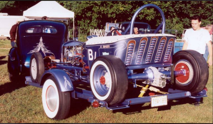

  30. The 3/4 Ton Banjo set up in an Altered
    Luke Karosi Photo 2000 Rockabilly Rumble
