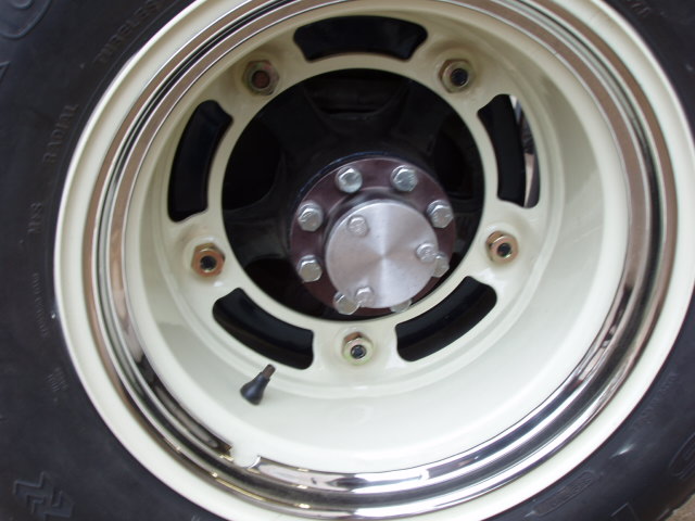

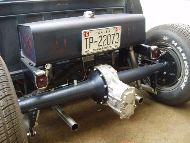

    I used double splined axles and drive plates. Real cheap here in NASCAR country. the LONE RANGER 017 - Copy.JPG the LONE RANGER 018.JPG Shortened long axles and had them resplined 28 splines. Make the rear any width.
