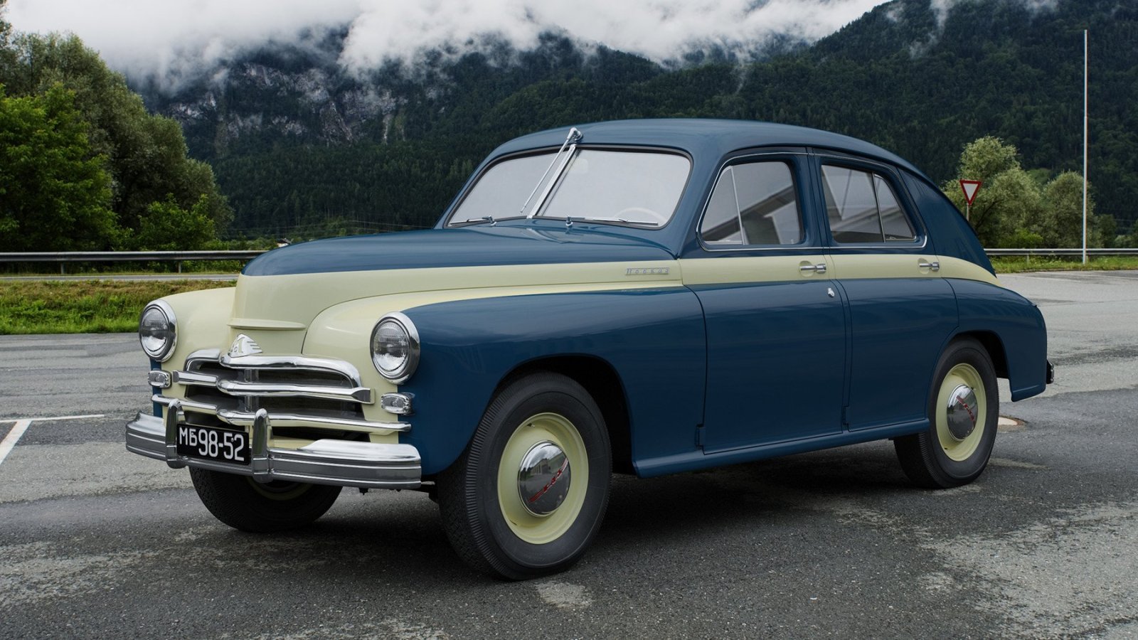

  22. Are you aware that the GAZ M20, Pobeda and Warsawa also have a rear banjo axle exactly the same as early Ford with juice brakes , open driveline and parallel springs..
  23. chevrod
    Joined: Sep 3, 2006
    Posts: 57
    chevrod
    from Finland
    Yes I know but they are no no for me.
