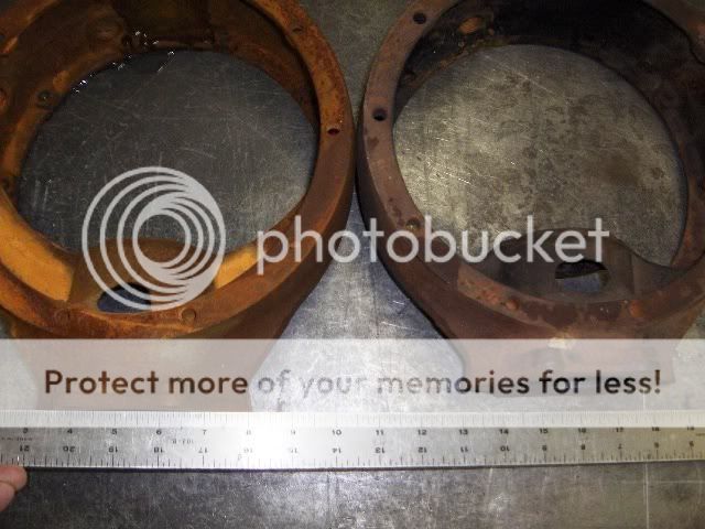

    There are a couple of other differences.
    1. The 33-34 housing is shorter in the pinion area by about 9/16"':
    2. The 33-34 housing is also narrower. It is about 3.5" and the later housing is 3 13/16"
    If you are putting an open drive conversion on a 33-34 rear end, be sure and order one specifically made for those years.
