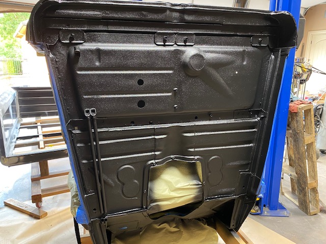

    I used Raptor on the bottom of the 41 PU but prior to that I epoxy primered the entire cab first. I also did all of the body work required under there in JB Weld. That was a tip from the professional bed liner guy that did my running boards and fenders. He said he won't shoot this stuff over bondo as the filler will soften, crack and come lose under the bed liner and make for a nasty situation.
    I recently used the POR-15 bed liner on my daughters Toyota PU, it can be applied direct to metal and over rust like their normal product is known for. It, however, did not leave a nice uniform finish. Having some of the Raptor left over from the 41's cab, I used it to topcoat the POR-15 product. It turned out extremely well.
