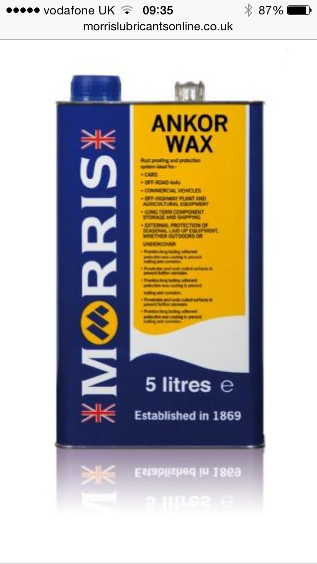

    This stuff gets great reviews(in the uk)
