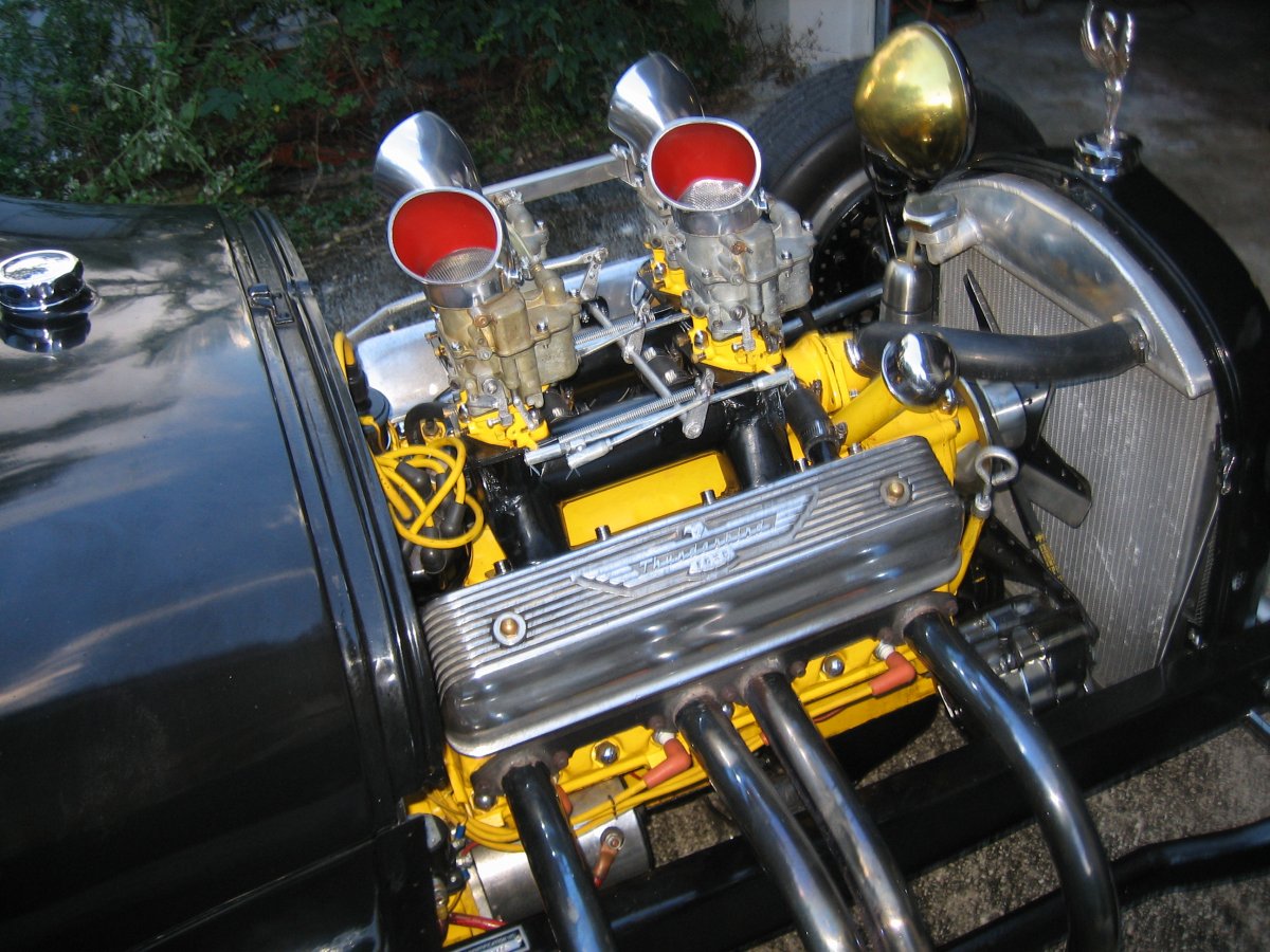

    Got one 8 years ago same Co. made it ,but for a 24/27T/bucket 4cores*< bigger one. I ordered "T" as I have a cut down 28 "A" shell and fits great. Happy with it,works well/ back then at the time was $150 with shipping. Only thing about them I would like,is water inlet/cap would be better ,if higher in top tank{ I'm sure it's done as they do,so top tank can be same one with holes pre cut for hose an cap ,and work for ether Chevy or Ford=cuts down cost for them,no need for two def top tanks-just weld in hose an cap for what is ordered.
    Been working fine for 8 years,I think I got a good deal. Works better then my old copper/br*** that had got really old needed replacing.
    PS; make your self a shroud,I got lazy and didn't make new shroud,but need too.. 002 (4).JPG

    @dana barlow
    That Champion radiator fits that shell like it was made for it. :cool:
    How much is your A shell shortened?
    Got any more pictures of it?
    Thanks!
    It's about 3in. short for 28A,and dropped,I like low. The"T" fits well for me,with a tiny gap each side being the "T" size is 1in. less wide then the "A" an "A" size is too tall for me. Had to make custom mod brackets,but was EZ.
    I do have my own custom stone guard screen just inside shell and I lite spray paint rad behind stone guard flat black< are things I have always done from my first hot rod in the 50s.

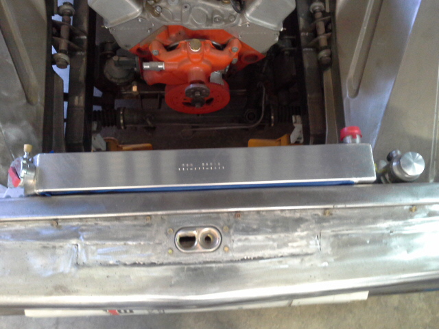

  19. DDDenny
    Posts: 23,418
    I like my Ron Davis radiator!
