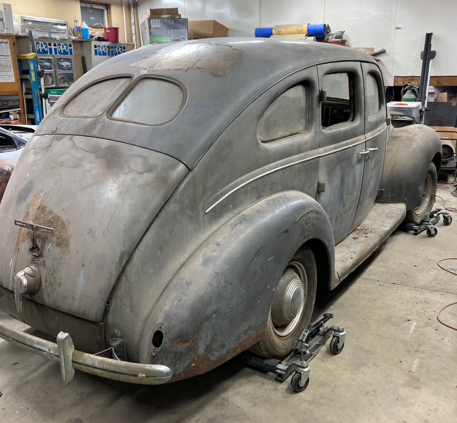

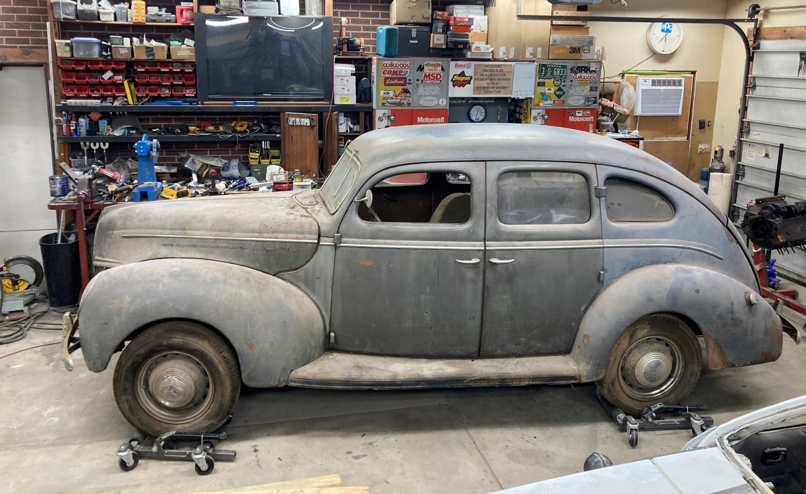

    Brief intro: This is a car that my dad bought in the early to mid-60's with no motor. I aired up the tires and it was moved from the barn stall that it had sat in for the last 50 years to my garage a week and a half ago. My son, brother and I are ready to dive in! I had snagged a 59AB Flathead out of the barn a couple months ago to hopefully get a jump on this project. We have it tore down far enough to where the crank is the only thing left in the block. It's still standard bore, and the rod journals haven't been turned, so far so good.

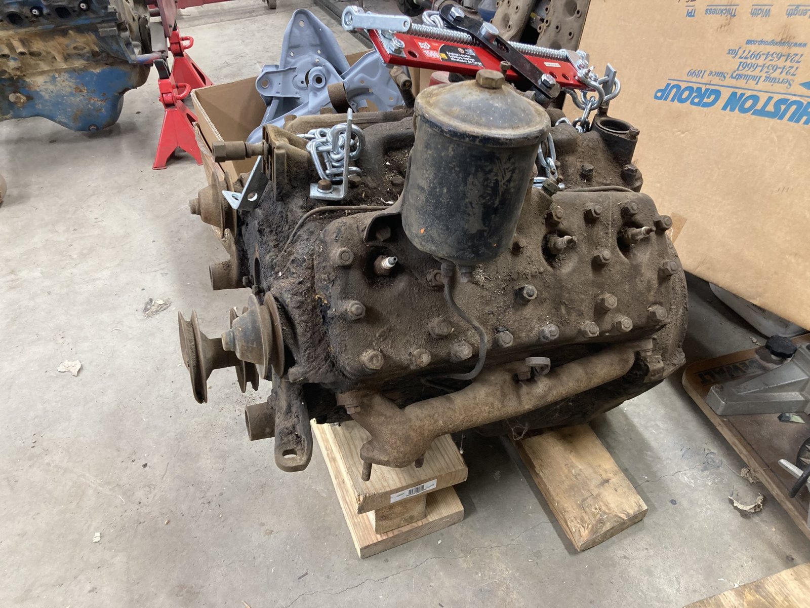

    Having zero experience with the Flatheads has proved very interesting so far. This engine had also been in the barn for 50+ years in an unknown condition. It wouldn't turn over until the timing gear was removed. Further investigation revealed cylinders 5, 6 & 8 had stuck exhaust valves. I borrowed the long pry tool and K-D Tools C-clamp and managed to get all the intake valves and 1 of the exhausts out. That took way longer than I ever expected it was going to. Once I got past 50% of them I didn't feel a bit bad about breaking out the cut off tool and removing the rest. IMG_2599 (2).JPG IMG_2632 (2).JPG

    IMG_2654.JPG IMG_2665.JPG IMG_2661.JPG IMG_2650 (2).JPG I'm on the fence how far to go with the rebuild. when i finished chiseling the mud n dirt concrete out of rear corners above the oil pan and got it removed and saw this obvious plugged up mess I figured this a hot tanking, piston buying, crank turning deal. Once we tore into it the bearings all look pretty good and now if wondering if I should just clean this thing up and put it back together? The block is getting chucked into a drum to soak the nasty stuff off before I make that decision. I'm going to have to do a search on here to see what opinions there are on how to handle the valve job. It is probably going to need some seats but I'm not opposed to buying cutters and making a pilot to go into the lifter bore and trying it myself. I have to get focused that this is not my typical 400 HP stuff. End result is it's a standard bore block and the crank has yet to be turned and I'll let my engine guy tell me what it needs. All the safety wire is really cool, didn't expect that.

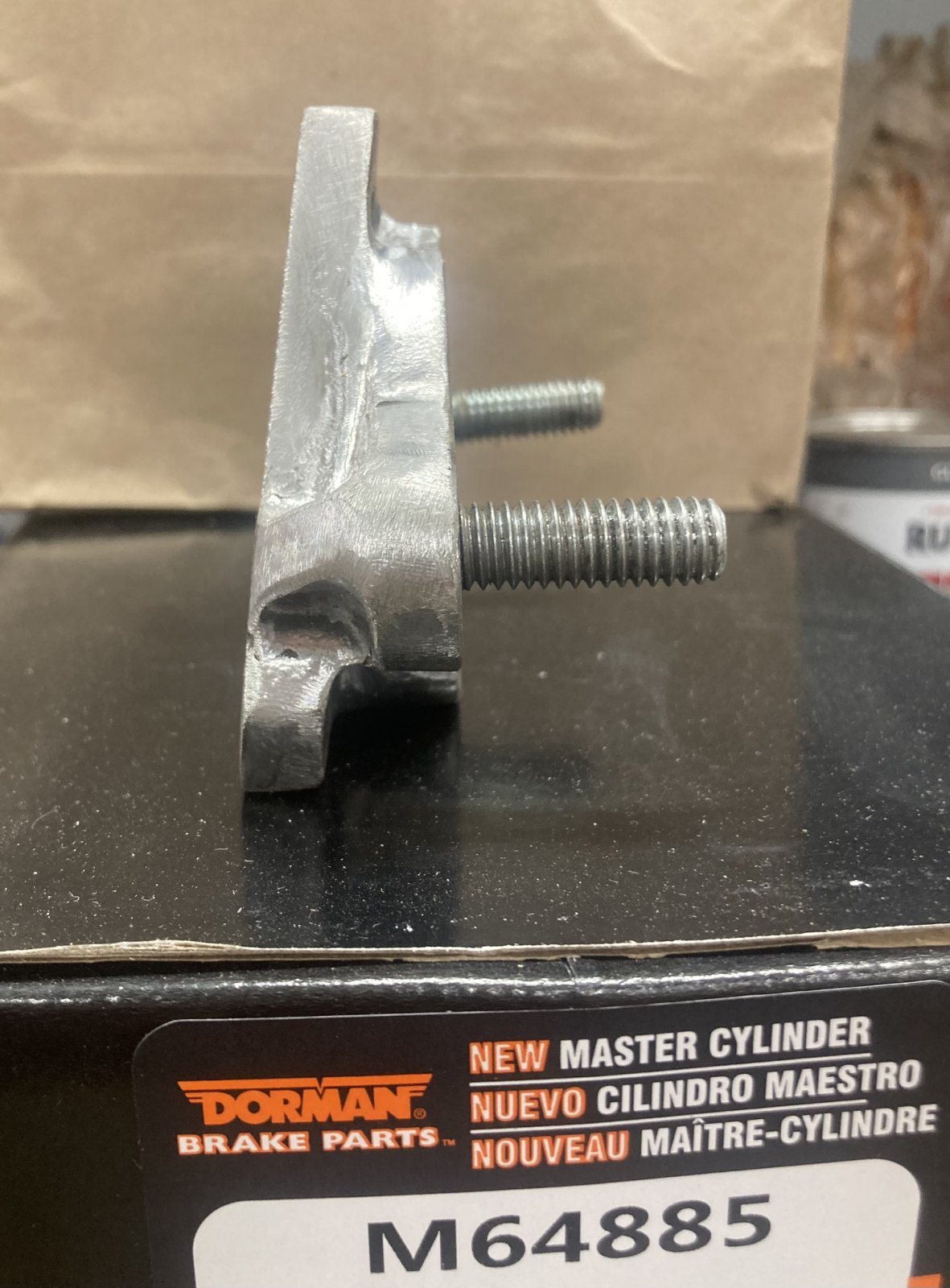

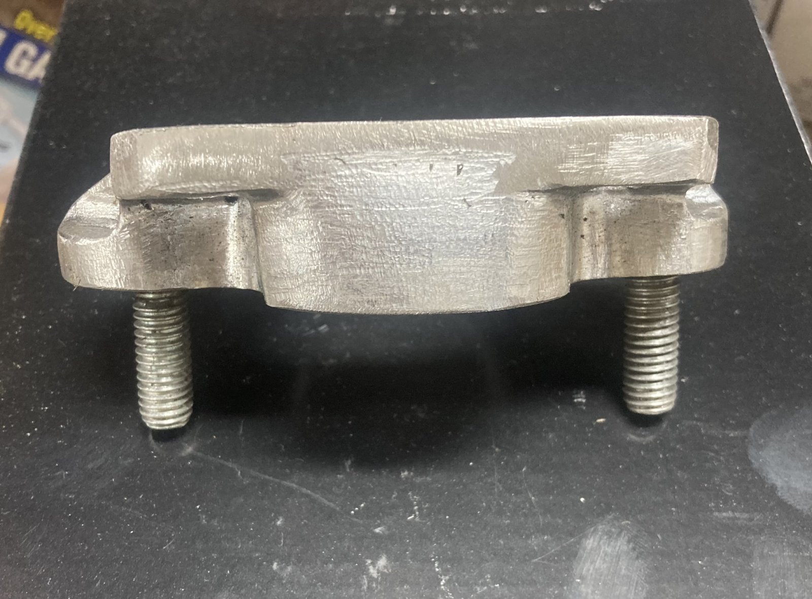

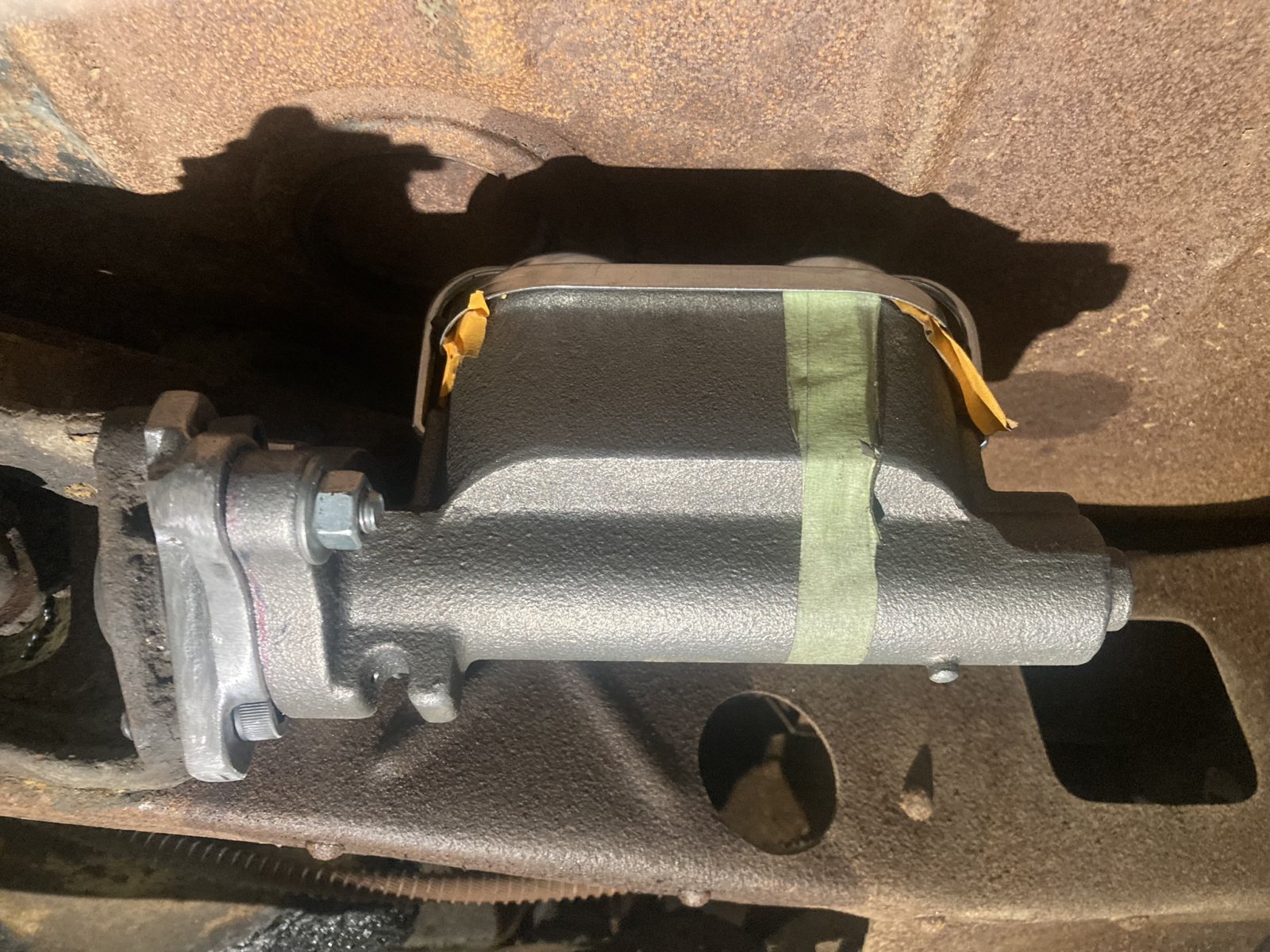

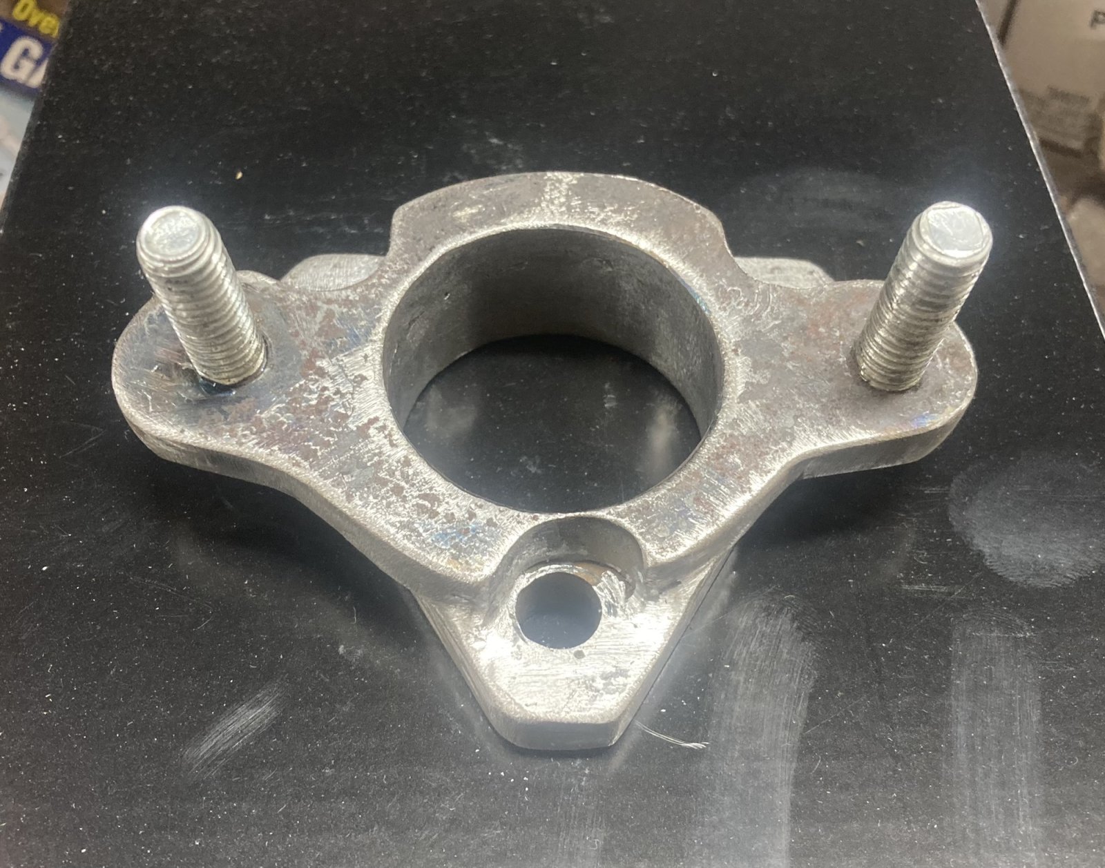

    I decided to replace the single reservoir with a dual master cylinder and wanted to keep it simple. I went with a Dorman M64885. It's a GM manual drum brake application and both lines are 1/4". My brother made an adapter out of a couple s**** pieces of 3/8" plate to combine the new 2 bolt master cylinder to the original 3 bolt bracket.

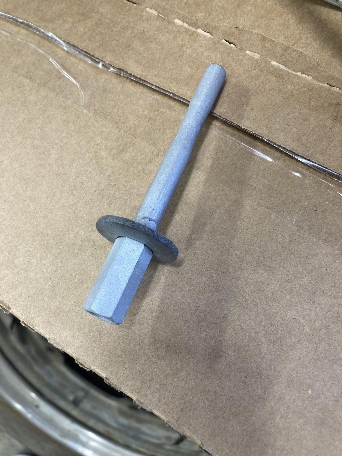

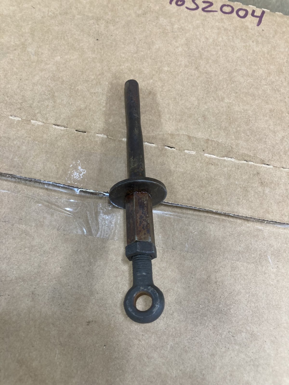

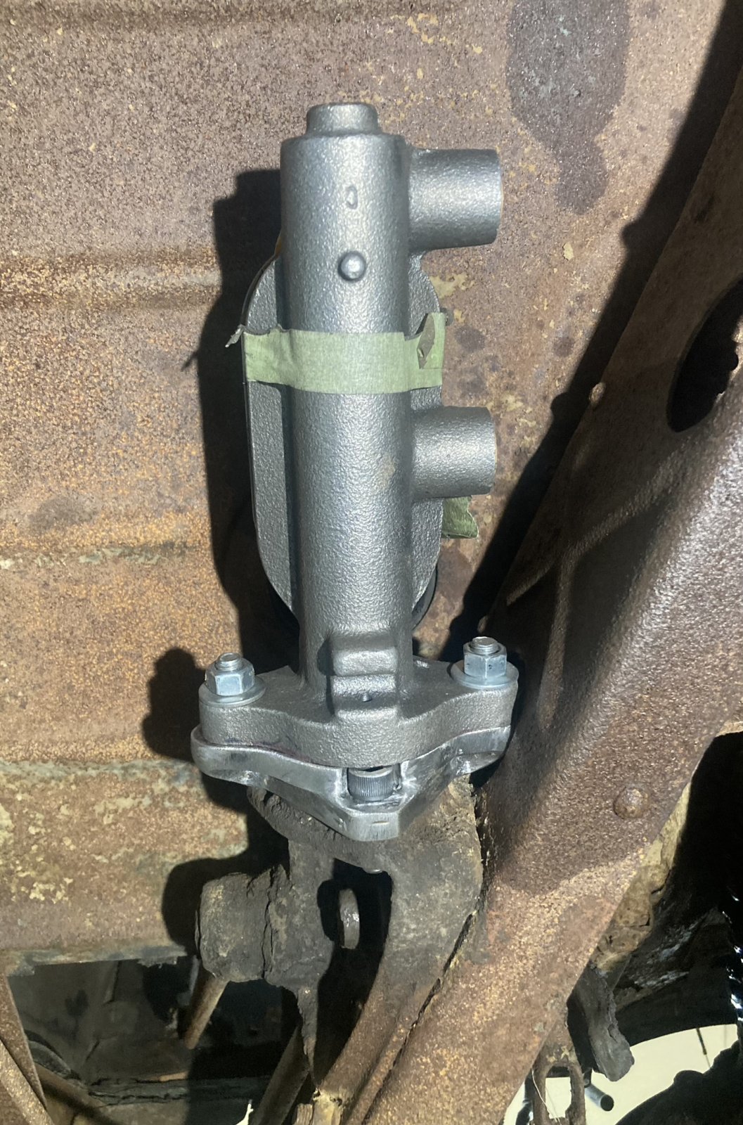

    I'm waste deep into the brakes and hopefully will have them functioning by the time the weekend's over. The original pushrod was too short once the adapter was put in there so I fabbed up one out of a 3/8"-24 coupling nut and 5" long grade 8 bolt cut down. I did have to whittle down the middle. Master Cyl Trial Fit.JPEG Master Cyl Trial Fit2.JPEG Brake Pushrod Blasted.JPEG

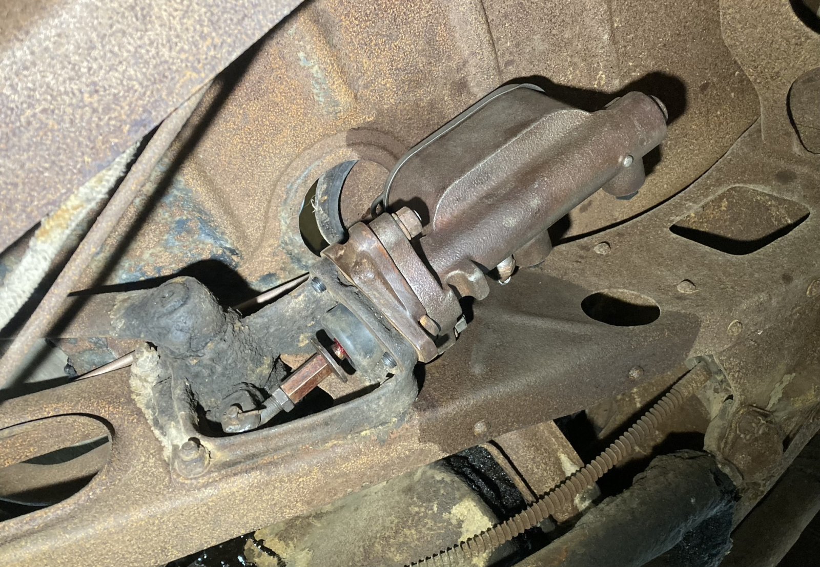

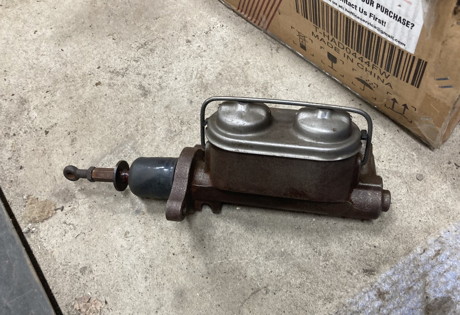

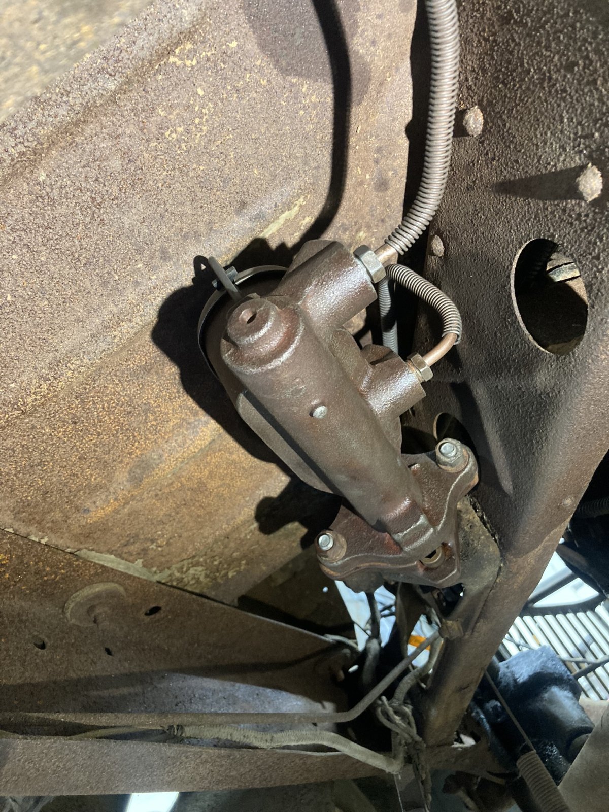

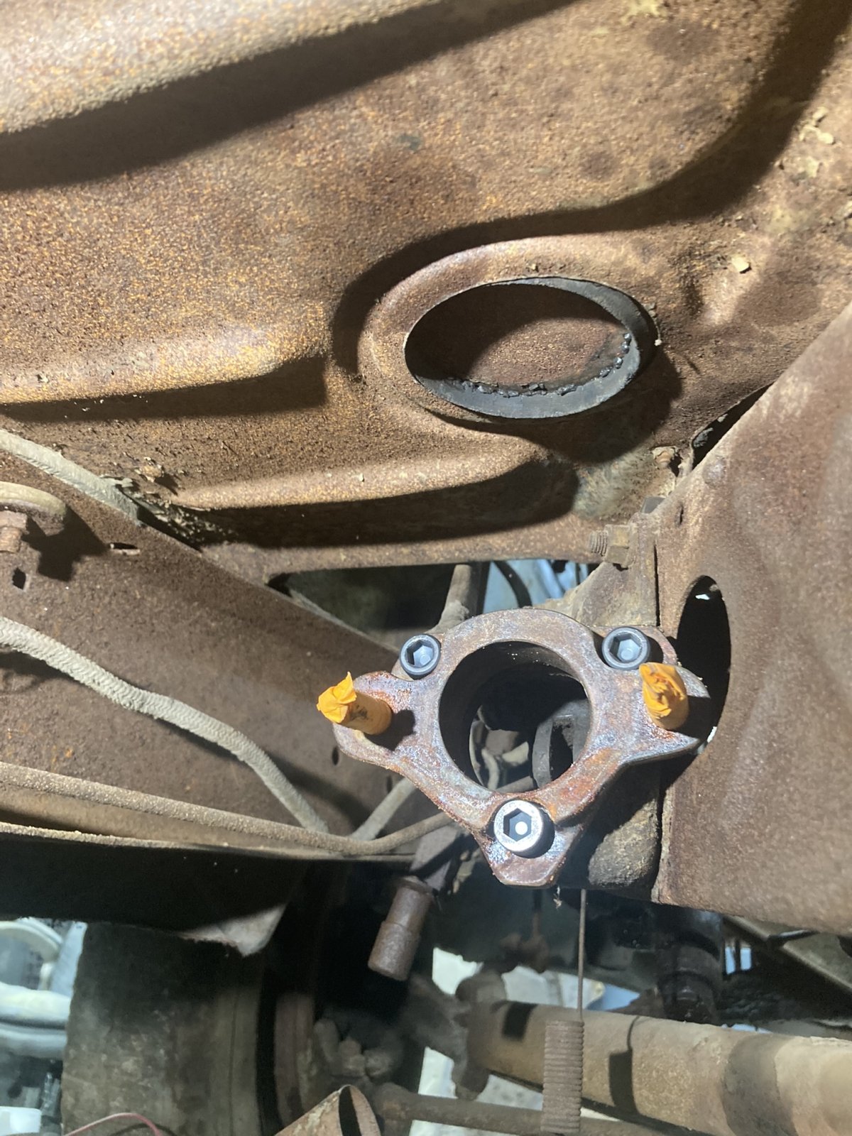

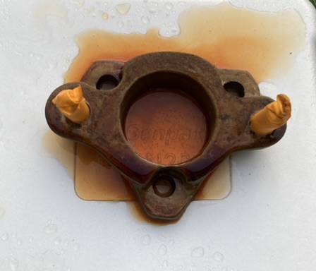

    Next dilemma, I'm not painting anything on this project and I'm definitely not going to be able to just leave the new pieces looking so outta place under there so I started Googling how to rust up some metal. I mixed up some Hydrogen Peroxide, vinegar and salt in a trigger sprayer and started spritzing. I traded the new master cylinder lid for and old crusty one. I was very happy how it all turned out this far. Brake Pushrod Rusty.JPEG Master Cyl Adapter Rusty.JPEG Master Cyl Adapter Installed Rusty.JPEG Master Cyl Complete Rusty.JPEG Master Cyl Rusty Installed.JPEG Master Cyl Rusty Installed2.JPEG Master Cyl Rusty Installed3.JPEG

  27. X38
    Joined: Feb 27, 2005
    Posts: 17,498
    X38
    You've got to be kidding me.:rolleyes:
    Do you plan on parking with mirrors under your car?:confused::confused::confused:
    Things will look old soon enough all by themselves.

  30. BarnFind39
    Joined: May 6, 2023
    Posts: 63
    BarnFind39
    Nope, no mirrors, I just have a problem. I constantly do "well, since I'm here..." stuff and stretch projects out much further than necessary. Usually restoring and painting every part is what gets me. I'm well aware that between my job, work around the house and other cars I want to do there is no prayer of this being finished or other projects ever getting under way anytime soon if I start the body work & painting process. I have a REAL problem in that area. This car has been very well preserved for the last 60 years and still won't see any elements once it's roadworthy. My opinion is if all of the original metal was still there after 84 years, the few things I made a little rusty won't hurt a thing. This rodeo definitely is a first in this arena. I've done a fair amount of work on late 60's cars but a first attempt at a whole lot of stuff, huge difference in technology when you go back 30 years, and I'm definitely looking forward to it!
