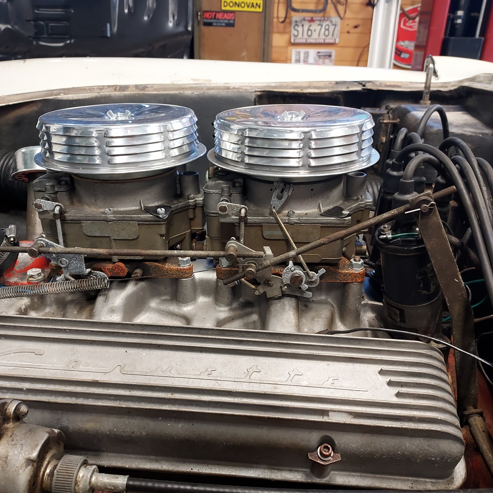

  18. The throttle has a very tight spot in it at idle. I might not have the correct parts. The bracket and arm at the firewall are the issue. The rod points down. I think the arm is too high. Corvette city lists a 57-58 arm thats flat. Zips lists a round 57 arm. Who has the correct parts?
    Are the parts different for a single four and a 2x4 carb set up?
    I dont trust internet pics. Looking for a correct pic.
    Thanks
    65pacecar, Thor1 and 41 GMC K-18 like this.
  19. Stopped at the old guys place. He had a 60 trunk lid off the car he rolled in 1968. Its perfect. If someone needs it its for sale. I prefer it goes on a car and not ebay.
  20. This is what i have now. The rod points down. Its action is to first pull up on the carb linkage then pull back. Im sure my issue is right here. I think the flat bar is too long. There are no extra holes to lower it. 20220424_175001.jpg 20220424_174957.jpg

    here is a pic I found of a stock setup. originally they were progressive. I bet if you linked the 2 carbs using the lower holes in the carb arms then hook up the throttle pull linkage to the top hole on the rear carb, It will make the angle a little less severe 562x4.jpg

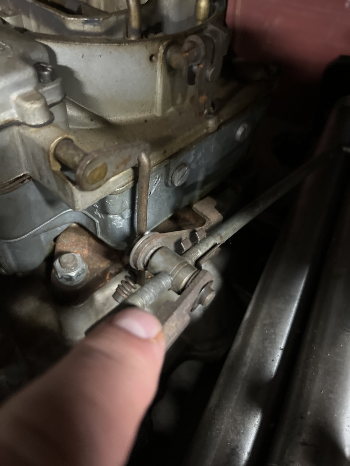

  23. 20220424_174957.jpg 20220424_190707.jpg 20220424_175746.jpg 20220424_175809.jpg I reversed the positions of the rods. This took some of the angle away. I removed all of the slack at the four attatching points. I experimented with a few different weight springs. It all seemed much better exept a slight bind when the gas pedal was attetched. The last little bit was the rod to pedal. It was getting caught on the rubber under the pedal. It was off to the center of the car. I flexed it back to the center and its all good. Nice pedal feel. Idles at the correct rpm. Has full throttle now. I cant wait to drive it again. The exhaust from the manifolds to the tail pipes needs to be replaced. It finally rotted a few holes in it. Do you think gm will warranty it. It is factory with only 70,000 miles.
    Before and after pics.

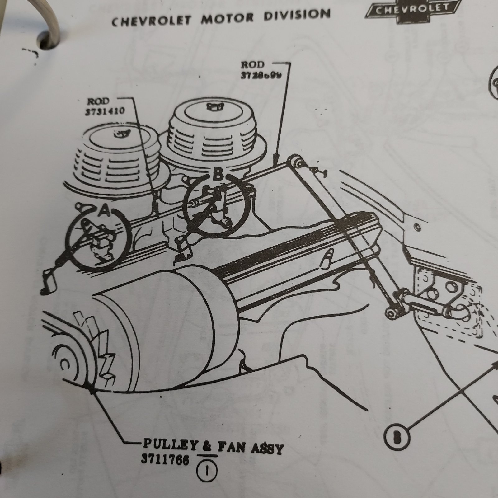

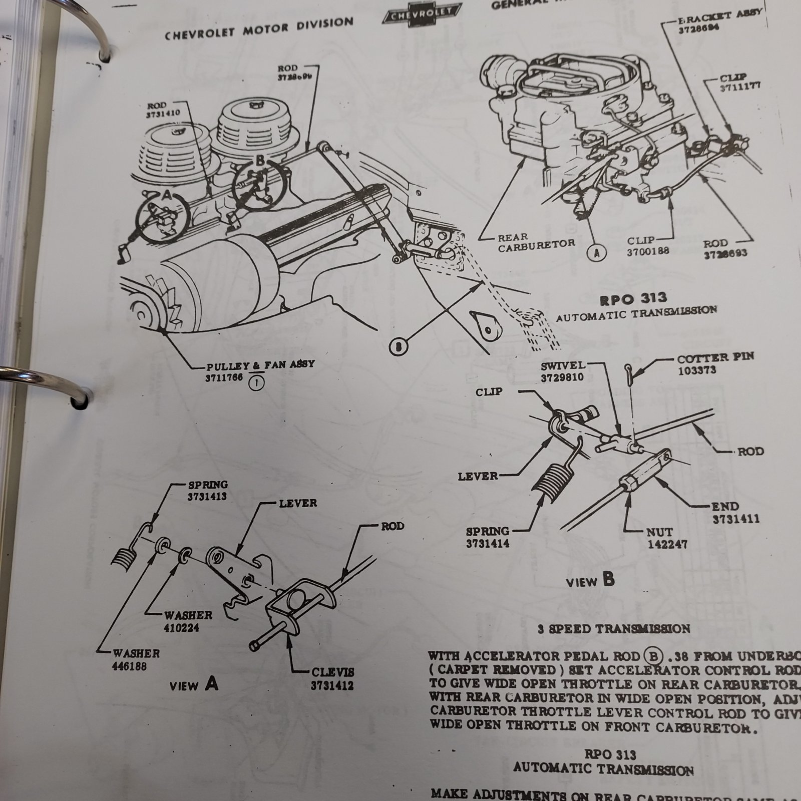

  27. image.jpg You need this double ended piece
  28. Thanks for the photos. Nice detail. It looks like the engine runs off the rear carb then opens the front carb on full throttle. The connections are all at the top hole. The return spring runs the rear carb.
    I do have it working but i can see i have a few incorrect linkage parts. Time to call zips. I want this right. Its very un nerving at a stop light not knowing if the car is going to spin the tires or leave normally when the light turns green.
