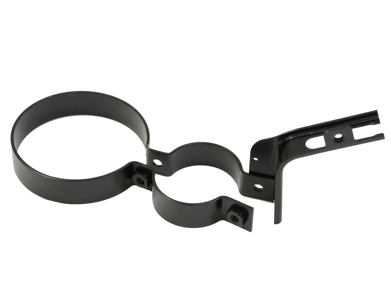

    s-l1600.jpg I'm not completely sure, but doesn't the coil clamp to the bowl of the distributor, with a figure 8 pinch type bracket? I'll see if I can find a pic to post...
    Like this one...

  7. rumblegutz
    Joined: Aug 29, 2008
    Posts: 682
    rumblegutz
    Yes the carbureted cars do use the figure 8 bracket for 56-7. The FI cars did not.

  8. Thanks for the info. The correct bracket is on the way.

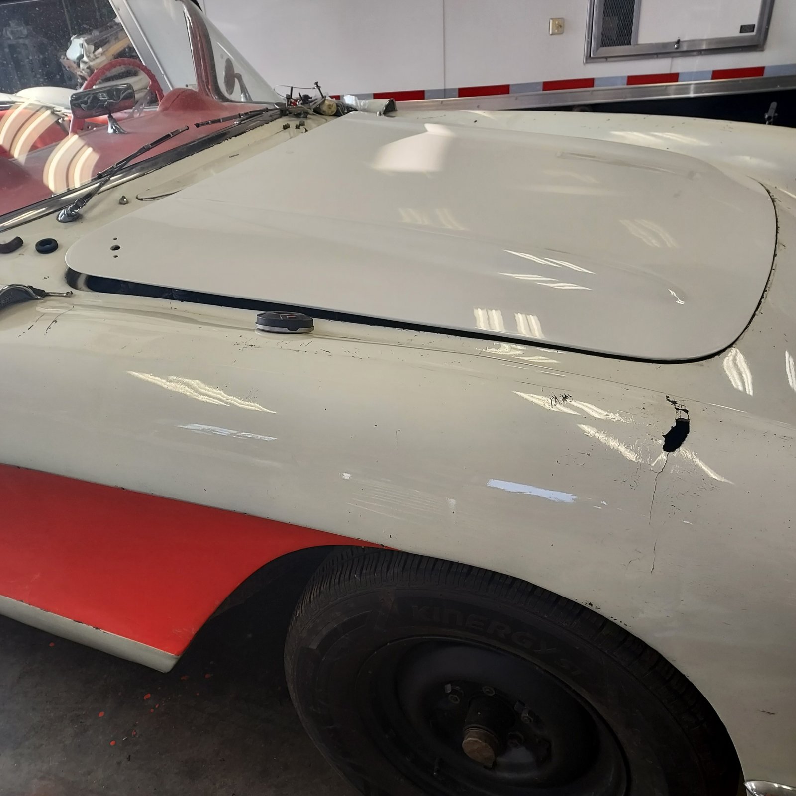

  16. The deed is done. I think it looks ok. Better than all the black spots. The car as mentioned is tree colors of white do to crashes and repaints not to mention age. I will buff the fenders with fine compound to help blend it in better. The hood was scanned at our local paint shop. This info was put into the computer to come up with a paint code. 20220510_174335.jpg

  17. guthriesmith
    Joined: Aug 17, 2006
    Posts: 13,234
    guthriesmith
    I did something similar last week, but used my old Sikkens color map books to find the color as best I could for a faded hood repaint match. Mine isn’t perfect either, but close.
    Looks good!

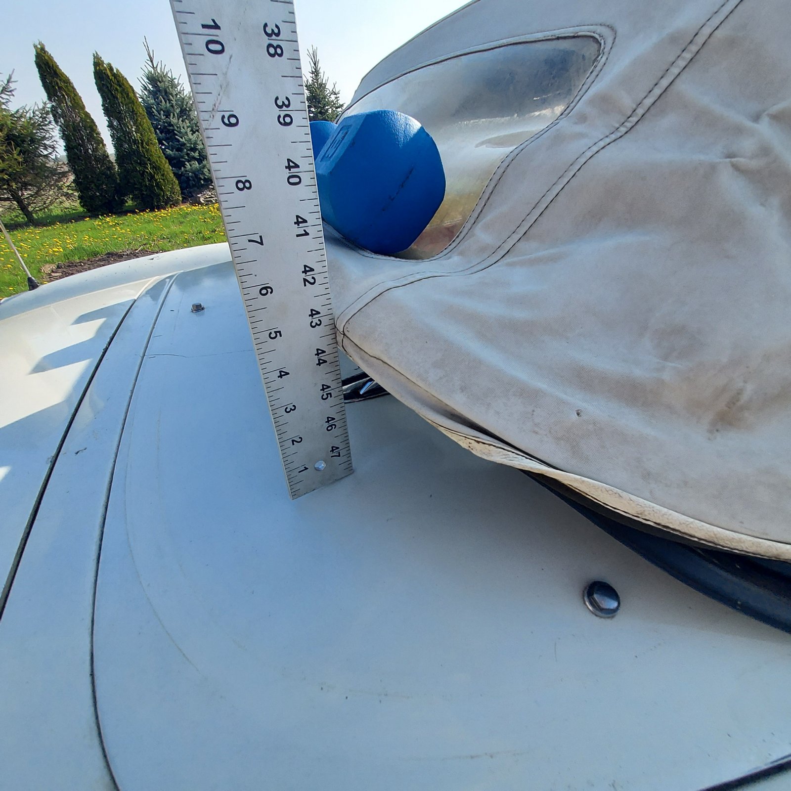

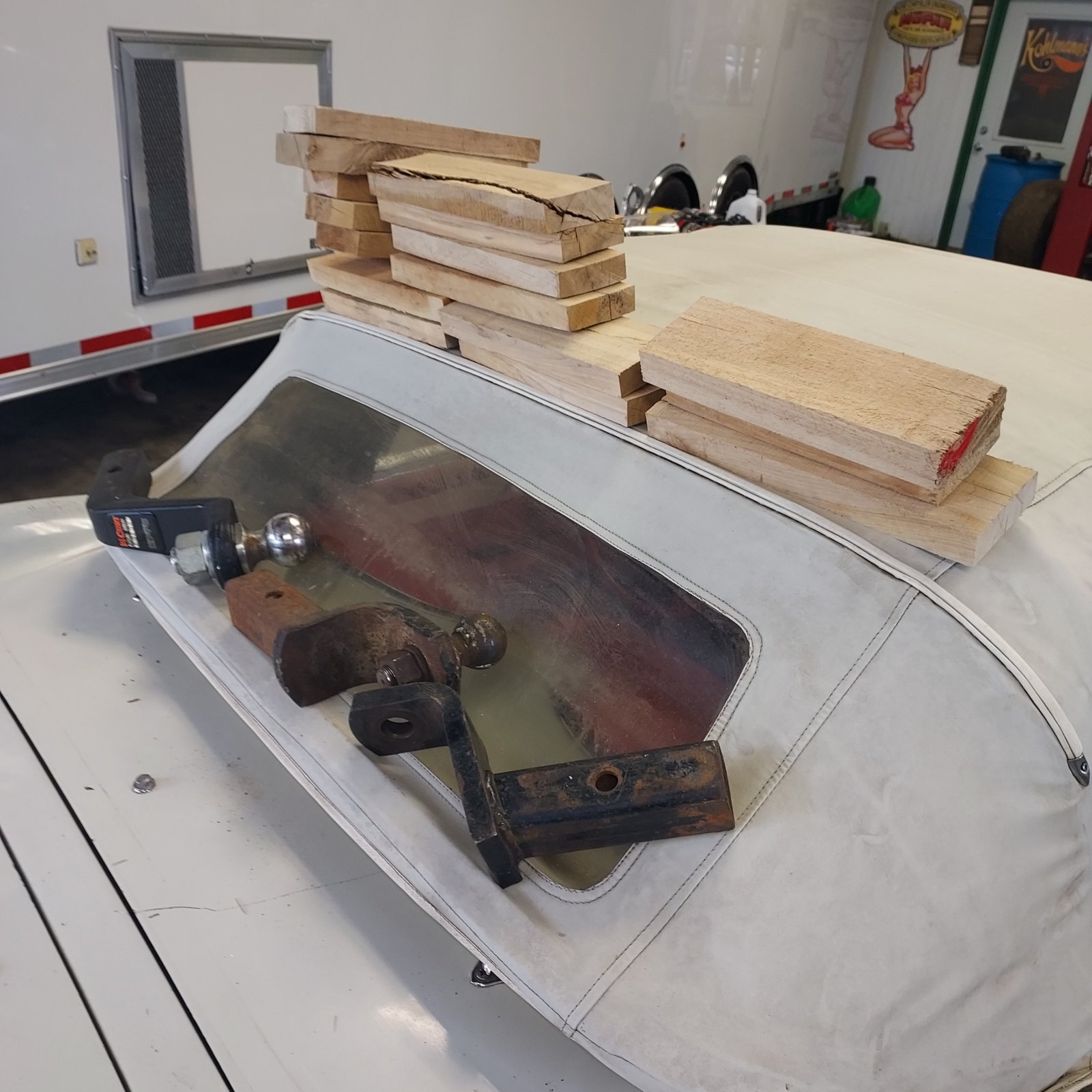

  18. 20220512_082637.jpg 20220512_082541.jpg 20220512_082525.jpg 90 degrees today let the top stretching begin. Starting with 16lbs.

    I have done this to a few white tops…lay a black throw over the top while it’s out in the sun. It will absorb more of the suns heat.

  21. y'sguy
    Joined: Feb 25, 2008
    Posts: 893
    y'sguy
    from Tulsa, OK
    So how did the top stretching go?
    I've always had decent luck by attaching the back clamps down and then letting the front sink down slowly. Your results may vary!
    Nothing to get in a hurry about at any rate.

  23. I have been told this is not a one day process. I had the weight on the rear for day one. This weekend i will reverse it and put weight on the front section. I plan on alternating back and fourth until its done.

  24. 1.5 inches of stretch after two days.

  28. Ford blue blood
    Joined: Jan 4, 2009
    Posts: 801
    Ford blue blood
    Getting it wet will not help. I had a similar problem with a T-bird top. Put a small electric space heater in the car on a plywood "shelf" to protect the seats. It softened up the material enough to allow latching it down. After the heater was taken out I let it set for a day in the shop. Worked perfect after that with no "re-shrinking". I did put it up and latched it after every ******* run.

  30. Two full inches now after three days. I added more weight today. Slow and steady wins the race. 20220515_152500.jpg
