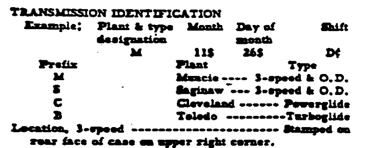

  14. I pulled the trans to fix the shifter. I was told it was the original trans. It's a three speed. I can't find any numbers on it. Only casting numbers. The tailshaft has the shifter mounting pad so that's correct. Are there supposed to be any serial numbers on this trans? Maybe I'm looking in the wrong place 20221219_174558.jpg

    I am pretty sure that engines and transmissions were not serial numbered at the factory until 1960 or so

    No serial number, but the bottom characters below GM in the picture are the casting date.

    See the numbers under the part number that is the date it was manufactured, and it should be the only number you should be concerned with for a 1960 .

    The castings have casting dates, which will tell you when it was made, and should be close to the dates on the other parts in the car.
    Putting a 4 speed in it will totally ruin the "grinding into first" thing when you are getting ready to start moving. The old 3 speeds are so fun! :)
    oh...as for stamped numbers, this is info from Chevy from 1957
