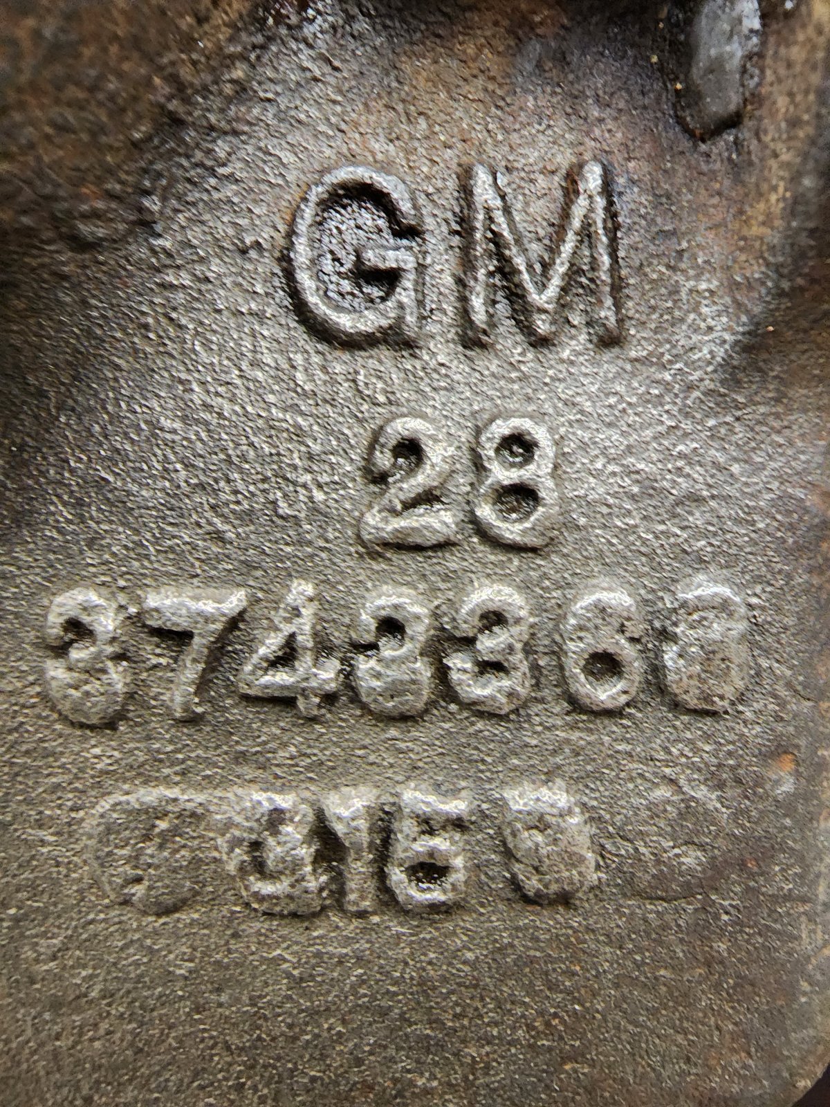

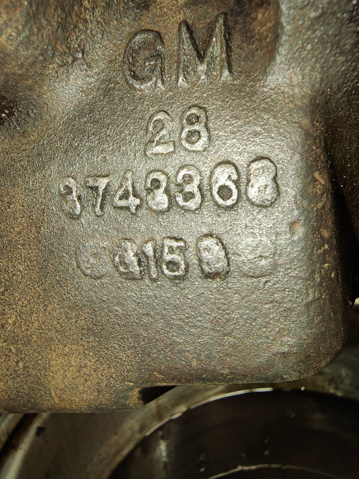

  5. So this is what I have. I used brake cleaner and a wire brush to clean it as much as possible. It's still not very legible. I tried a few different angles with and without the flash. What ever it is it's going back in once the gaskets; fluid and seals are changed. A new shifter will be installed to replace the sloppy original 20221226_171541.jpg 20221226_171547.jpg 20221226_171753.jpg 20221226_171802.jpg

    Kinda' looks like G159. Replacement case possibly?
    65pacecar, Deuces and Moriarity like this.
  7. If it's G15 that works. G would be July if I have this correctly. The car is a early 57. The last number doesn't look like a six. Who knows. If you stare at it long enough after a few beers it kind of starts to possibly be a six.

    Your 3743368 main case was used starting 1958 thru 1960. Didn't look at '61-2. Your main case is dated J 15 9. Which is October 15th 1959 and likely started life in a 1960. Your side cover will likely be 3731911. The '56-7 main cases had casting #3845122.
    If you have a trans originally installed in a Corvette then the tail shaft hsg will have 3 drilled and tapped bosses on the left side near the end to mount the floor shifter. If so the casting number is likely 3737450 and is likely vented. '57 had the same tailshaft hsg and vented but didn't have a casting date until later in production. The '56 tailshaft hsg (3722946) and early '57 (3737450) were not vented or have a casting date.

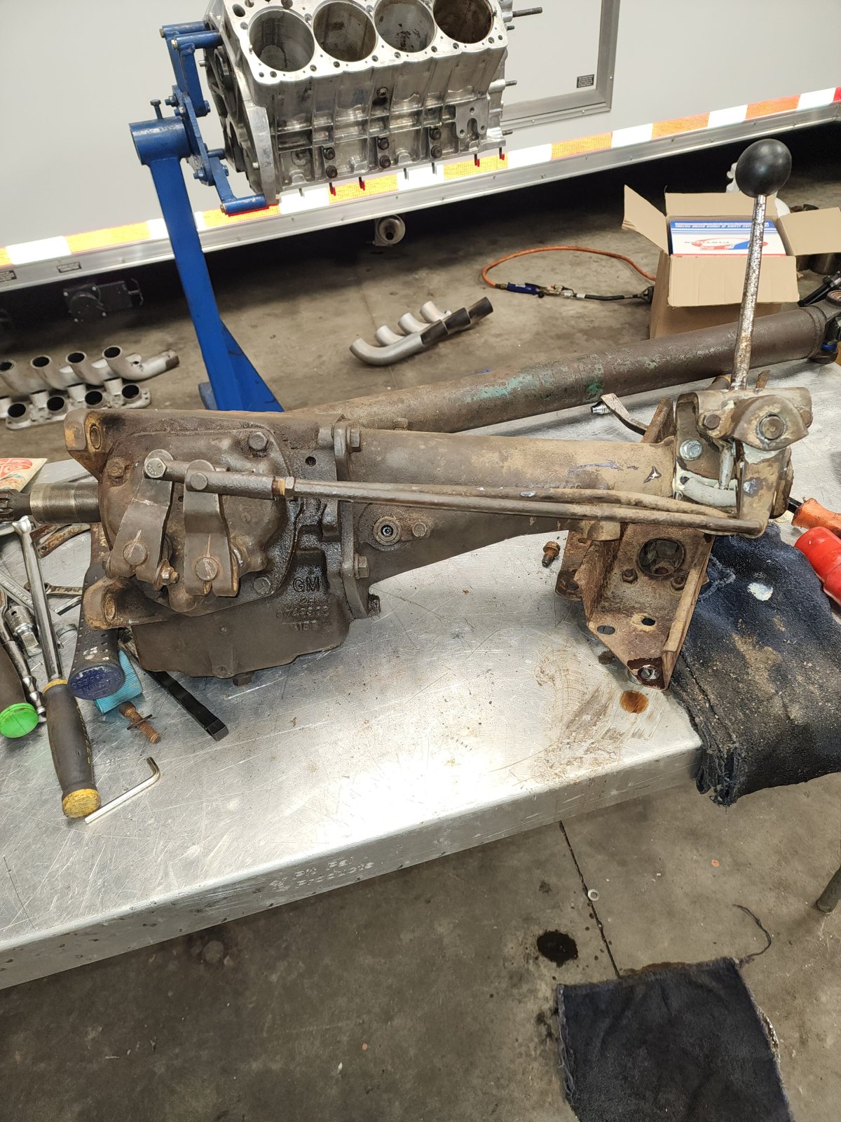

  17. This week's fun involved new gaskets on the trans. It was leaking so now was the time to fix it. A new clutch and shifter were also put in. All parts were s****ed; wire brushes and sprayed off. I hate slimy parts.

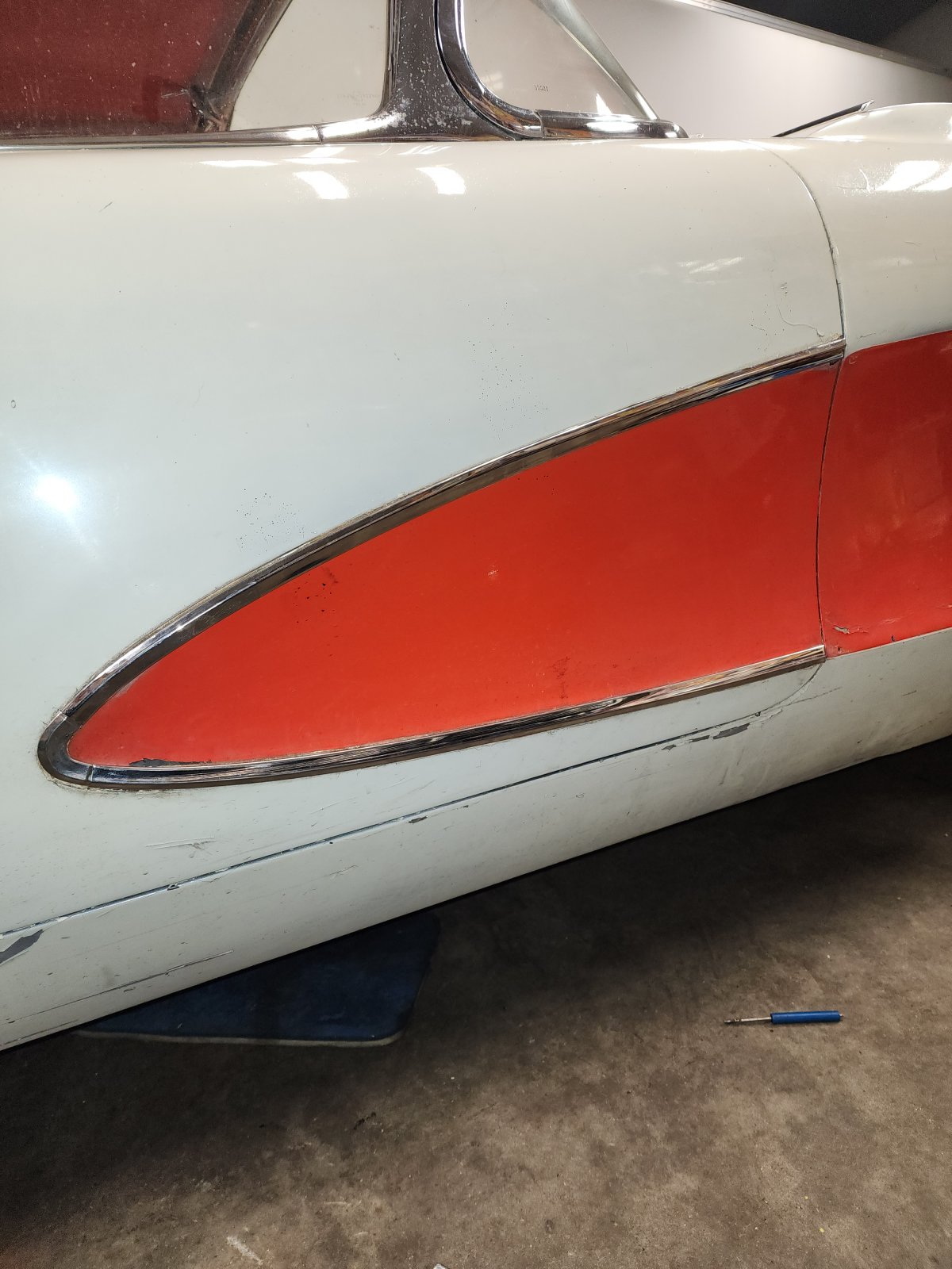

    Next up will be replacing all of the side trim. What remains of the trim is dented or broken. It will be alot of fun gaining access to the nuts. 20230107_161837.jpg

  19. The p***enger door trim is on. I didn't know my arms could bend in so many ways they are not supposed to. Each piece has five studs that slide in the trim. The frustration level goes sky high trying to keep them in place. I put one piece on with the studs through the door. Then I duct taped it in place. Then I could get the nuts on from the inside. I'm calling it quits tonight. I need a beer after all of that. I will get back on it tomorrow. I also need to replace the door handles. The drivers side ****on broke. That should be even more fun. I'm doing the work sitting on the floor. It's not bad as the floor is heated. 20230125_180004.jpg

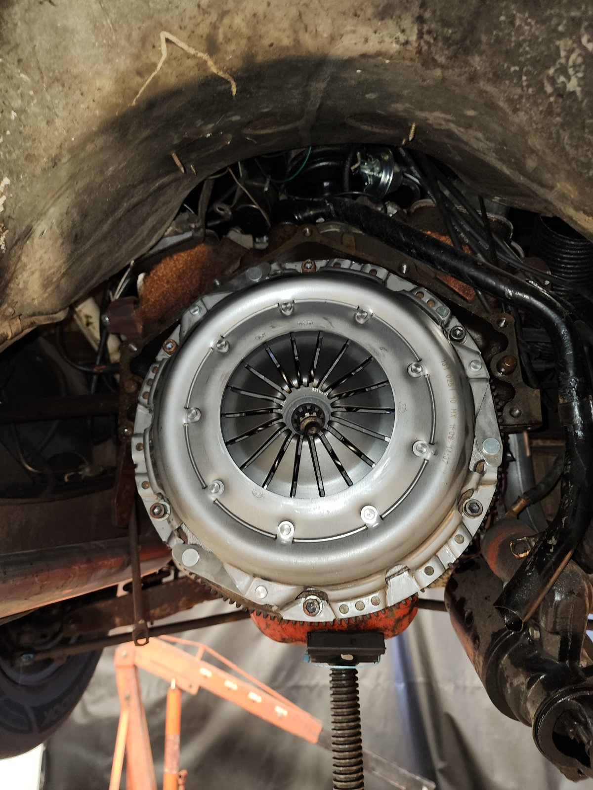

  21. I got the trunk latch adjusted so it locks. The new door handles along with all of the trim are on. Squirrel had some M/T rims laying around so I bought them. Looking for fronts 15x6. A new clutch and drive shaft went in. The entire heater was either replaced or fixed. You need heat in Wisconsin. The new shifter with a white ball was put in. So many other things were done over the winter. It's ready to drive. Its come a long way. 20230514_185829.jpg
