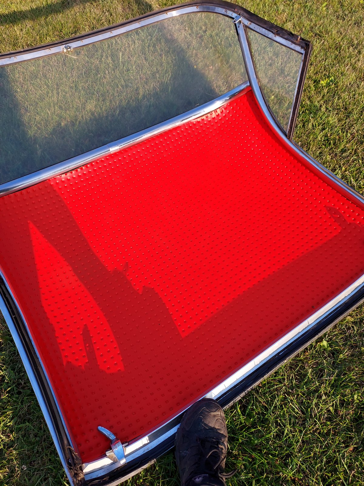

    The hardtop is definitely for a '57. Only the '56 and '57 had that waffle pattern headliner. The '56 had a narrow trim piece on the outside front header. The '57 had the wide stainless piece as like this one as seen in your picture.

  4. Thanks for the info. I need all i can get.

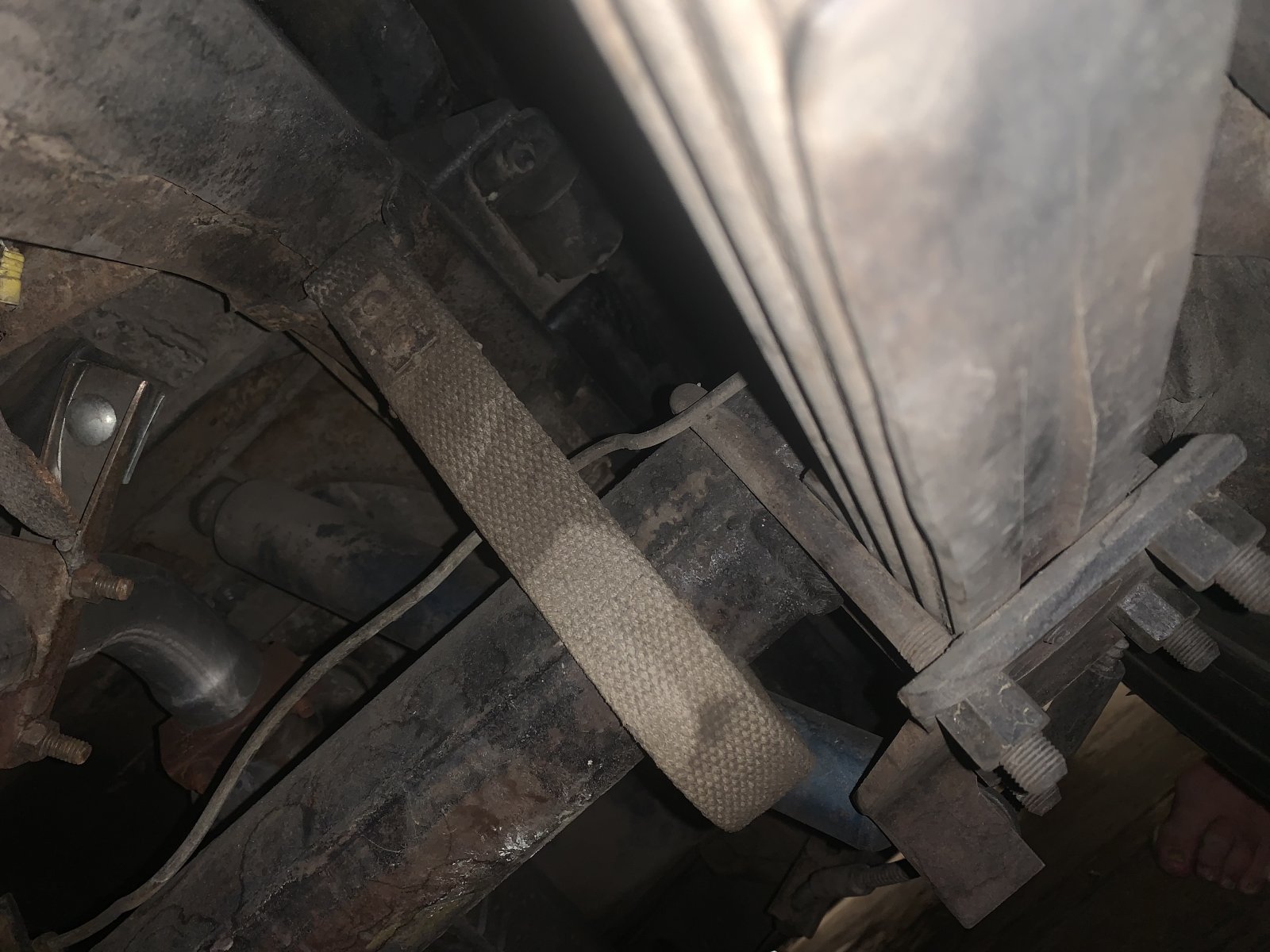

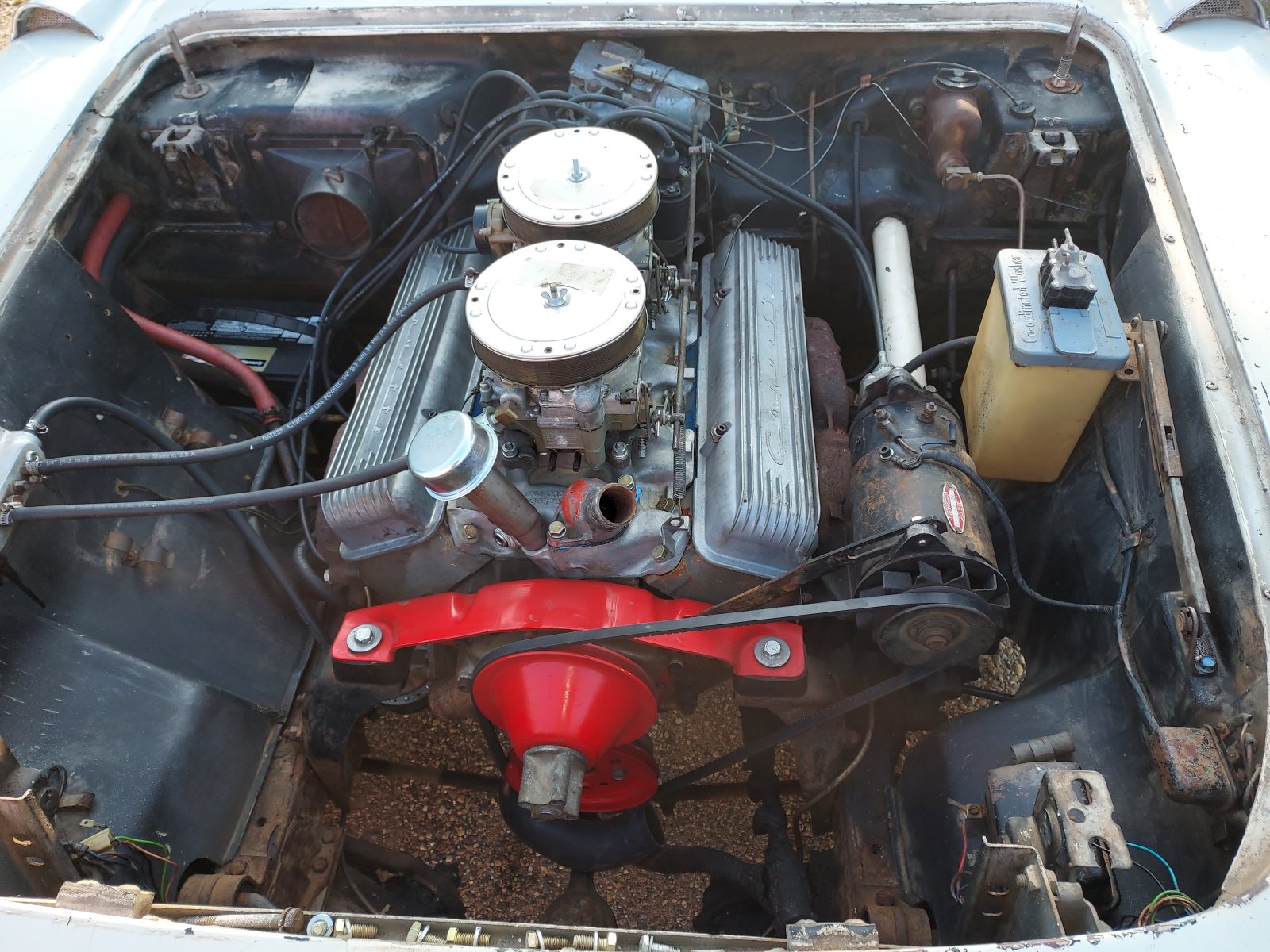

    Todays fun is cleaning the engine compartment. This car must have been stored with the hood off. The same slimy dirt is on everything. I have been spraying purple power and wiping for some time. Its starting to come around. The different colors and finishes on the parts are starting to show. The oil was changed today. There was no filter in the can. Thats nice. I started to remove the tail pipes then stopped. Theres alot of hangers under there. Some look original some dont. Theres some heavy rubber that might have been a loop of some kind bolted to the frame on both sides.

  17. alchemy
    Joined: Sep 27, 2002
    Posts: 23,465
    alchemy
    That's the axle hanger, isn't it?

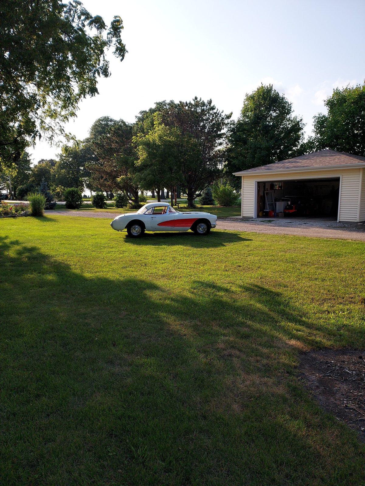

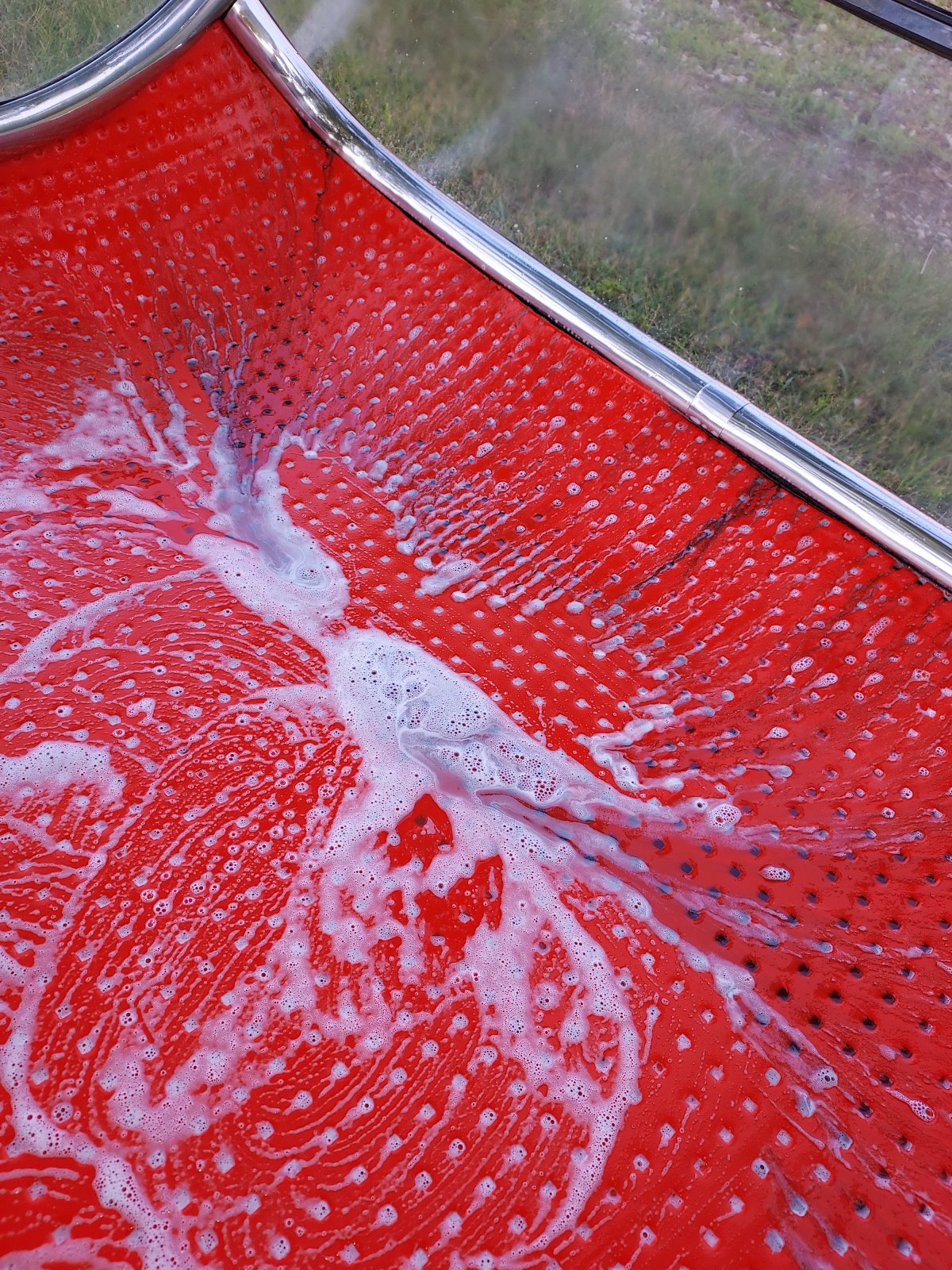

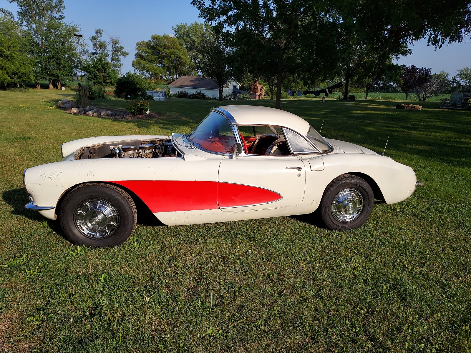

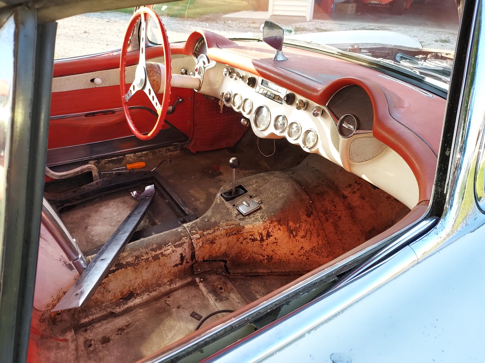

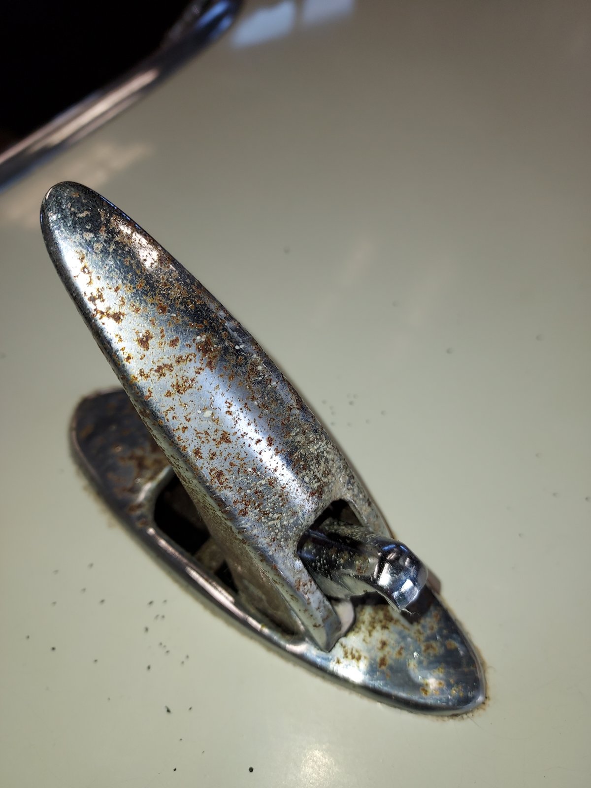

  18. I have been scrubbing; buffing; washing; s****ing; fixing things for the last three weeks. I wanted to push it outside and step back for a look at the progress. Its not bad at 20 feet and not too bad close up as a survivor. I get motivation from before and after pics. When i was done taking pics i took the top off. I set it on the gr*** and scrubbed the head liner. Seeing that the top was off i got after the roof latches. It doesnt end. Im done for today. I dont feel there will be any shame in driving it after im done with it. I just need a few more weeks. 20210801_180952.jpg 20210801_181024.jpg 20210801_181134.jpg 20210801_181144.jpg 20210801_181159.jpg 20210801_181220.jpg 20210801_181237.jpg 20210801_181351.jpg 20210801_182419.jpg 20210801_183327.jpg 20210801_185556.jpg 20210801_185849.jpg

    Limit strap. Buy an ***embly manual.
    mgtstumpy, loudbang and Thor1 like this.
  20. The manual is coming this week. I already have the ***embly manual. Whats the purpose of these straps? Do i need them?
    catdad49, loudbang and Thor1 like this.

    The rubber is for the rebound straps for he rear end(axels). Reproduced straps are available from Zip or Corvette Central.
    egads, loudbang and Thor1 like this.
  25. Are the straps some kind of primitive anti roll bar?

    noboD
    No, they are limit straps. They limit the amount of travel in the rear suspension.

    The rebound straps do act somewhat like an anti-roll bar. The rear of the car can only lean as much as the outboard strap will allow. Later C1 Vettes came with a real anti-roll bar in the rear.
