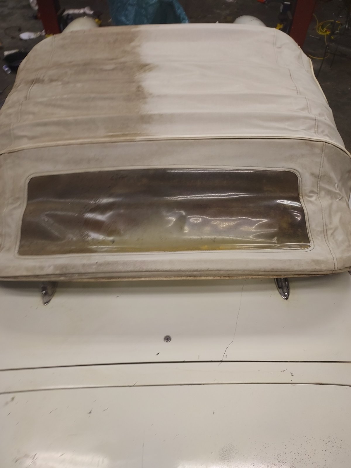

  8. I have been using purple power. Its like fantastic only better.

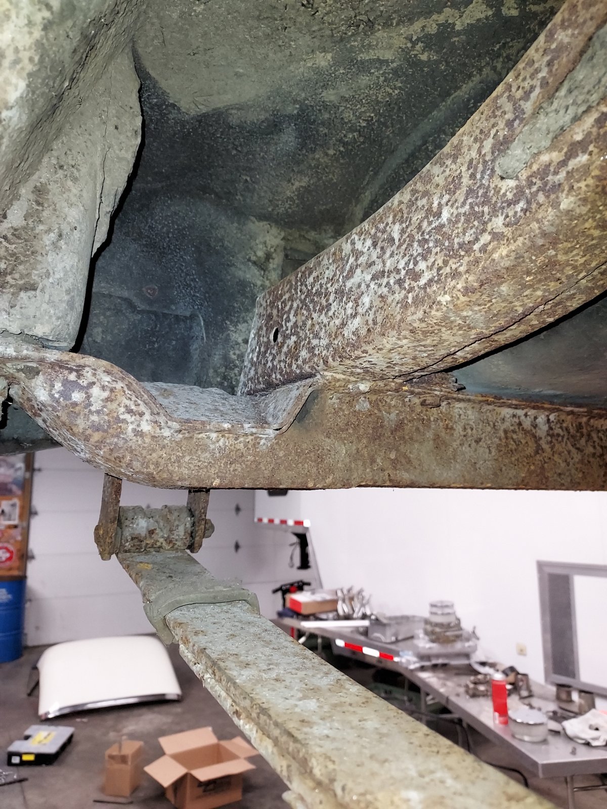

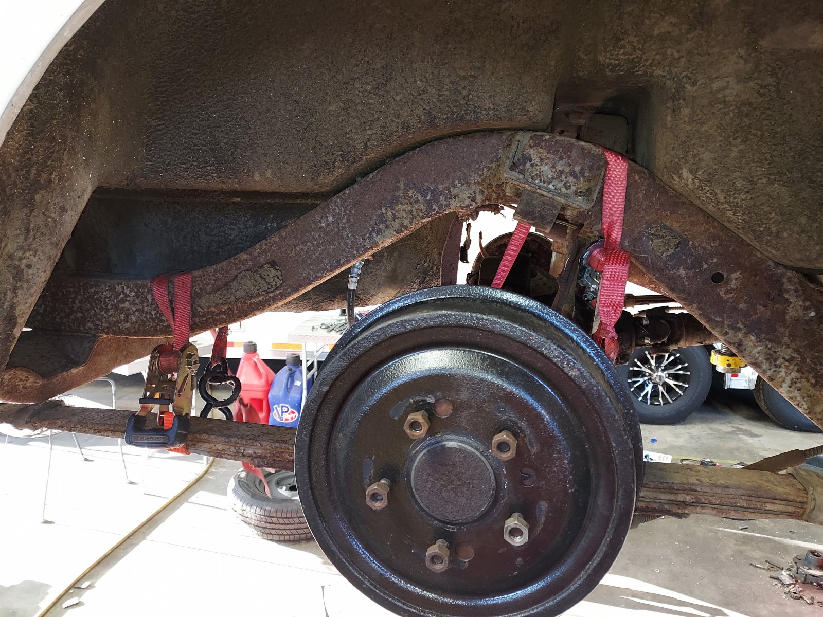

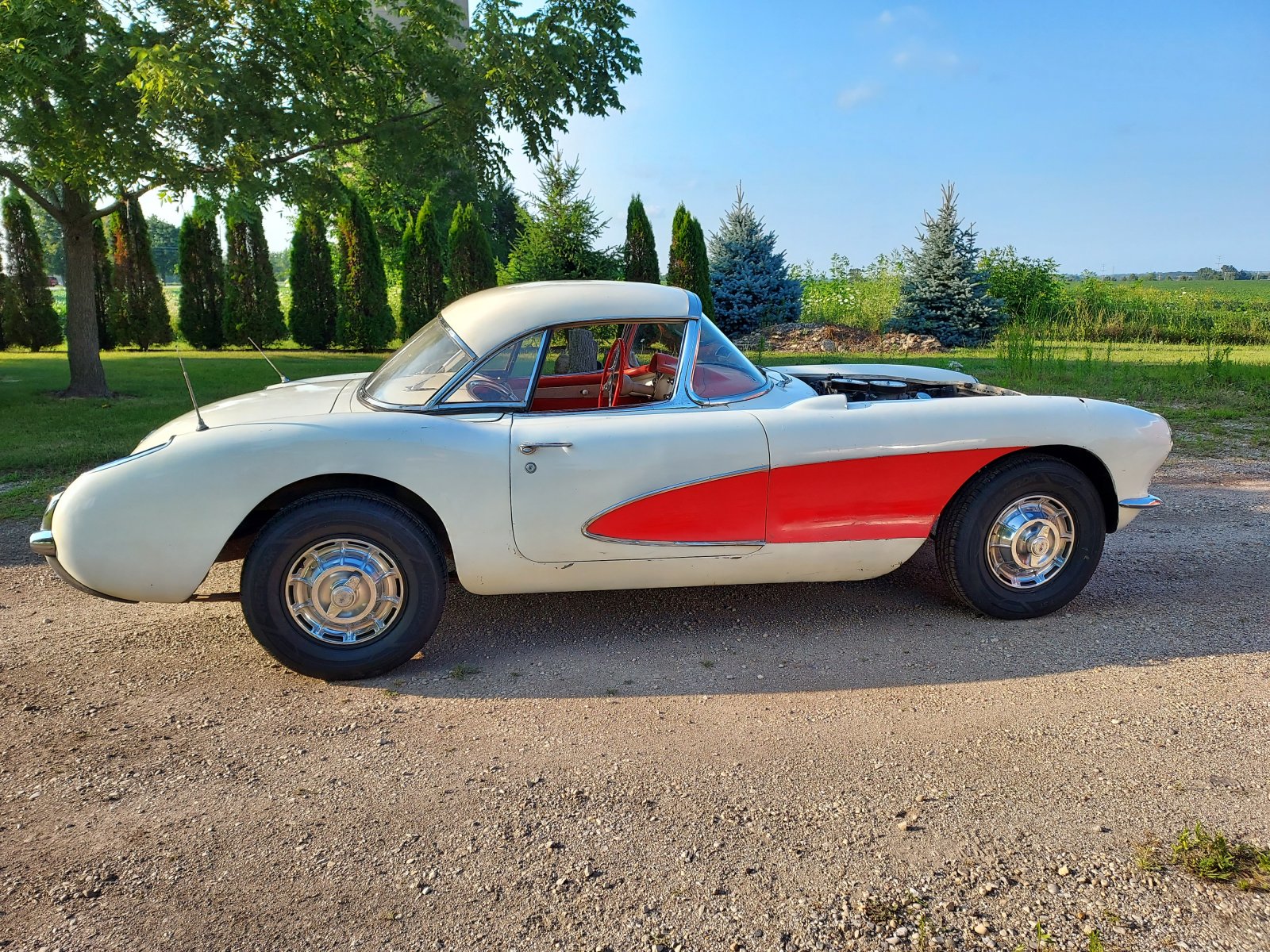

  13. 20210822_182820.jpg The rear end axle straps have me baffled. I have the correct 57 length. I measured it. I have the car on the lift with two screw jacks under the rear end with the full weight of the car on them. I have ratchet straps from the frame to the rear end pulling it up as far as it will go. Even with all of this pulling the straps are not close to lining up the pre drilled rivet holes. I can get it through the loop but its still several inches short. Does anyone have any ideas?
    The front spring mount looks original. Could the rear shackles be incorrect and too long? If so what is the stock length center to center?
    Or maybe the rear springs are wrong. Something is screwed up. View attachment 5150086 View attachment 5150086 View attachment 5150086

    Did someone flip the shackles and put the rear of the spring below the rear crossmember? longer shackle would lower it...
  16. I wonder if the springs are wrong do to how high the car sits. It looks high in the back to me. 20210801_180952.jpg

    are the shackles flipped??

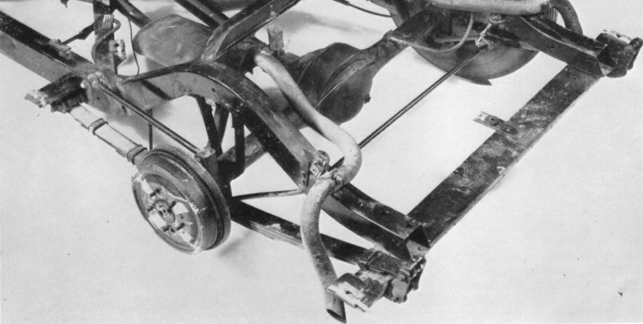

  18. What year is the ch***is in the pic? I dont have the bars running parallel to the springs. I need to look at the pic on a computer and not my phone to see the shackle detail.

    that is a 61, but the shackles should be the same

    looks high to me, but mine has 2 inch lowering blocks....

    It looks like the shackles are flipped!

  23. Thanks guys for all of the great advice. The shackles are flipped. I would ***ume the spring goes over the cross member. Thats going to drop the car a lot.
    Once again the power of the hamb. I had to go out to the car and look so i can sleep tonight. 20210822_212412.jpg 20210822_212452.jpg

    I'm kinda' diggin' the stance as it is. Personally, I would leave everything the way it is and say "To Hell" with the limiting straps. But I also understand wanting to put everything back to the way it's supposed to be. JMO.
  25. I like a little rake but to me this looks funny. Theres way too much room between the top of the tire and the opening to the fender. I will flip it then push it outside for a good look.

    I would never be one to say make it stock, because there are far too many stockers already. but it will look and handle a ton better once you get the back down

  27. being a mopar guy thats used to shackles hanging down it never occured to me that they should be mounted pointing up. when i first got the car it crossed my mind that there was something funny going on. the car sat high and the shackles were visible from the back. i never paid attention to vettes but i never recalled seeing shackles hanging from them. i never gave it a second thought because i had so much else to do that was more important. it will give me something to do while i wait for more parts to arrive.

    May have been done to compensate for weak rear springs?
