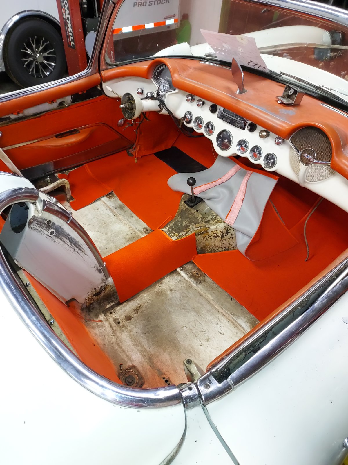

    Your transmission tunnel piece is backwards in this picture. The flaps go below and alongside the center glove box.
  6. Thanks for the tip.

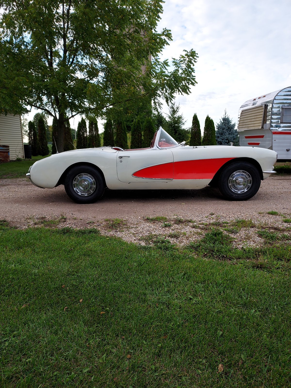

  13. There are several good suggestions to fix the stripped out holes. I have a few sill plate holes and all four holes that hold the plate around the shift handle. Nothing will show.
    As far as the frame goes it looks nasty but its actually verr solid.

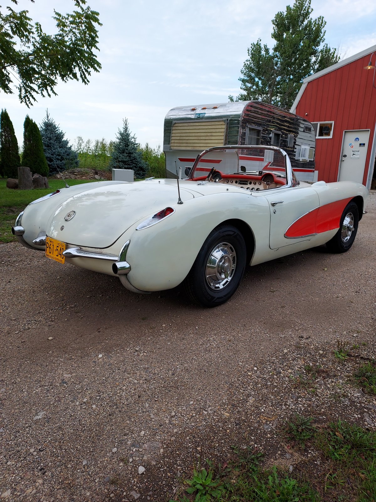

  14. Todays fun involved flipping the shackles. Silly me thought i could just unbolt the shackles and somehow get the spring over the frame. That idea didnt work. In the high heat and humidity i kept going. The springs needed to be completely unbolted. With the car on the lift and a pair of screw jacks for support the job is mostly done. New shackles and bushings are on the way. I will switch them out when they arrive. The car looks much better. The rear of the car dropped several inches. It sits level. It was cool to see all the bolts were original. I cleaned them up and re installed them all but one that broke.
    I found out the car was bought originally in northern Illinois. It raced at dragstrips in the area. That would explain the stance and old eelco fuel block. 20210825_183131.jpg 20210825_183150.jpg 20210825_183215.jpg 20210825_183230.jpg

    Much better.... I bet the limit straps fit now too

  18. I need to see if the straps fit while its on the ground. On the lift with the rear end supported they didnt.
    I couldnt get the exact dealership. I can ask more question when i see him next.
  19. Is this the original stance? The car looks higher in the front now. Should it be level? Or is it just how the body is shaped that it looks like that?

  20. 20210825_192901.jpg The straps fit with the full weight on the tires.

  21. DFH-GMC
    Joined: Dec 24, 2011
    Posts: 139
    DFH-GMC
    from Texas
    0591B712-4638-472F-8D22-7C28035FF446.jpeg This is how mine sits without engine or trans.
    Yours looks good
    WC145, bowie, catdad49 and 4 others like this.

  25. Dick Stevens
    Joined: Aug 7, 2012
    Posts: 4,248
    Dick Stevens
    Looks level to me, you have to look at the bottom of the body, not the curved tops of the fenders and quarter panels.
