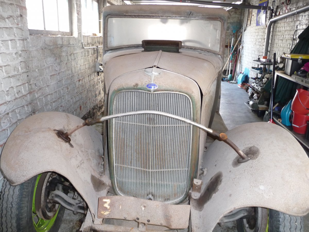

  1. You said you were going to restore it. I don't know about the European deuce but with the American version, if it doesn't have a V8 emblem on the headlight bar then it came with a 4 cylinder. So if you do restore it, shouldn't you use a 4 cylinder instead of a V8?
  2. No idee for the moment
  3. You're right. It's a 4 cylinder car.
    With a small 123 c.i.
    The guy who bought it in 1976 (without engine) wanted to put a flathead v8 in it.
    Not for customize, but to have more h.p.
    I decided to continue this way.

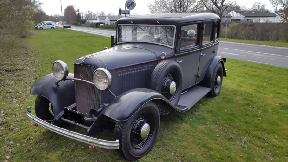

    Here is one currently for sale in France.I pulled the pic off the ad.Not mine.

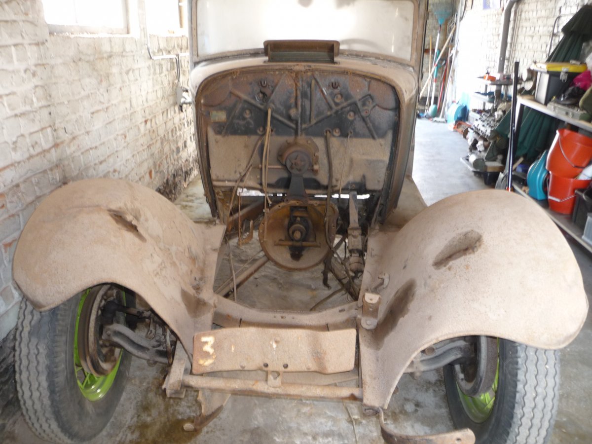

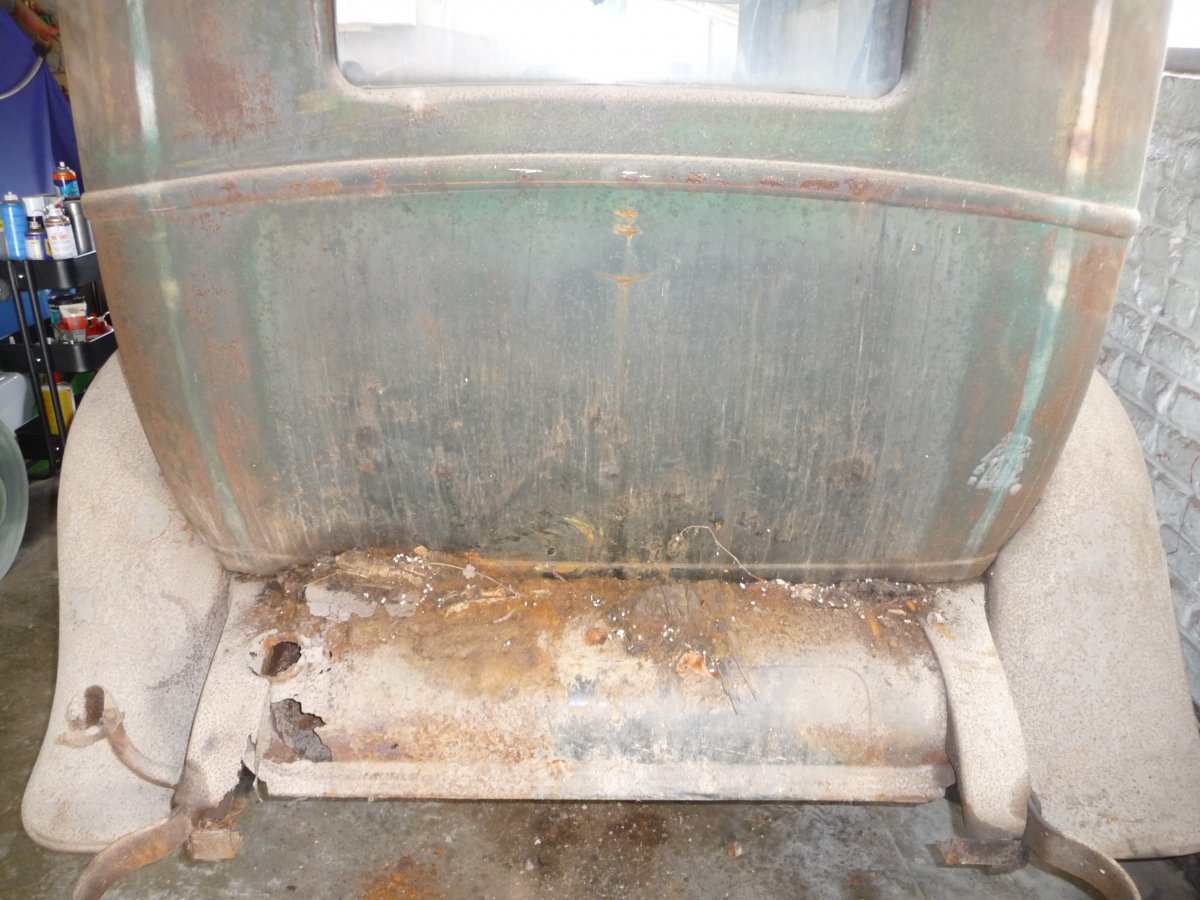

    Don't know how restore the 4 doors body for the moment.

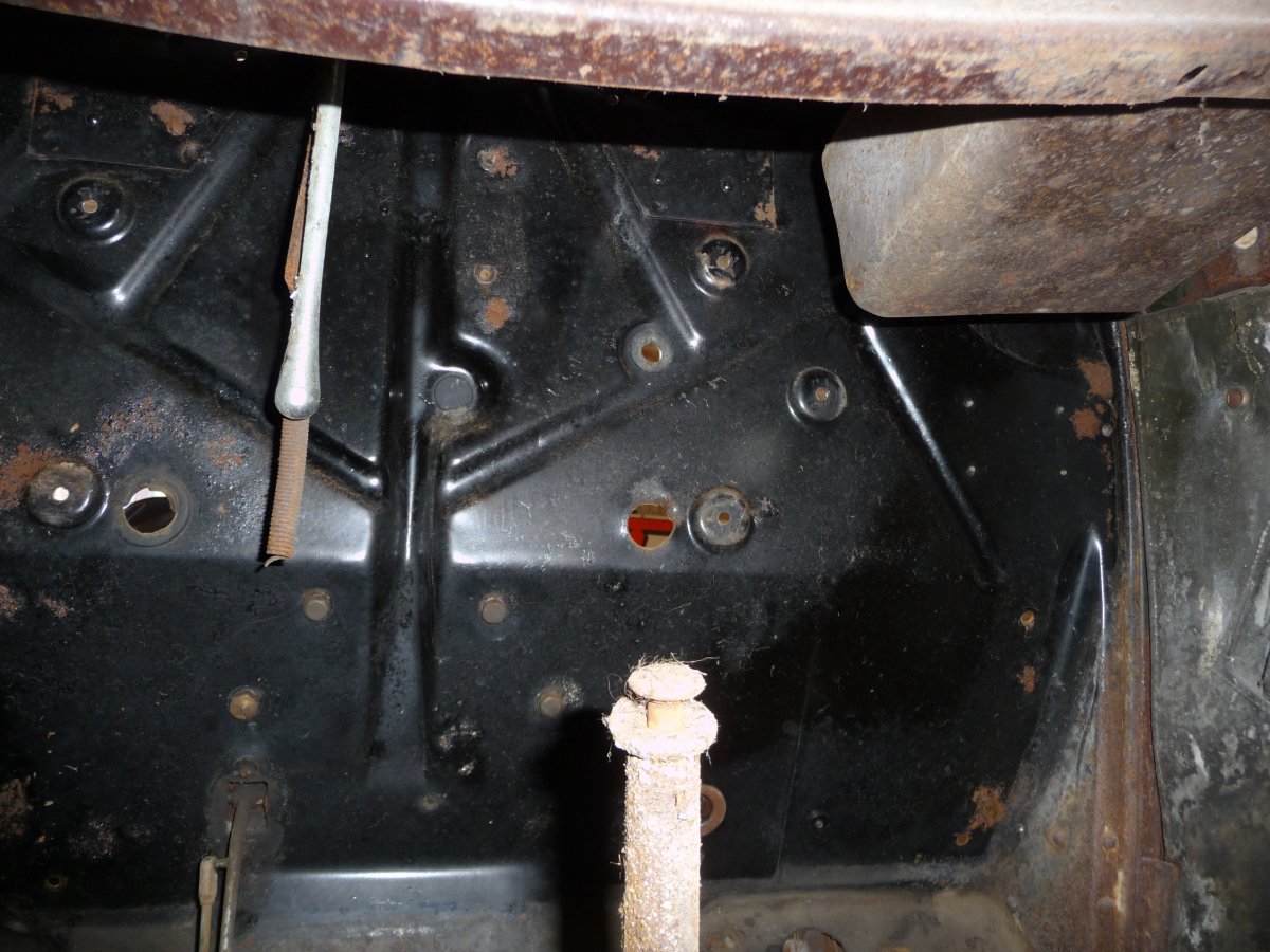

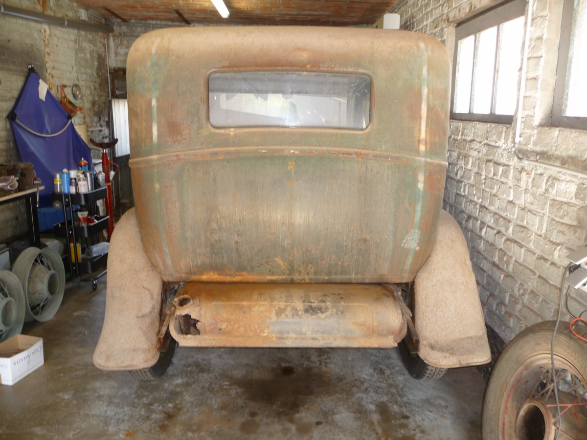

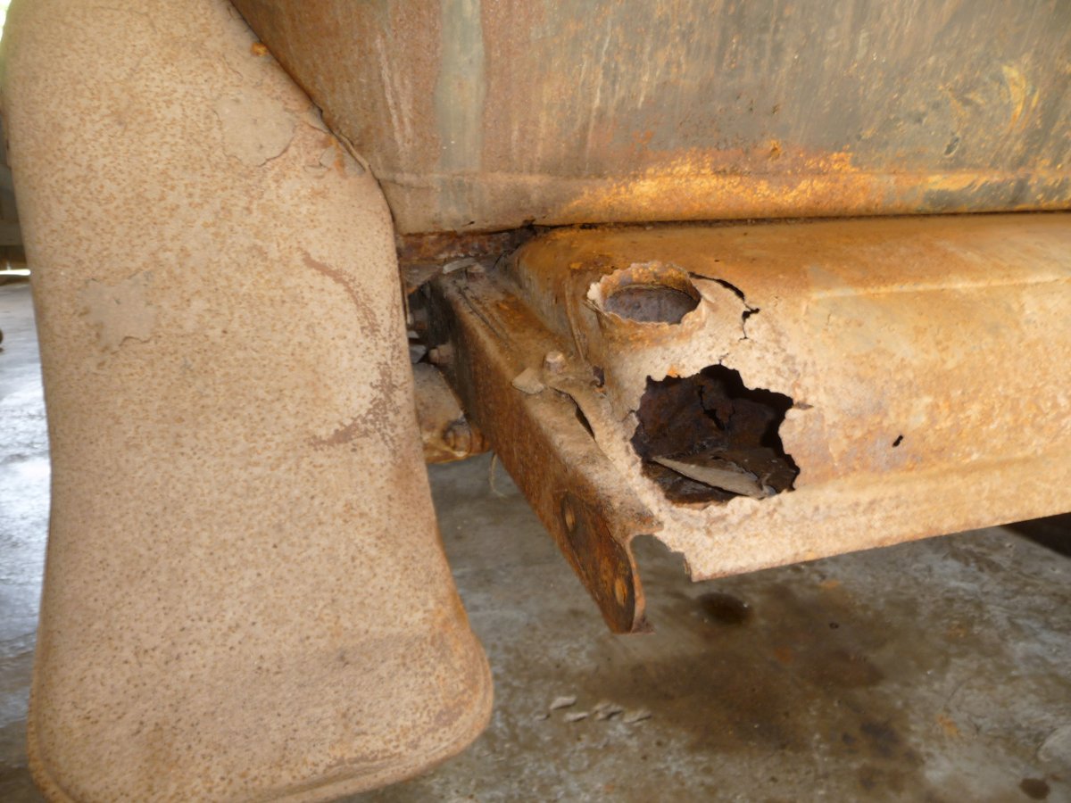

    It looks nice, but I need to remove the body to look carefully under the floor.

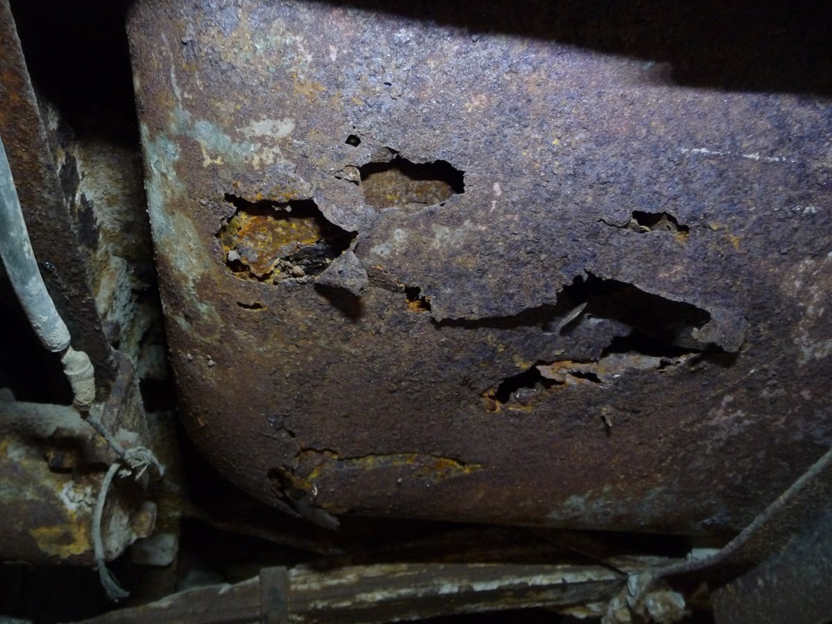

    For example, the fuel tank is so rusty I can put my hand through it !

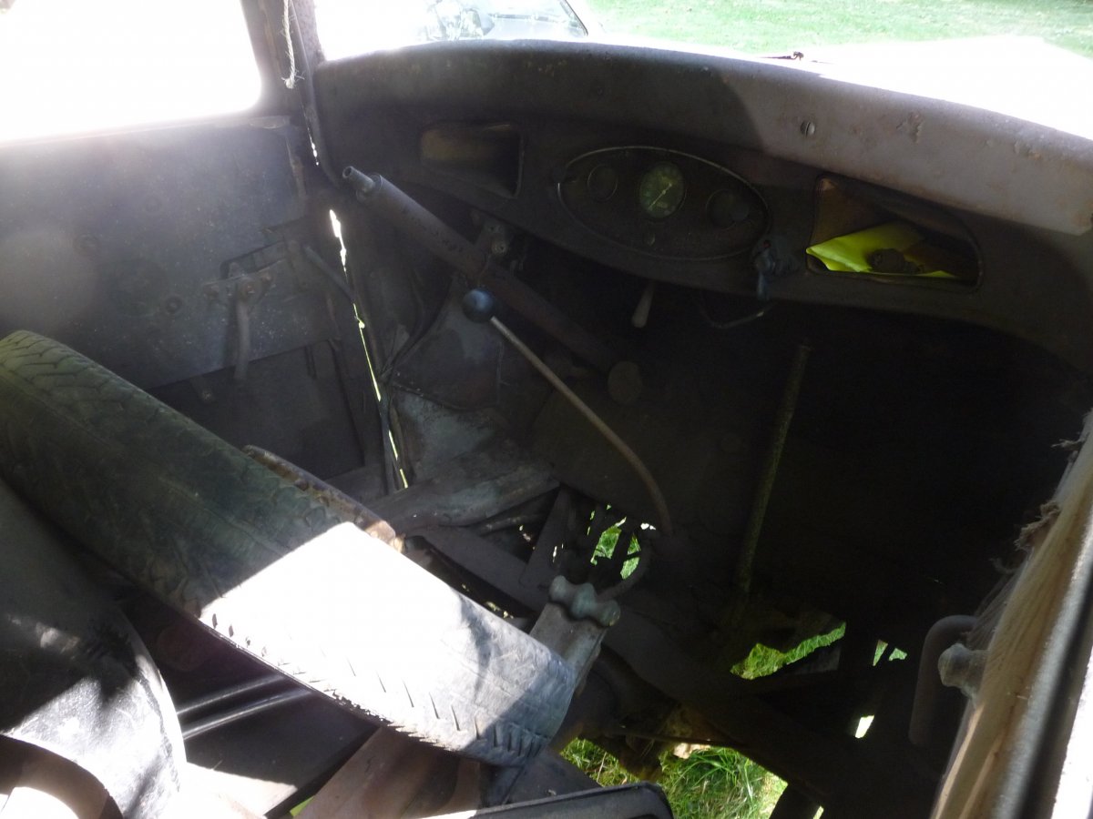

    The interior is in bad shape. Squirrels made their nest in it.
    I found some nuts under the rear bench...
